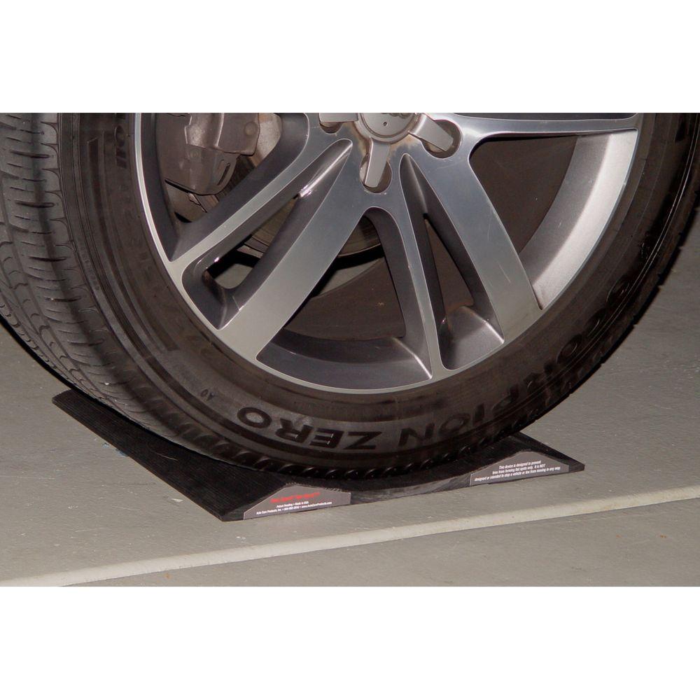

If you want to completely remove flat spotting, try these (see link below) from Home-depot in your garage and that should eliminate 80% of the issues. It forces the load of the car to be spread evenly accorss the surface area of the tire.
Link:
https://www.homedepot.com/p/Park-Sma...E&gclsrc=aw.ds

Thank you for your feedback, do you got flat spot just to seat the car overnight ?
I will try the tire saver and let you know the results. Hope will fix this nightmare.

Edit: I just went up the thread chain and saw W222's tire savers. That might be a good solution for you.

Tire savers?? LMFAO! A car should be able to sit without any of these issues. Tires savers!! LOL!!

Yes, why not!!!? The guy said he is very sensitive to the least amount of vibration, and tire spotting is a very known problem of almost any tire when car sets for an extended period of time, so why not to use it if he doesn't want to feel any sort of vibration later after days of car being garaged? People are using it when they store their cars, but there is no reason why to not use it when car is garaged for days if the owner doesn't want to feel the vibration the next day he drives it! Do you understand the physics of how tire saver works? and how they distribute pressure over the surface area??

Yes, I do believe the distribution I understand. I just think it's odd and sort of like a snake oil. I had many cars over the years, which were parked for a week at a time, or longer.....never any issue like this..........I had Pcars lose charge in the battery, but never a tire issue due to sitting without a tire thing mentioned here. Of course this is just my story, I know we all have different ones

You are right, but that could be just you not feeling the vibration while others would have felt it. On almost every single car I have today, and had in the past, ALL of them shows vibration after parking for 3-days plus. Every single time, I would feel the vibration, and my wife would always tall me "no I don't feel any vibration at all". So it's just a matter of how sensitive you are to the very least amount of vibration. I bet your car vibrates after it sets for days, but it's just you who is not as sensitive to vibration as the OP or me in this case. This vibration is really very very minimal and you'd only notice it if you have perfect road conditions around that doesn't mix road vibration with tires vibration.
