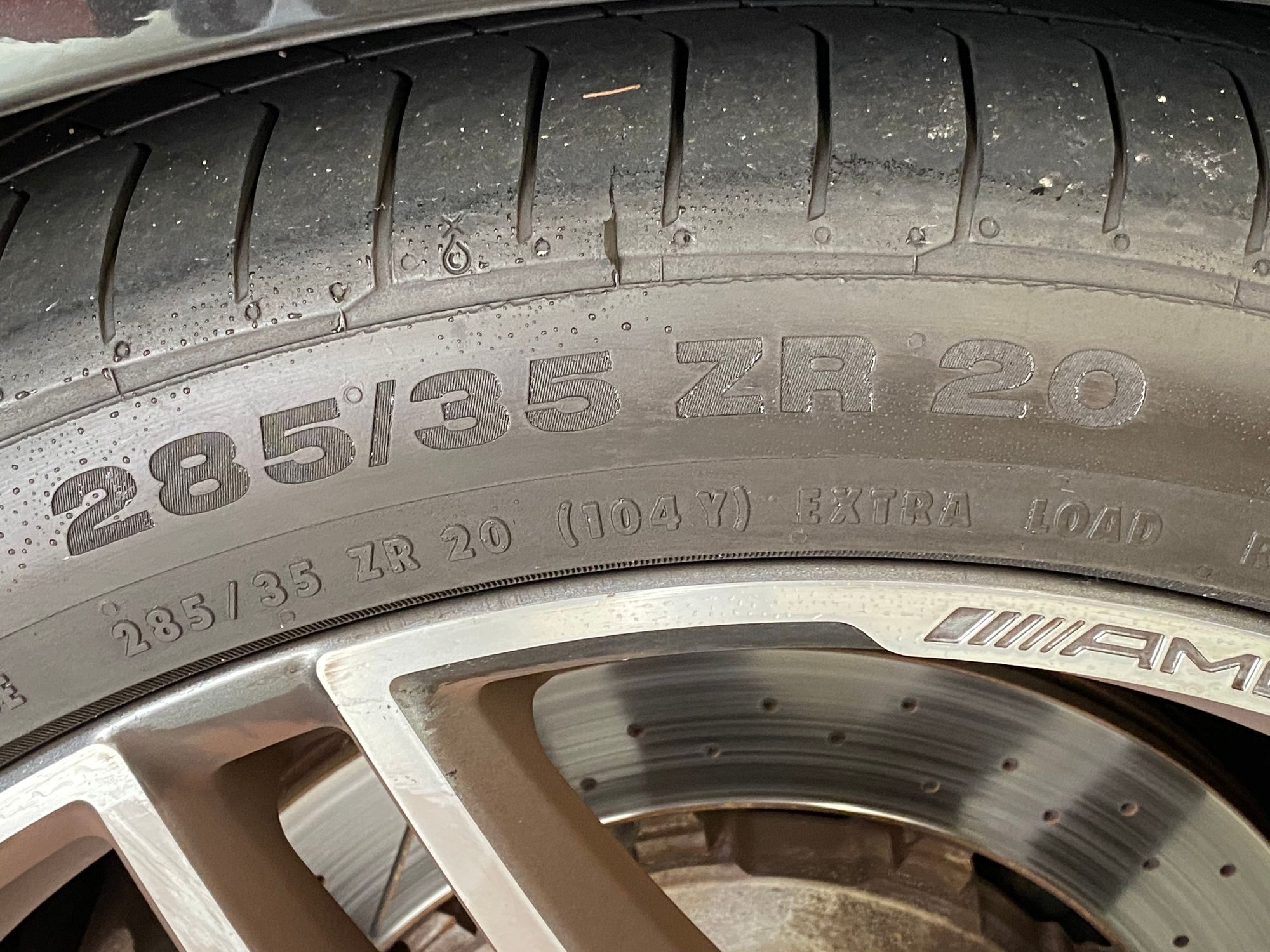

Jan 5, 2021 | 04:27 PM
Just for amusement, here is the sidewall info on the OE tires on mine.
