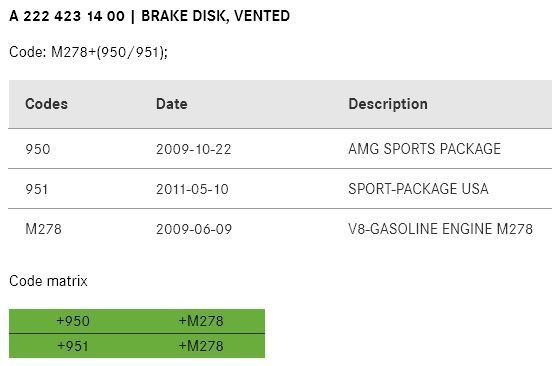

Pretty confusing. I just scanned RockAuto's catalog, and every rear rotor that has dimensions shows 340mm dia, with AMG/sport or otherwise.
They do make a distinction between drilled and non-drilled and that may explain why the Mercedes catalog has three different number for S550 sedans: 222-423-13-00 for "without AMG pkg", 222-423-14-00 for "with AMG pkg without HD" and 222-423-15-00 for "with AMG pkg with HD". When I searched using my VIN, I got all three numbers again!
Gets annoying having to triangulate between multiple sources this way doesn't it?

Cross reference current MB part # 2224231400 to shop.
Thank you. I googled that part# and on 10 different sites it does not state if it is a 340 or 360mm anywhere?

I have a 2014 Sport, here are the exact parts you need. P.S. FCP will replace at NO CHARGE, ANY TIME you want new parts. No questions asked. Just keep your receipt.
Don't take my word, just call them. They WILL even take back Used Brake Fluid, Used Oil and give you new FREE.... Wipers etc.... Anything ....
FROM FCP:
Front :Mercedes Brake Disc - Genuine Mercedes 2224200272 02 $422.48
Rear: Mercedes Brake Disc - Genuine Mercedes 2224231400 02 $387.52
