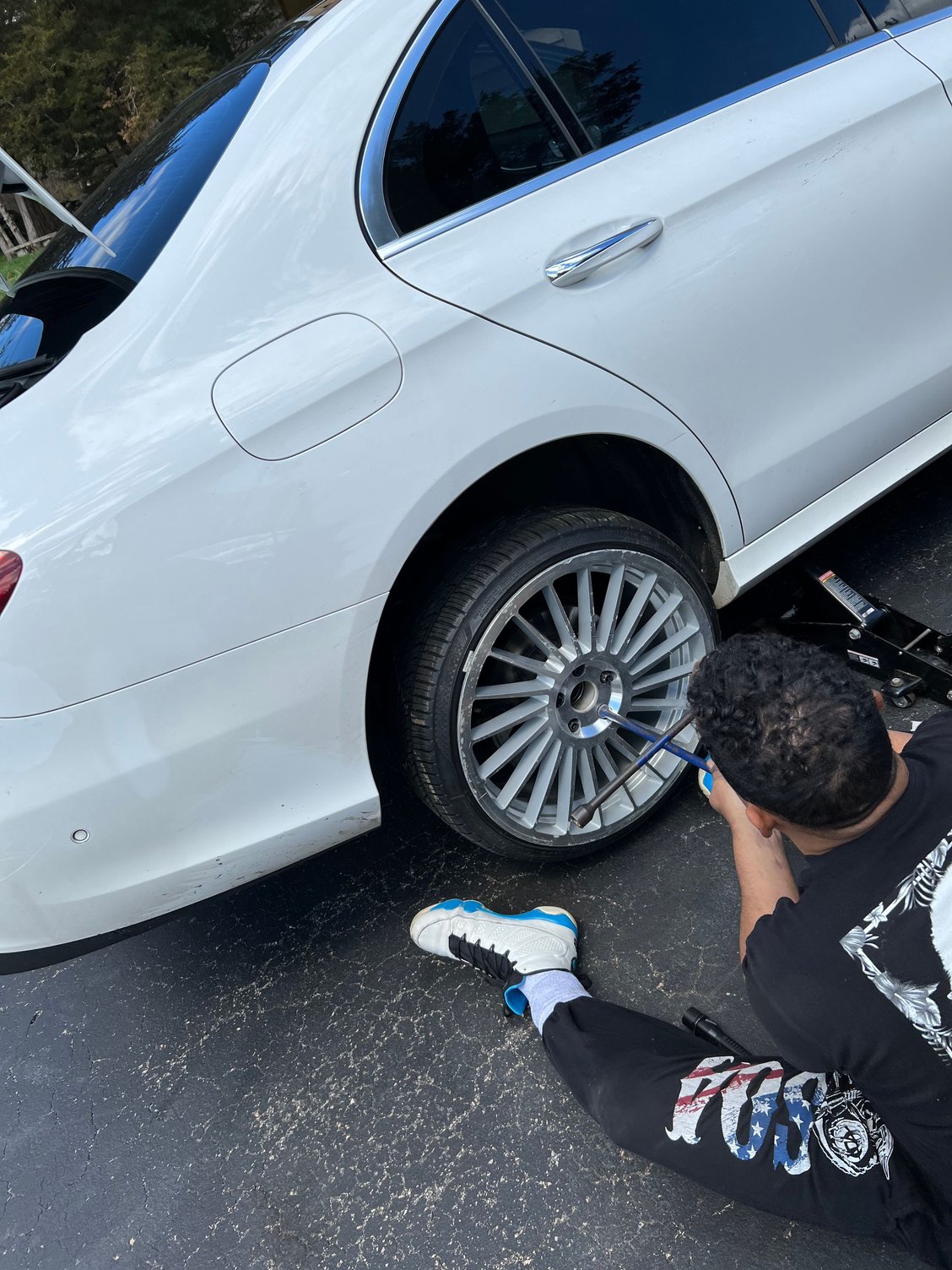

I tried throwing 20” rims on my 2018 e300 but lug nuts where to short , whats a good set out there ?
Oem lug nuts are short don’t go in , whats a good set of lug nut for 20” rims

Those obviously are not OEM Benz rims. Are you using spacers? If not, I'd ask the wheel mfr for the proper size bolts.
What I've noticed about aftermarket wheels is that the lug bolts that come with them are usually short because the wheels aren't as thick where the wheels mount to the car. Perhaps you're installing the lug bolts that came with the aftermarket wheels or from a different set? The OEM bolts have an over all length of 67 mm, while the length from bottom of the conical ball to the end is 45 mm. Perhaps you should measure the bolts you have to see if they are even the OEM bolts.
