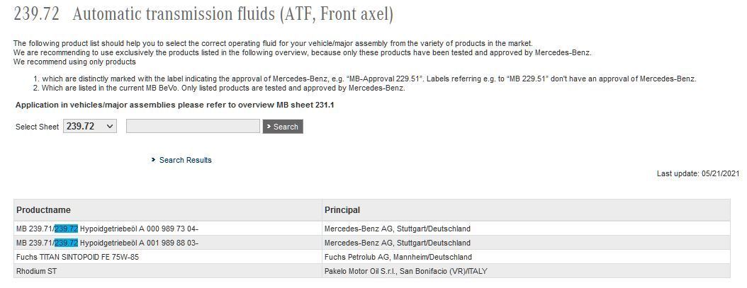

See attachment for future reference.
Is there a Front Diff for 4MATIC? If so, can you supply the doc? I would like to Vemo you $5- for every doc I need, or send you and Amazon gift card. I really appreciate what you provide to all the forum members. So in general, can we " Donate " to you Amazon Gift Cards or Vemo Funds... ?
Thanks!

See attachments.
File Type: pdf
