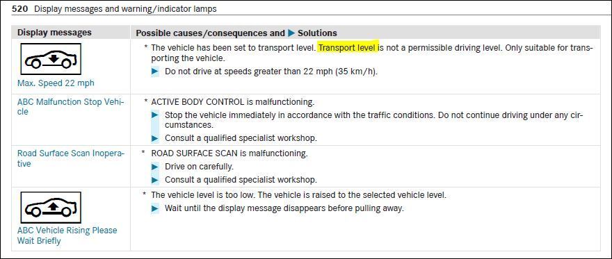

Hi All,
I am trying to find a solution to increase the max height my 2020 S350 can be raised when using the raise button. the reason for this is my front bumper lip scrapes badly when entering or exiting my garage space.
The module from lowered benz claims to do this but due to sanctions I am unable to order one from Belarus nor am I convinced the module can in fact increase the max height the car (+40mm claims the seller). I asked my local Renntech dealer and
he wasnt sure as no one had ever asked him this question before.
I do not wish to alter the standard ride height at all, its fine as is.
In my case, contrary to the entire internet, I do not want to lower my car, only raise it an extra 20mm when using the raise button for the reason above.
Is there a way i can do this without voiding my warranty? Car is a 2020 so still under factory warranty.

Try 'Transport Level' MBUSA 2020 OM:
https://mbworld.org/forums/s-class-w...port-mode.html
this is exactly what i was after. I asked the dealership about transport mode and they said it will only lift using the standard raise function. Thank you for responding to my question with the right answer!
Is this supported on the 2014? W222 s550 4-Matic
Old Apr 23, 2022 | 05:41 AM
Steve099's Avatar
Joined: Apr 2022
Posts: 15
Likes: 8
S350 Edition S AMG Line
In the other thread someone said it did not work for their MY14. I have not yet tried on my MY20 yet as its in for repair after a run in with a massive pothole last weekend
Konigstiger, can you confirm Year that this was offered? Thanks I would be interested so I can drive up on 4 ramps to do Checking and Oil Changes underneath.

2018. Membership FYI search OM PDF for "transport".

Thanks again for this, its working quite well for my situation. its a bit slow to go back down but i am working on that process so i can cut the time spent waiting.
