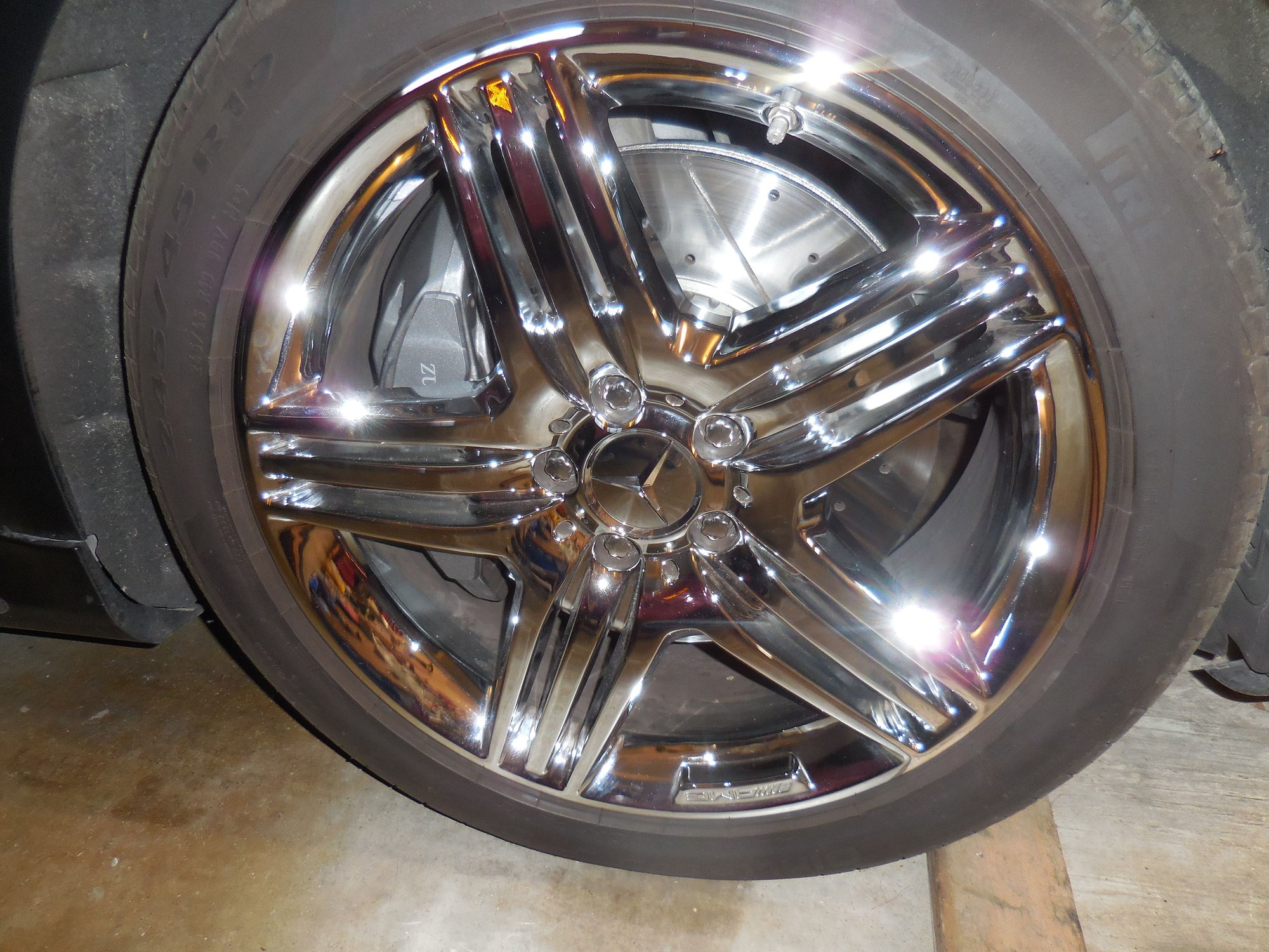

I did my fronts back in the spring. The pads measured 5 - 8 mm, with a min spec of 3 to replace, but the rotors had huge lips and were overdue. The carfax showed the front and rear were done by the previous owner at 21,690 and I did my fronts at 44,600, so it seems plausible that our cars do need frequent replacement.
As others pointed out, replacing pads and rotors is one of the easiest things to do on a car. Most of the time and effort is getting the car safely lifted and supported and then thoroughly cleaning everything.
Like oil and tires, everyone has their favorite brake parts. I put in EBC Redstuff pads, which, among other things, have what they call a "break-in" coating that polishes the rotor surface, an interesting effect as shown below. So far, I like these very well and believe their claims of less dust. The EBC's are perfectly smooth and quiet in use and have a pleasingly stronger initial bite than the old ones I took out.
