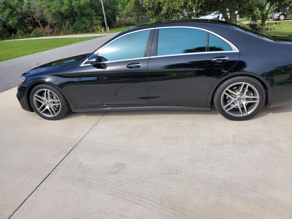

The wheels look great and are the 19s, hopefully I can get it sorted before the end of the month, but it doesn't look like it at this point.
