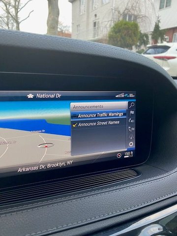

How to close traffic alerts
I did everything but can’t close or volume down “traffic ahead” warning !! It’s really not sounds good when driving with my clients on silent

I think there is an option in navigation menu that you have to uncheck for traffic alerts.

acctually no there option fir close navigation alerts but its not makes sense still getting

I don't know what you mean by closing traffic events. As said above, there's a setting in the navigation settings called "Announce traffic events" or something like that. Uncheck it and it won't announce them anymore. If you just wanna lower the volume, then just use the volume control on the steering wheel during an announcement. The volume controls are context sensitive. They control the volume of whatever is currently playing. There are different volume levels for entertainment, announcements etc. and you control those via the normal volume controls whenever the respective source is playing. So if the announcement is really loud, then just turn it down while it is announcing a traffic event. It'll remember the volume level for the next time.

thank you but believe me i did that it’s unmarked but still getting that alert

That's what I did to shut off alerts.

Yeap exactly i did same plus close volume for navigation but still periodically she says trafic ahead

I don't know why but lately my car started to do the same thing ( traffic alerts ) even though my option is unchecked and voice guidance is off. Hmmm..

exactly my friend that’s i m searching nothing checked but still continue to say trafic event ahead
