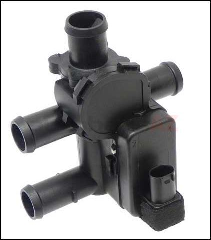

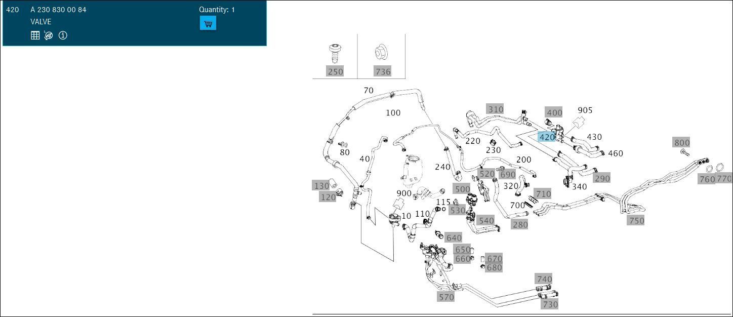

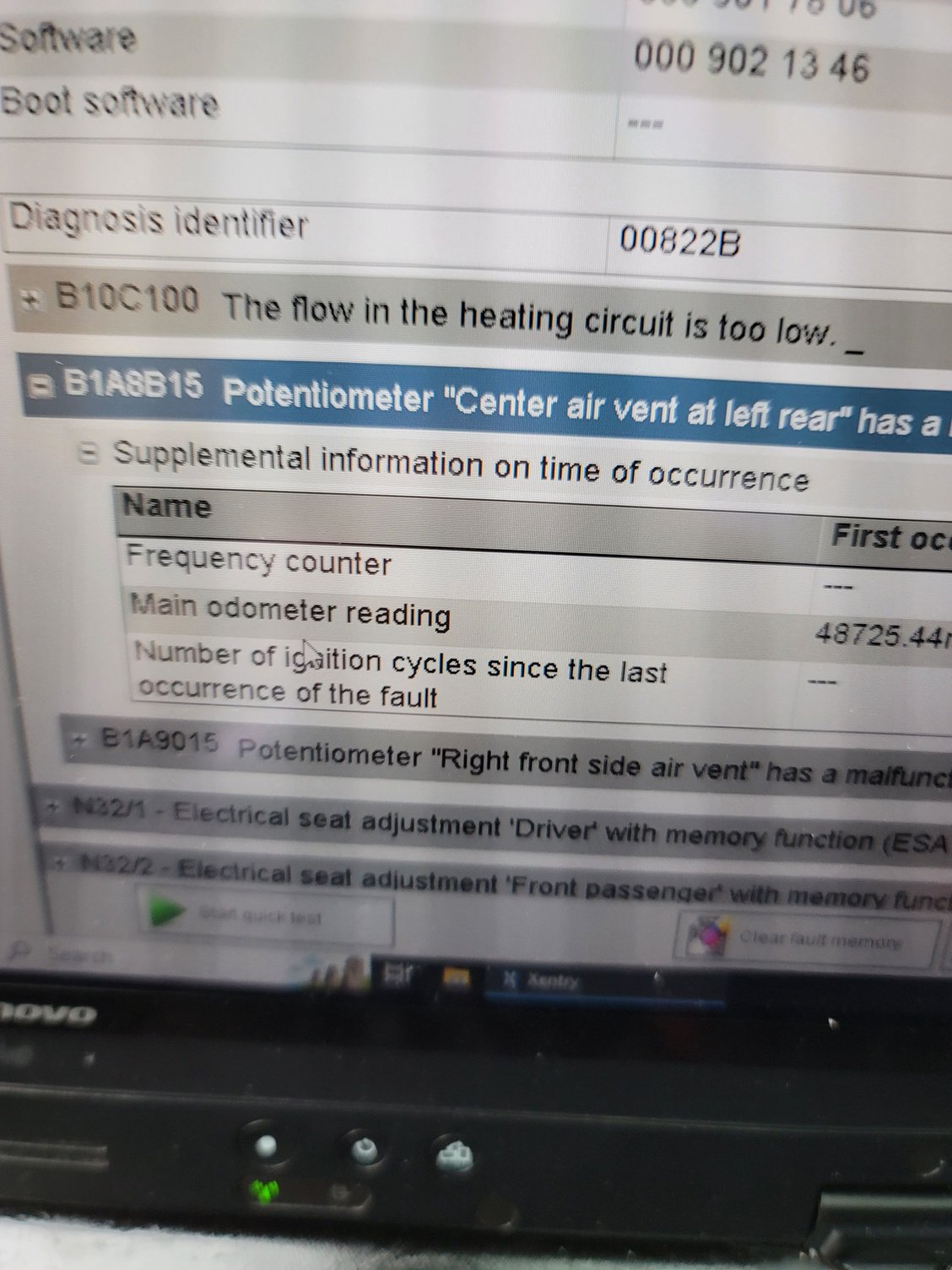

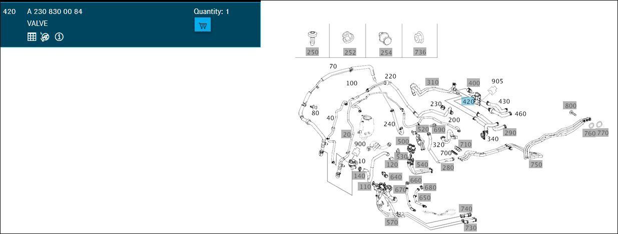

Code B10C100 The Flow in The Heating Circuit Is Too Low
I have 2 peteniometers that are shot, I understand that.
Can someone tell me what the above code (B10C100) means?
Control valve maybe?
Old Jan 13, 2023 | 10:47 AM
konigstiger's Avatar
Posts: 15,901
Likes: 4,632
From: North Scottsdale, AZ
'71 Pinto
First step, check heater control valve.

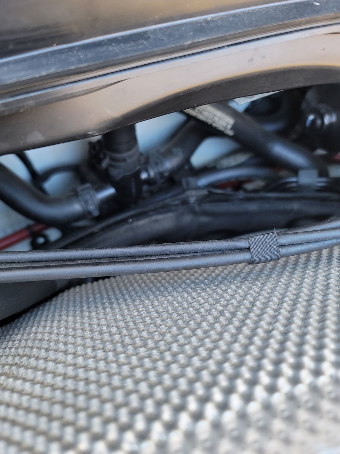

2019 W222 S560 4Matic/2025 Yukon Denali
2 hours.
did not remove the wipers.
Pain the the butt, but the heat is nice and warm.

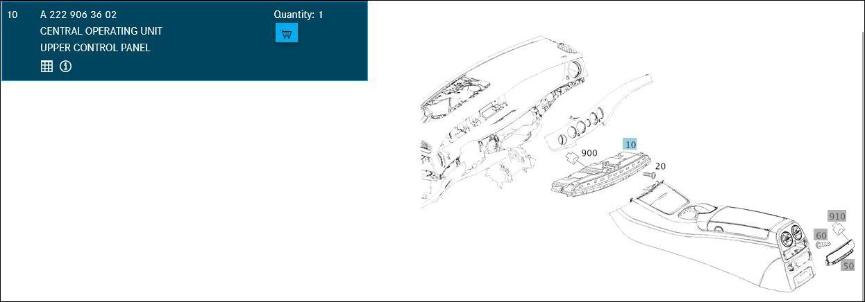

Need to have it checked under warranty (or out) could be sensor(s), stepper motor(s), operating unit, etc. pulling codes using Xentry (MB diagnostics).

Run Xentry diagnostics, it will tell you exactly what the issues is.

Ran Xentry, no codes for this.
fixed.

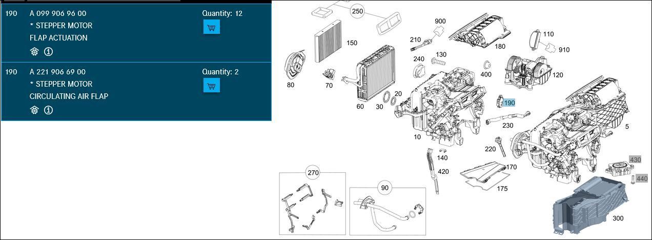

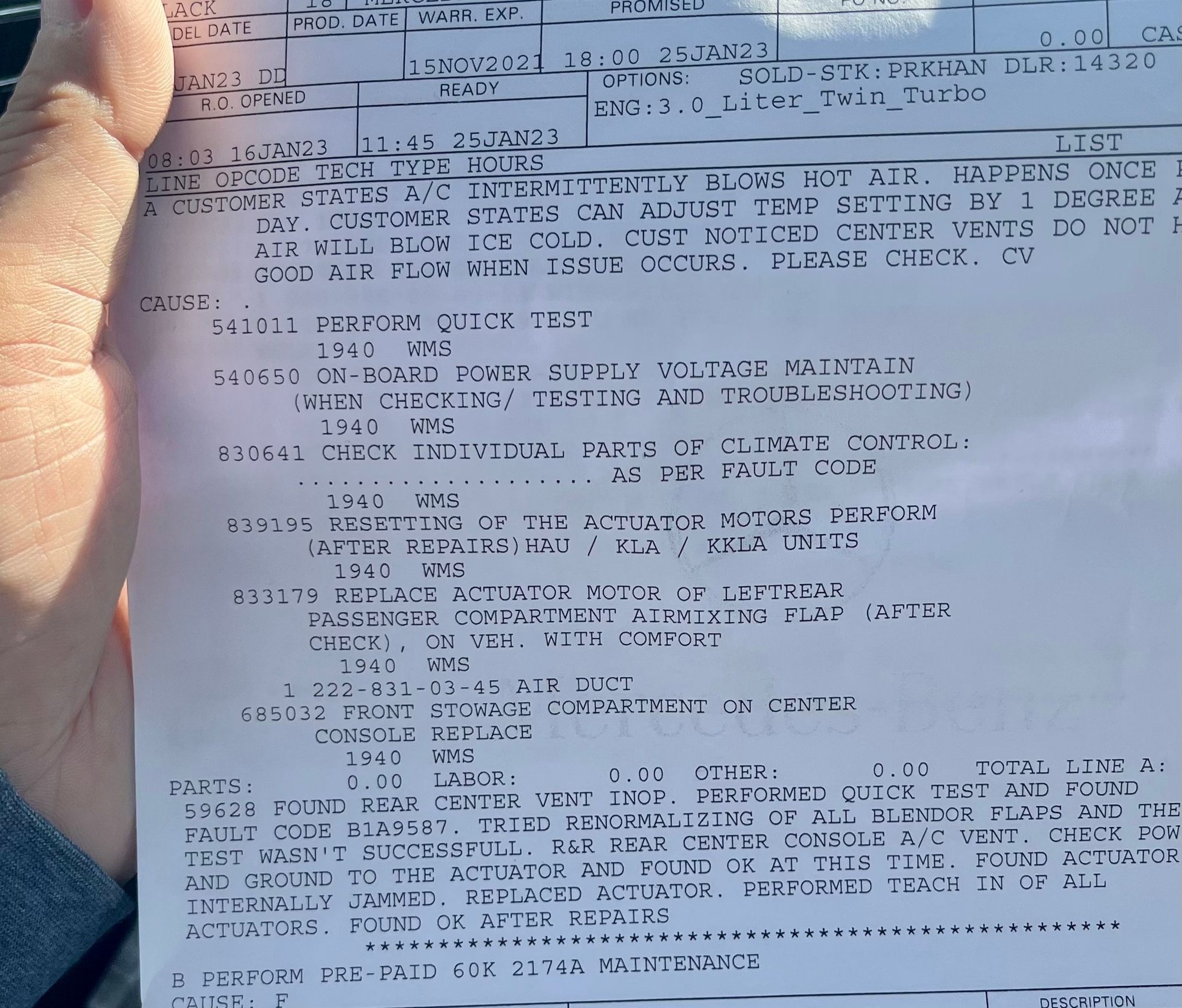

codes indicated a problem with “blend doors”.
Old Jan 18, 2023 | 10:15 PM
vinflouen's Avatar
Joined: Jan 2009
Posts: 566
Likes: 261
From: In The Woods
That’s a flapper motor thing in the dash.
Did they say which one?

apparently the rear one? They haven’t resolved the issue I described yet. They witnessed it but have not figured out why it’s happening. One week later and they still have my car!

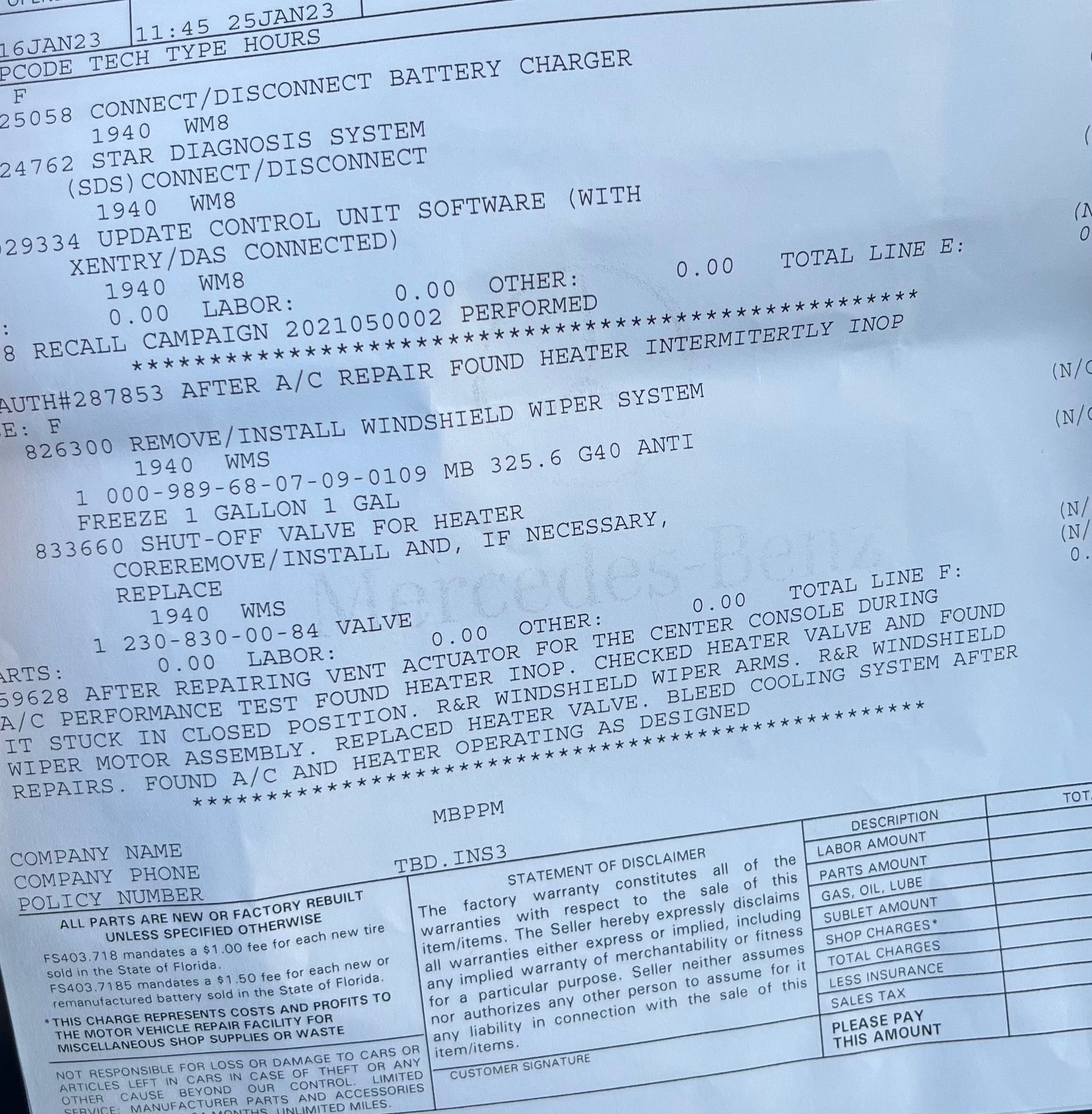

heater valve and rear blend door were replaced under warranty , so two issues resolved.

spoke too soon. Despite replacing parts same problem exists. Going back to dealer next week! How difficult can it be?

If they have not already done so (as documented on invoice) request: revisit valve/connections/harness (malfunction may not show fault code); Xentry check of all flap positions individually in succession, control unit, sun sensor. All contributing factors to temperature.
Old Jan 28, 2023 | 04:26 PM
Merserybenze's Avatar
Joined: Jan 2013
Posts: 304
Likes: 75
2022 AMG GT 53, 2020 Sl450. Did drive 2018 S450
this is what they did. Thx for posting the above.
