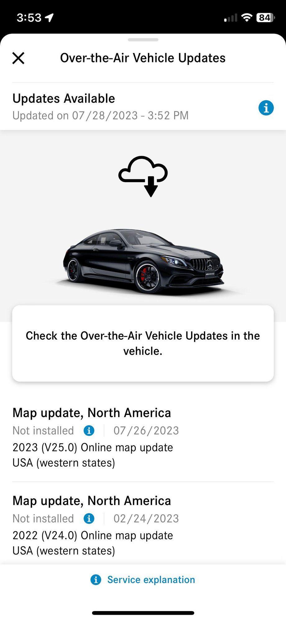

2019 C63CS
Looks like a somewhat older thread, but there have been several map updates since 2021. Updates come out about twice a year. Version 25 was just released in July. 2019+ model years have OTA updates for the maps, but only the home region gets updated automatically. To update the full map one has to manually download it from the web portal onto a USB stick or SD card. It installs fairly quickly if done that way. I usually do the manual update and preempt the OTA update so the last two OTA updates show as not installed in my case as they were superseded by the manual updates.

2019 C63CS
There have been two OTA updates for the communication module to make improvements. Did you get those? The one from 2021 also addressed a recall for the SOS system.

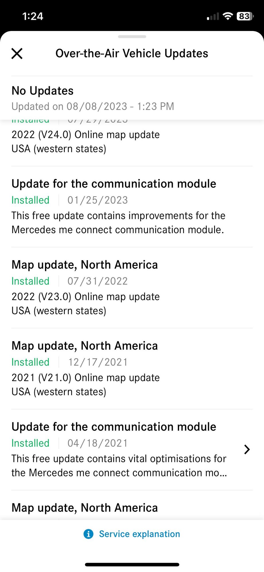

2020 S450 4Matic, 2022 GLS450 4Matic, 2015 C300
Yeah the dealership fried my SOS module when they tried to do it!
This is what I see in the app:

2019 C63CS
Yeah, your OTA updates are not working at all. I can see the history of updates all the way back to 2019 when I took delivery of the car.
