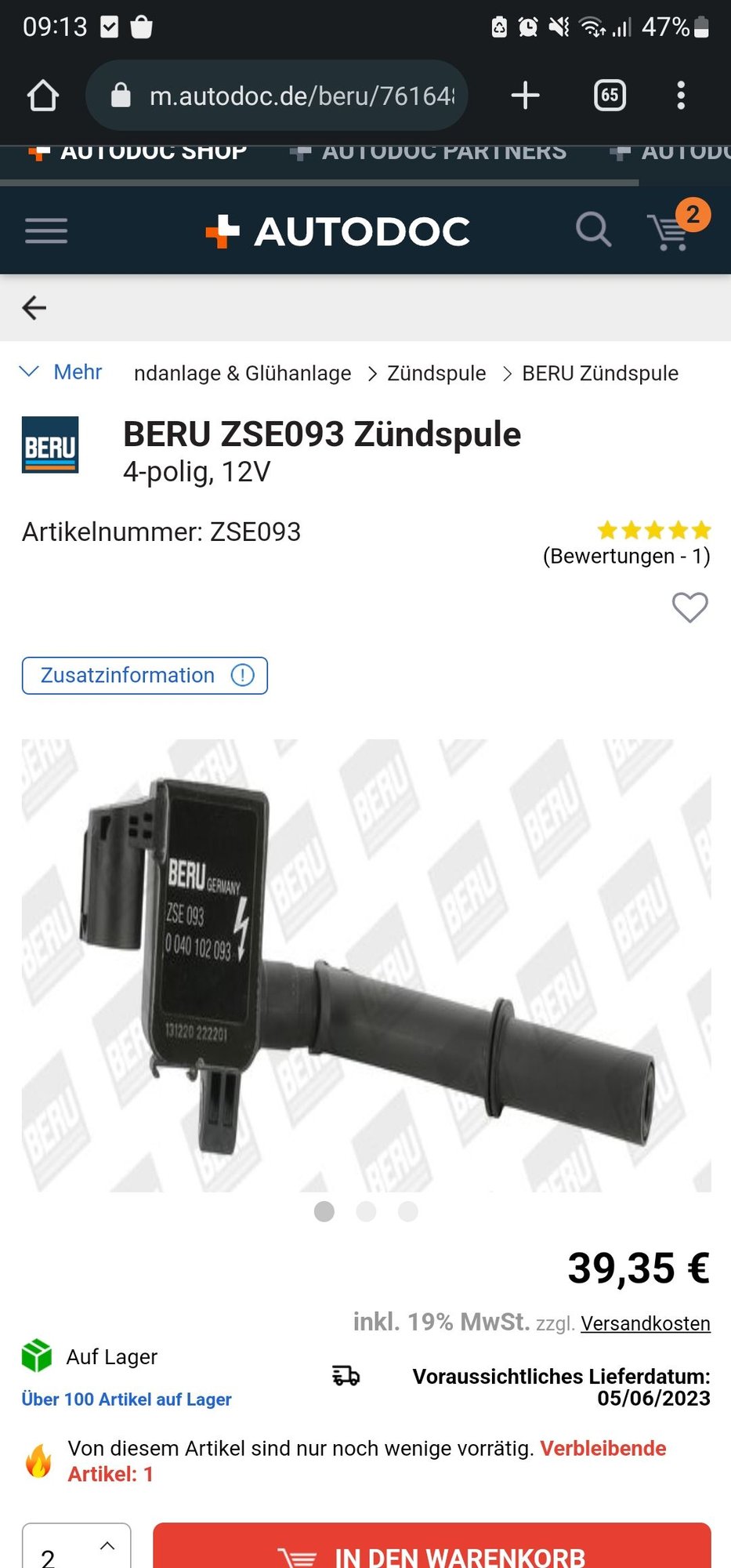

I
I was thinking of buying this one. The original is also from beru but the number is diffrent so I dont know if it is exactly the right one.
Buy from a MB dealer.
I really would. But MB dealer (all MB Germany) is out of stock for next 2 month
