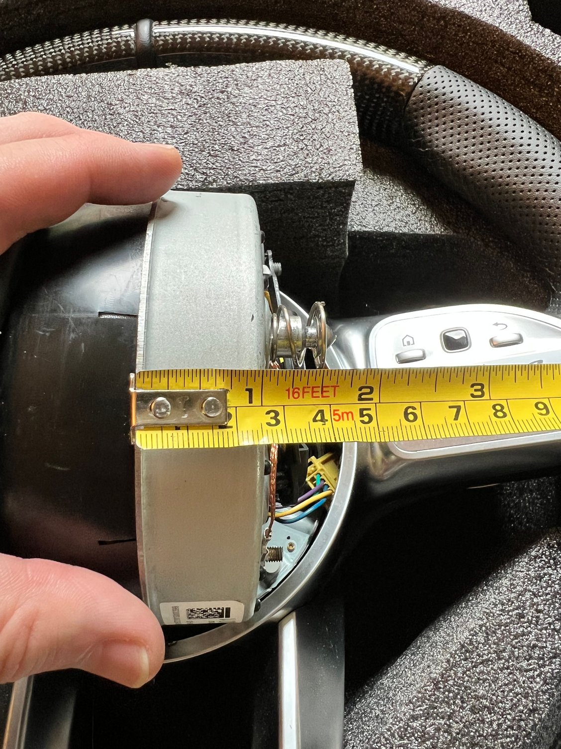

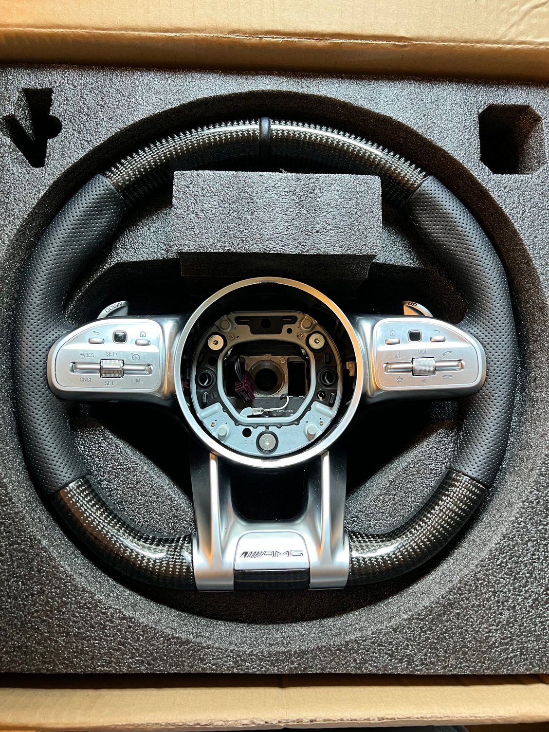

I paid $1375 for a replacement steering wheel that I could never use as the airbag did not fit. I sent him numerous emails and took it to two different professional installers wasting more money. He just kept saying there was nothing wrong with it. Obviously there is something VERY WRONG WITH IT. Never buy from him. He stole $1375 and more from me.

Pictures would help here. Many buy updated steering wheels failing to realize that new airbag purchases are also needed, especially when switching to an AMG design (varies by model). Was it a wrong airbag connector or physical fit?
The airbag was also purchased from CKM as a package deal with the steering wheel. The airbag shipped separately from another location. It was the physical fit of the airbag that was the problem. It connected electrically fine, but when the airbag was pressed into place it would only catch on the right side, leaving the left side unattached. If I could get it working I’d be so happy to have not wasted all that money. I’d even be willing to buy another airbag if I was sure it’d fit. Chris refused to send another airbag. I’ll send pics. The steering wheel has been in a box for more than a year.

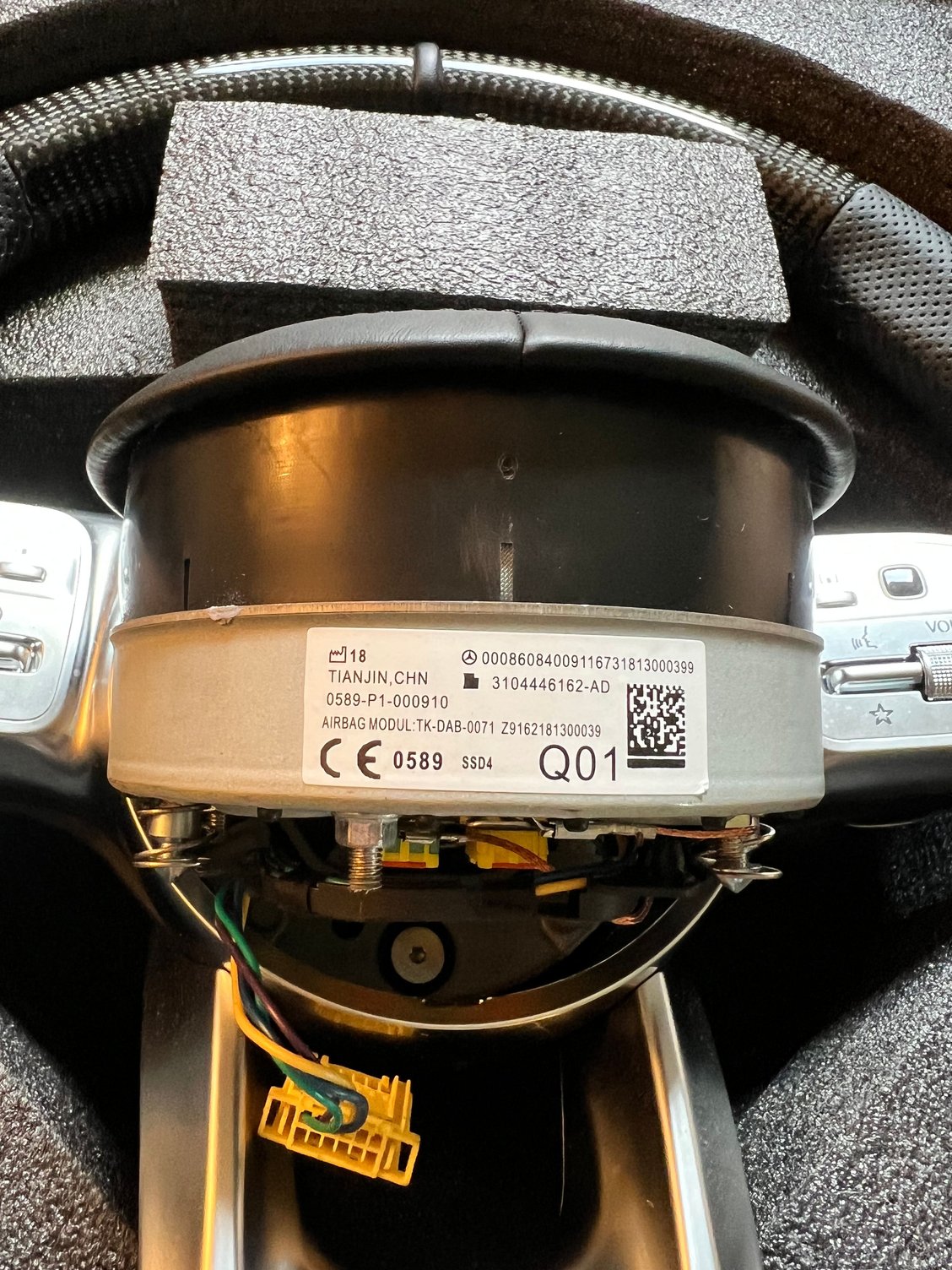

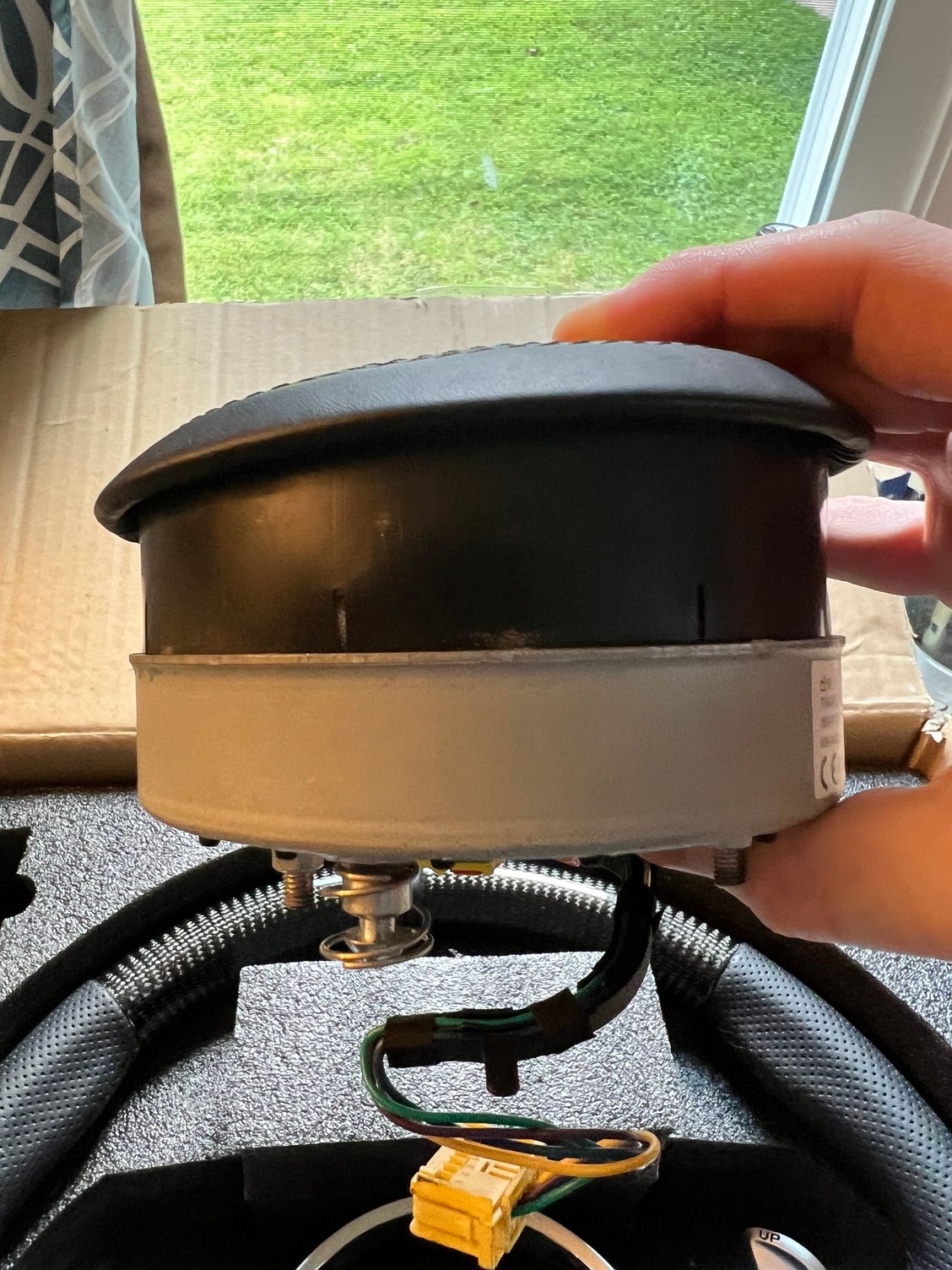

from what it sounds like if its only catching on one side my money is on the actual airbag contact plate. depending on which wheel you purchased there are a variety of different backing plates; if the wrong one is used the airbag wont be able to clip into it. in any case I have a surplus of these plates. not going to charge you anything always willing to help out a member with something this small and stupid
if it was an actual function issue that reuired programing thats another story but for the plate i got you
I really appreciate your reply! It gave me hope for this mod I’d put to bed and hope that there are awesome people out there too. I think this is the problem. I’d brought this up to Chris without a reply. Here are pics. If you need a pic with it pressed in I can, but it’s almost impossible to remove once pressed in because the fit is wrong. Literally took me hours to remove last time.
darrik thanks for the pics. im away from home for the next 2 weeks, but if you want to shoot me a pm with you address ill be happy to send out a new plate once im back
i need to look at one of my airbags as well. those 4 bolts on the back look a bit long to me. would def cause issues when trying to press the horn. but again ill check mine when im back. worst case you need to shave them down some. dont put it back in if its a pain to remove no need.
with this wheel there are 2 backing plates, basically the hole where the airbag clicks in is 2 different sizes. im assuming chris gave you the mounting plate thats intended for the other amg bag with the smaller hole. so your forcing it in and when you try to release the latch you need to force it out. the way its supposed to work is once you pop the latch inside the bag practically pops out
if this isnt something you are comfortable with messing with youre more than welcome to send me the entire package doesnt matter to me.
feel free to shoot me a txt or a call whatever works for you 9788443251

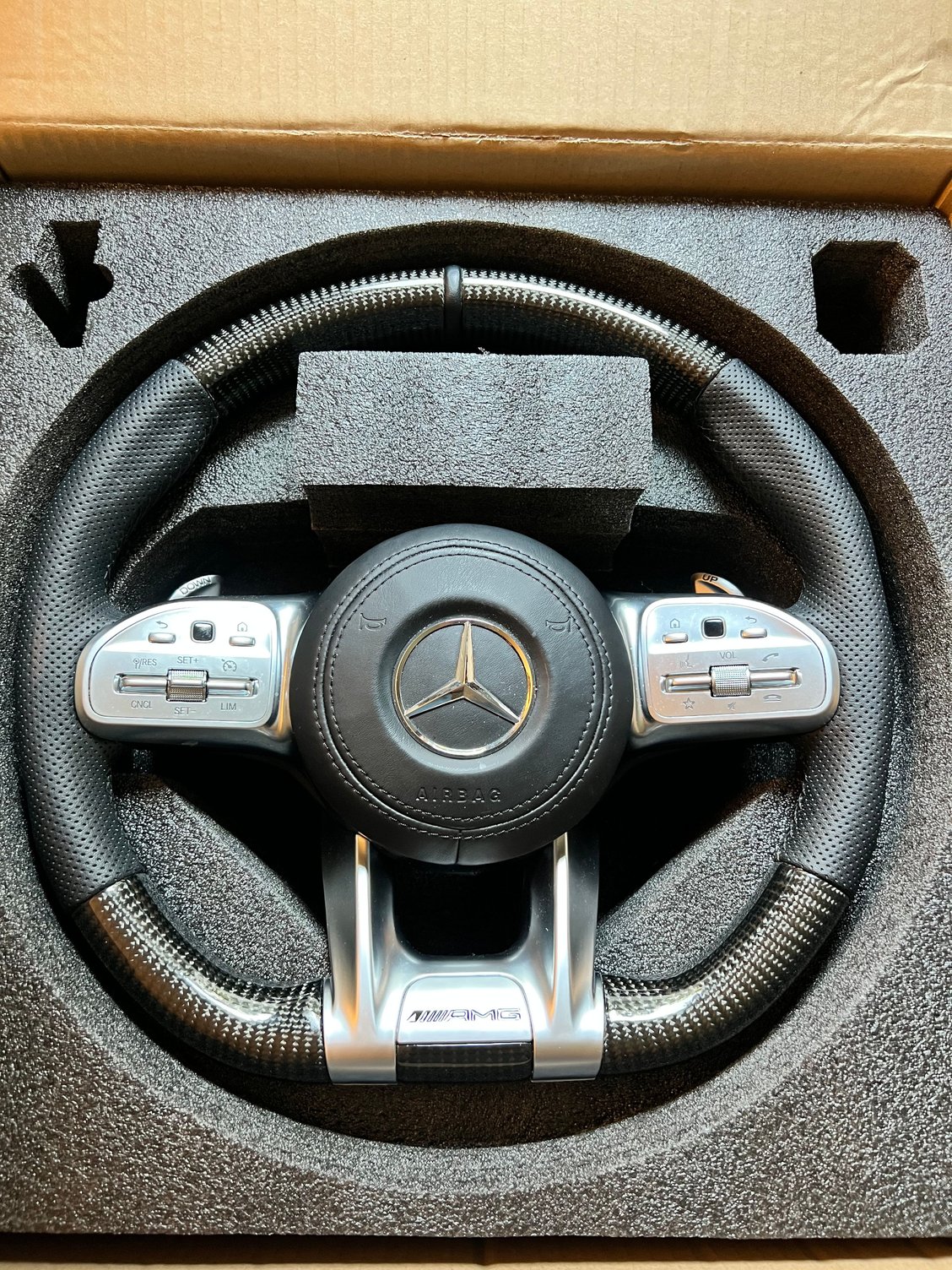

Darricks wheel came in today, did a quick plate swap, tested and going out tomorrow. this concludes the random 3rd party wheel repairs. everyone should be on the road by end of next week
all it needed was a new airbag contact plate.
FYI to all
the 2019 facelift-2021 Mercedes wheels come in a few different formats
flat bottom (AMG) there are 2 different contact plates for the 2 different style airbags, if your airbag isnt clipping in its because you have the wrong plate
Mercedes also makes the non amg version (round wheel) this is an entirely different airbag, it can fit the amg flat bottom wheel but will be obvious it does not belong (the airbag cover is different) cheapest option is to purcase and AMG airbag cover and swap it over, this will fill in all the gaps.
When looking at the AMG airbag it sits at an angle while the non amg airbag sits flat
for those people who already have the new style wheel I highly recommend; if purchasing a custom wheel. just buy an empty core and transfer your internals; this way you will know 100% that all your parts fit and work
for those looking to upgrade an older car to a newer wheel, ask whoever is building the wheel for you to send a video of the bag clipped in, ask them to push down so you can see how the airbag is depressed. if there is no movement theres a problem with the hardware. do your research there are tons and tons of companies offering these wheels. prices are all over the board. if its too good to be true it probably is.
in Darricks case ckm should of provided him with a replacement backing plate for the wheel he ordered, but all thats resolved now.

Old Aug 18, 2023 | 09:06 PM
Darrick30's Avatar
Joined: May 2019
Posts: 11
2017 C300 coupe edition 1
Darricks wheel is enroute, lets get this guy back in action
for anyone interested ill attach some pictures of the fix and whatever additional work the package needs to get it all to fit perfectly
Thanks to this guy, my wheel is installed after so long and so much headache. I’m excited about my ride again! The car is feeling pretty complete now. Here are some pics. Thank you so much lthlc63!
