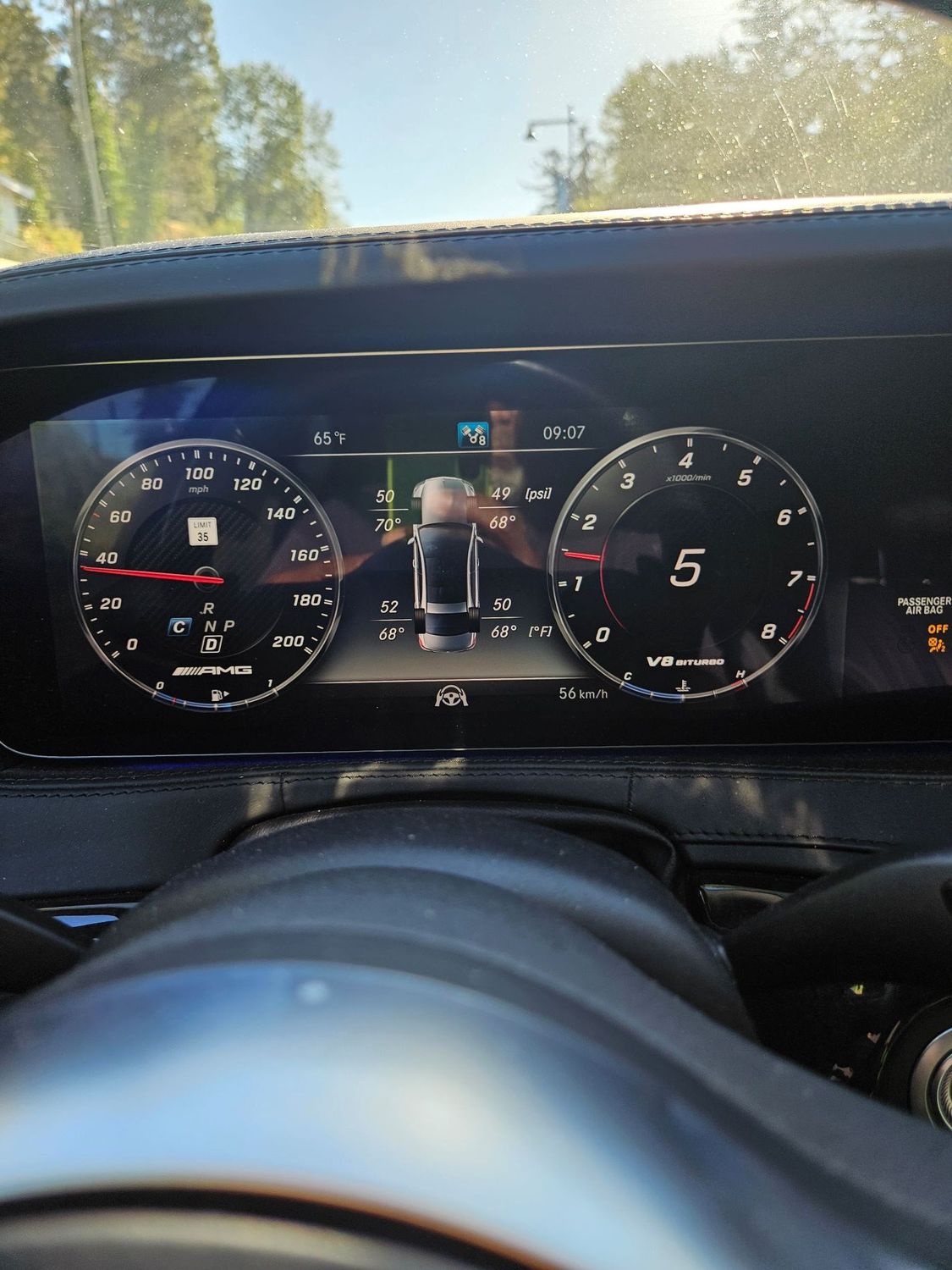

I've followed this thread for quite some time. I have my 18 S63 at 49psi all around when cold. Pressure goes up to 51 most of the time, and occasionally 52psi when driving for a long time on hot days. 9 month old Michelin PS4 AS tires. Car is super quiet and glass smooth at all times, and doesn't seem to make the ride feel more harsh than when I ran my S550 at 42psi.

Door jamb says 49/51 F/R for psi. Max tire pressure says 50psi on front and rear tires. Tire pressures were set by tire shop when I bought the tires. I thought they were super high too, but they felt good so I rolled with them. I bought my S550 with run-flats and thought the ride was good, but not exceptional. When I changed to some fairly reasonably priced Pirelli's, Pirelli P-Zero All season suggested by @vinflouen , the ride got much nicer and quieter. This car is actually smoother and quieter than my S550 with the Pirelli's.

Mine says 50psi on front and rear tires, but that number is the cold air fill PSI. Pressure is always going to increase when driving.

I'll give it a try; the sticker on the fuel door shows 35psi for up to 135mph and 49 for up to 186mph.
My rationale is the absolute best performance possible. I'm totally willing to sacrifice ride comfort for performance. Not so I can ever go to the track, just in case I need to make an emergency manuever, or passing on the highway safely. I want max stability, aceleration and stopping power. What's the best tire pressure for that??
