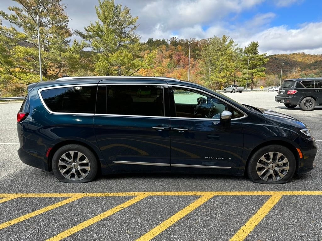

We had two flat tires on a brand new Chrysler Pacifica last fall, on a trip.1,200 miles on it.
Had it towed to a local WV WalMart which was the only option, all they had were crappy off brand tires, so I bought two. When I got home, I ordered 4 high quality name brand tires (the OEM tires were also crappy Nexens) and threw away the two offbrand tires I had just bought and the two remaining crappy Nexens. Tires are the only thing that connects the car to the road. Not a place to skimp IMO. To me, this would be a great opportunity to ditch those crappy Hankook tires that MB should be ashamed to have put on the car in the first place and get a great set of high quality Michelins, Pirellis etc.
