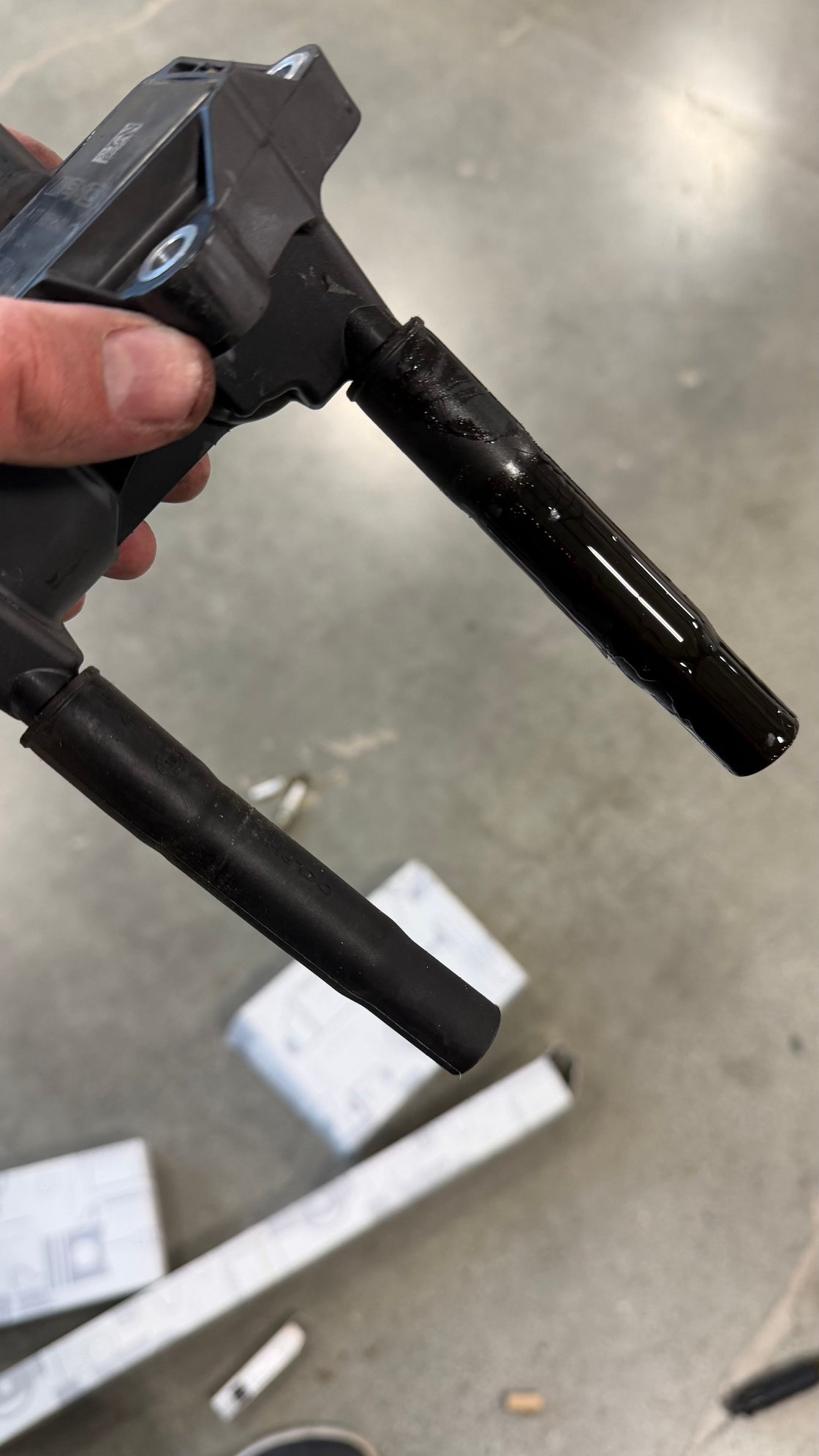

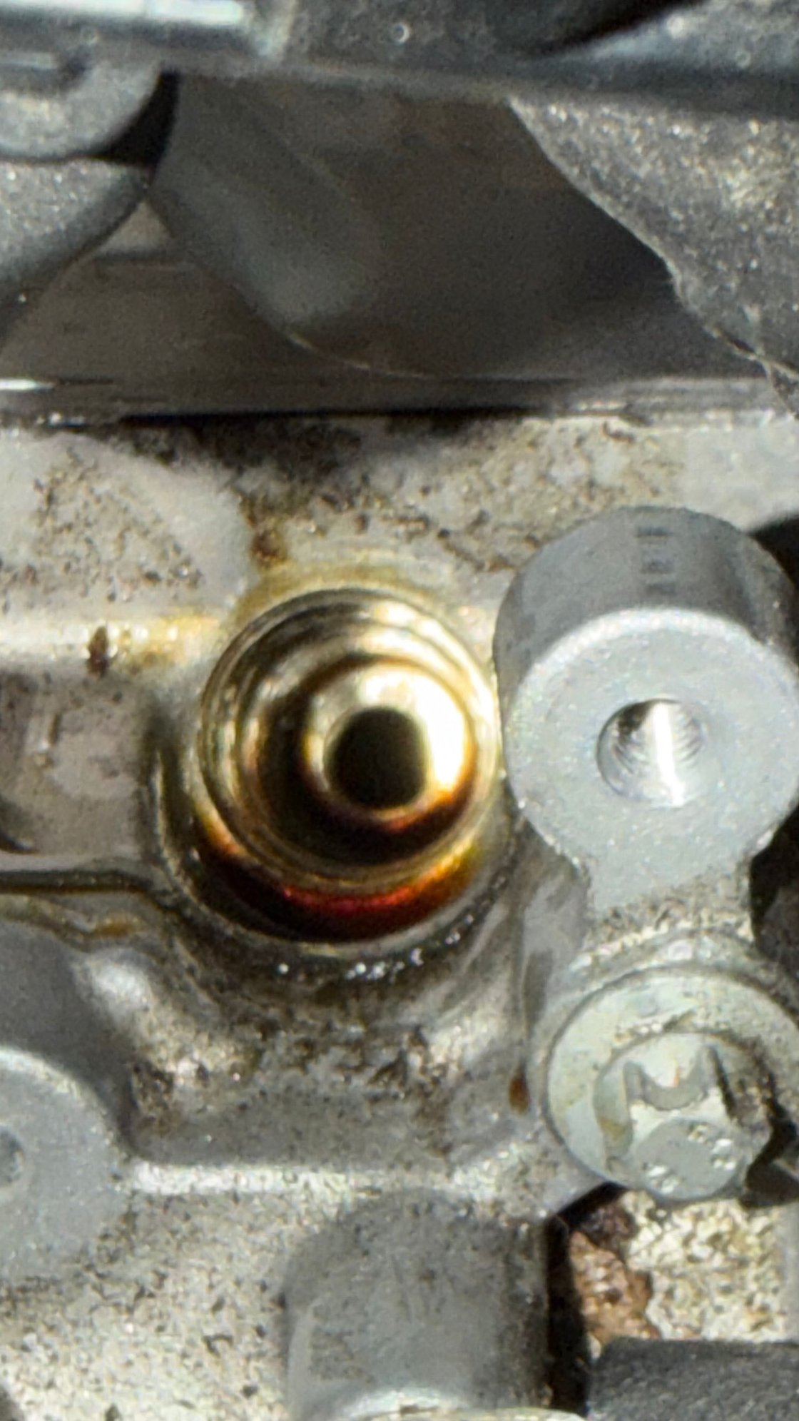

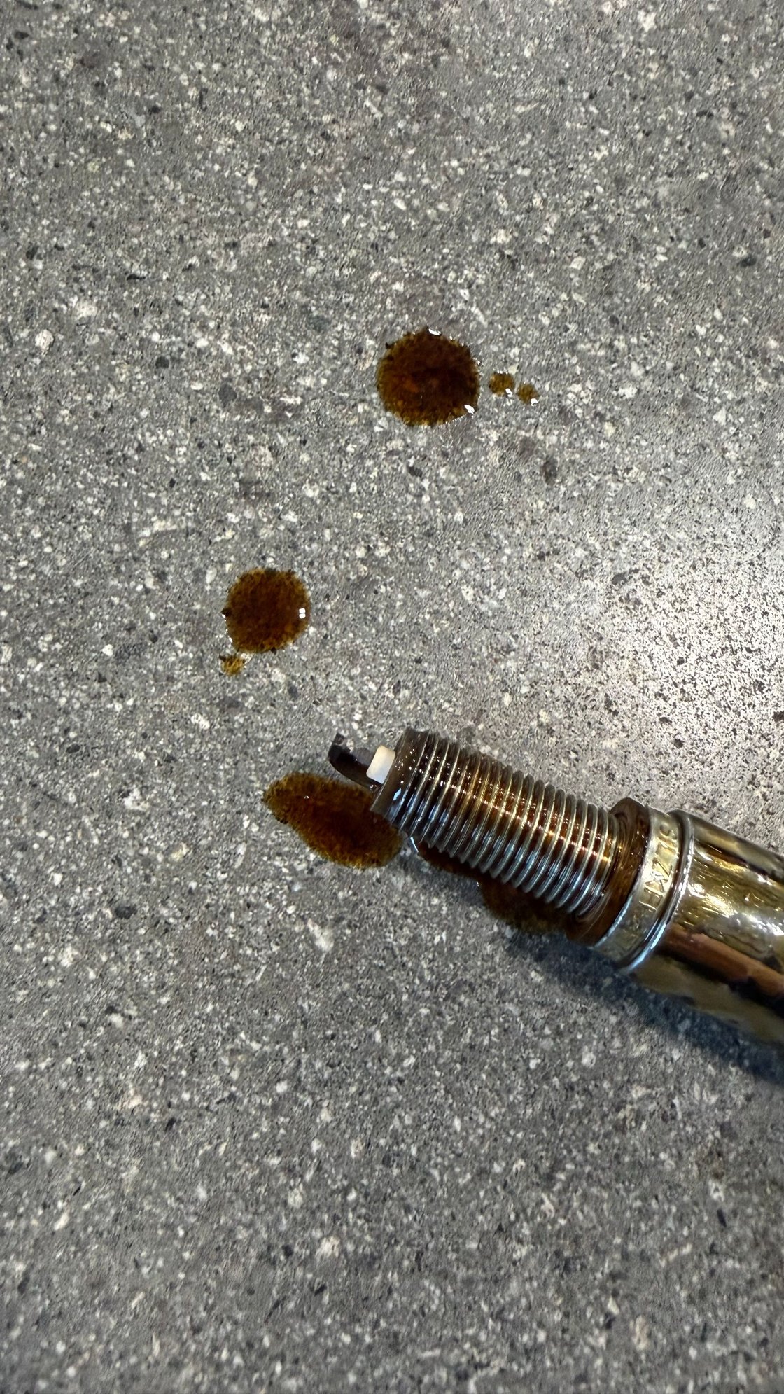

Hi everyone,
I have 2019 s560 with 40800 miles. I replaced my spark plugs and found #3 and #7 had oil inside spark plugs wells.
I have Veritas extended warranty with deluxe option. Tomorrow I will take it to dealer.
I hope they would cover it. I will let you guys know

That is a well lubricated spark plug.

Luckily, it will be covered under 90 days/4000 miles warranty by Autonation. Dealer told me, it will take about 1 week

Oil separators are the reason for all those issues. If you get updated version installed and do oil changes every 5k miles, I dont think you would have any problems
Are they going to change out the OVS too, or just reseal the valve cover gaskets?
When they did mine replacing the OVS was part of the job

they should replace OVS otherwise it would cause same issue since there will still be extra pressure. I havent heard them since I dropped the car off. I hope I will learn more next week
