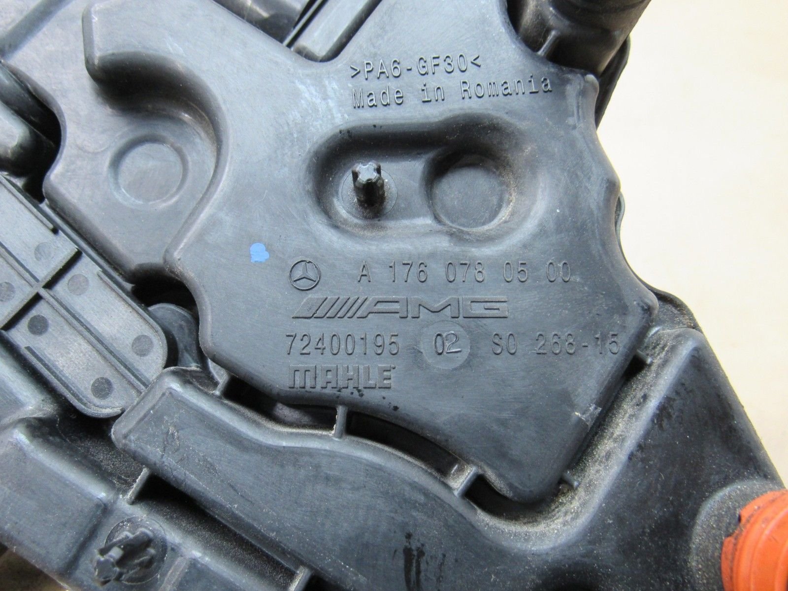

Updated Oil Separators are only for M177/178 AMG models.
For M176 engines, Oil seperator part numbers are still same so they are not updated

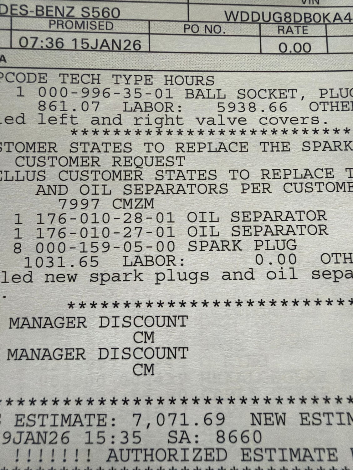

Finally after 3 weeks I picked up my car.
I am sharing invoice, so you guys can check what parts used.
Paid extra $821 for oil separators and spark plugs. Rest is covered under warranty
$7831 total

What were the part numbers for the separators, don't see those in the listing ?

Thats about right, I think mine was $1,000 more including the separators...different dealer pricing etc. Mine was covered under warranty too thankfully

M176 oil separators are different than M177/178 oil separators.

Interesting ... I found three OVS described as "left" for 2018, 19 or 20 S560 on EBay and each had the part number A 176 078 05 00. Perhaps the item they gave you was a newer part with the different numbers shown?
I checked on mbparts usa website. Ebay is little sketchy for parts.

Yeah, reason I brought it up is the part numbers for these are such a mystery ... the Mercedes parts catalog doesn't have a left side number or fitment data and the dealer says to order the part number that's on the old part you took off. Based on these EBay items, it appears many 2018 - 20 cars had this number on their original OSV, making me wonder how it was that your new one had a different number.
Hey Tom, I know they updated part numbers from the originally installed OVS to the OVS they using to fix the cars. Like you, I've followed the W213 section and they ahve talked about updated part numbers extensively. I think @superpop mentioned that when he posted about his experience. He also cut his old OVS open to show the design.

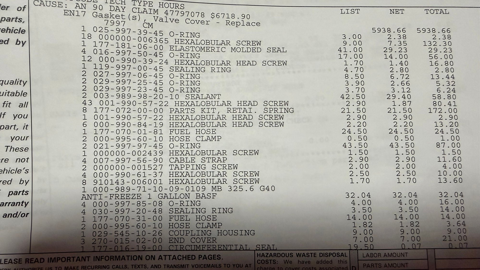

valve cover gasket issue. 20 hours labor to repair it. They will remove bumpers, crossmember many parts, turbos, harnesses. If they would remove engine let them replace Rear Main Seal too.
s560 uses rtv type liquid gasket not a physical one. Technician should do a good job reseal them.
while they removing many parts, have them replace Oil separators, spark plugs and thermostat. With 87k miles I would chage engine and transmission mounts too.
M176 engine does not have updated oil separators. Updated version is only for M177/M178 AMG versions.
In bay area california, mercedes service bill was $7800 for valve cover gasket resealing spark plugs and oil separators (for spark plugs and oil separators I paid only parts not labor)

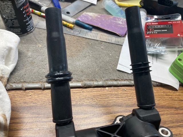

Carlos, not sure how effective the boot ribs are. When I changed my last coil pack I had oil on the outside of the boot below the ribs. As an experiment, I put an O-ring between the upper two ribs on #7 and with some 'Kentucky jelly' was able to push the boots back down into the bores. The joint that leaks between the cam cover and the head is almost at the top of the bore, so one would think the ribs in the installed position would end up below that joint and seal the bore.
As an additional comment, I wiped the oil off the old boots and set them aside last fall. I was surprised later to see they had oil on the outside again, almost as if they were 'sweating'. Appears the boots are somewhat porous and may actually absorb some of the oil that leaks onto them.

If I remember correctly, the valve cover leak happens under the sealed part of the coil packs, the part under the ribs of the coil packs where they connect to the top of the spark plug. The ribs on the coil peck actually seal the oil inside the spark plug well, instead of blocking the oil from dripping into the spark plug well. I could be mistaken, but that's how I remember the design from when I changed the coils and plugs on my 18 S63 last year.
I'm pretty sure that if not the top rib then the next one down would definitely seal the bore from oil. In this photo you can clearly see the seam for the valve cover above the plug bore.

Found a picture of the #7 plug boot mentioned in my previous post ... looks like I might have added two O-rings between the ribs. My engineer buddy and I have debated whether they could affect the engine in any way but so far it runs fine ....
$7831 total
Mercedes sure is fond of their one-use fasteners!
