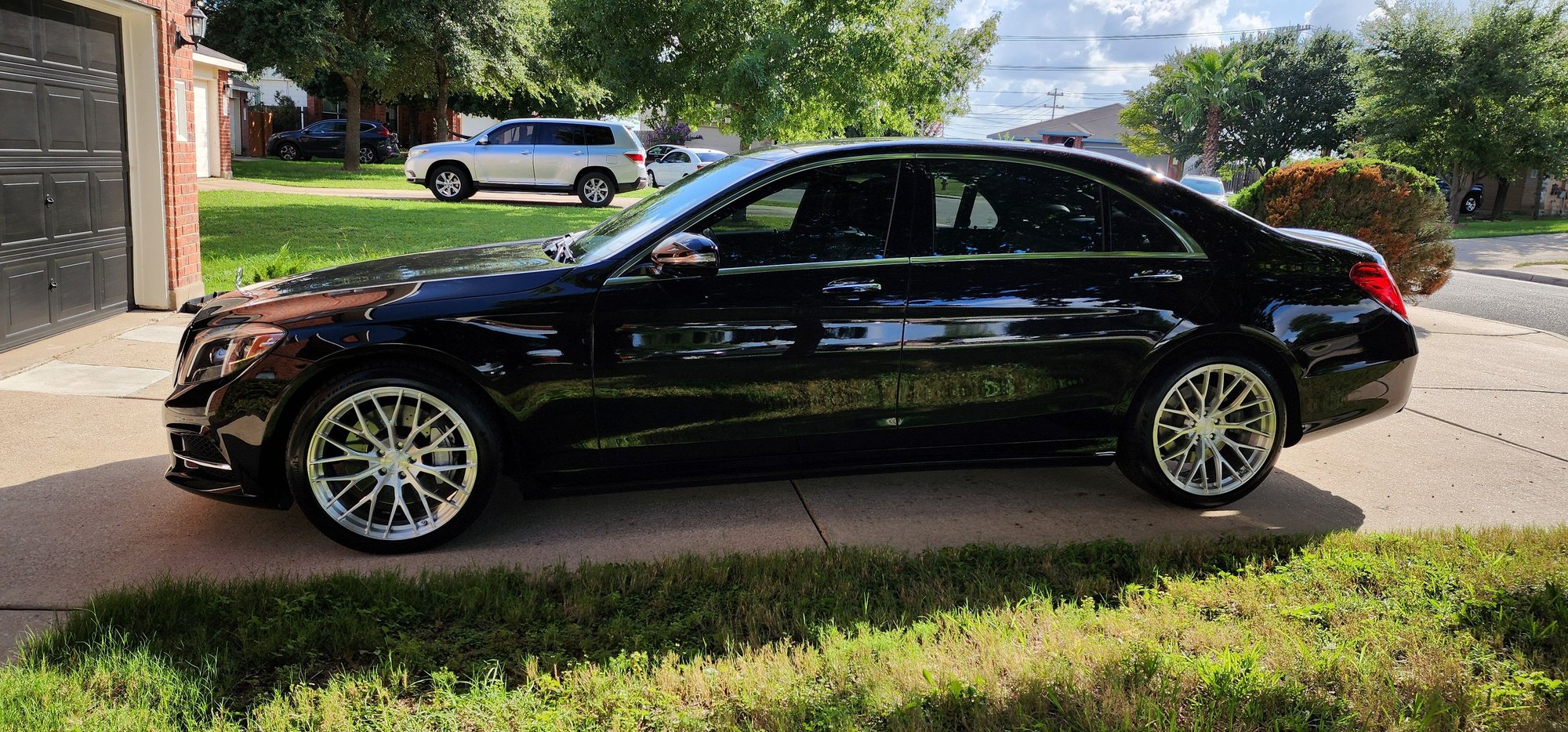

As requested, here's a pic from today:

Beautiful car...wow, your paint looks like liquid metal!! Nice

Car looks great - all you need now is the Benz Ninja reprogram to return it to Euro ride height. That 1" drop really helps the look when the car is just sitting imho.

Looks like the car is in the "raised" height mode. My S550 rode lower than that for sure in normal mode. H emust have raised it so we'd get a better look at the tire/wheel package.
Actually, it was in Comfort mode. I started it, let it run for a few seconds, and then backed out of the garage. When it's in Sport mode, it sits lower for sure, but for Comfort, that's it's normal ride height.
Interesting...maybe it's just the lighting, for some reason it looks like there's a larger than expected gap between the tires and wheel arches. Again, hard to see it well with the lighting. No doubt you know about changing the ride height with the button on the center console. I always thought the car didn't lower in Sport mode while sitting still, and lowered automatically when reaching a pre-determined speed. My 2017 didn't change ride height while sitting still when changing driving modes, at least I don't remember it behaving like that. Regardless, that's a beautiful car!!
