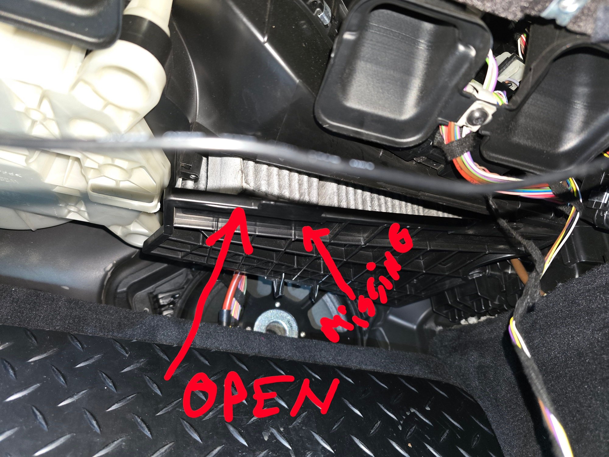

Hello everyone, I know it's not related to the post but I'm a new W222 owner and new to the forum. I also have a problem with my W222 and I can't find a solution anywhere, the problem is on the left side, when I turn on the heat, exactly by the trim that covers the ambient lights, cold air blows out that freezes your knees. Maybe someone else has faced this problem and can help me too, I'm attaching a picture of the location where it blows cold air. Thank you, have a good day!

There is no vent there? How much air is coming out? Any work done on dashboard?
Would recomend a separate thread.

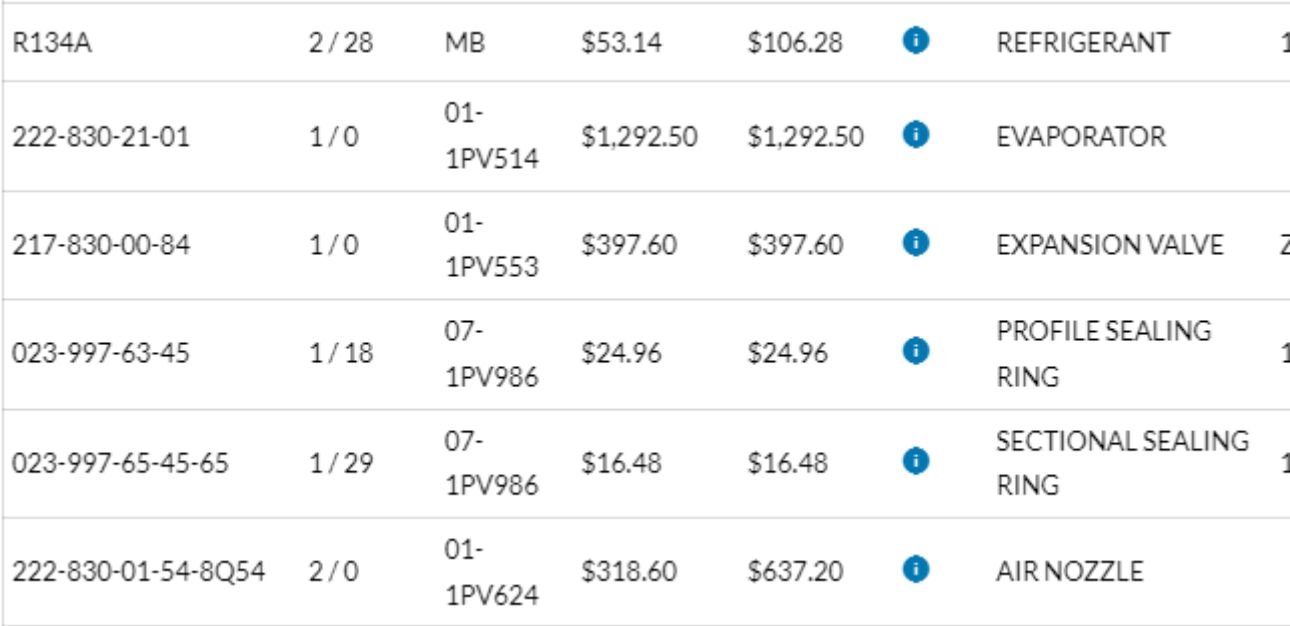

Only information I got from these guys. This is their email, per my request:
CUSTOMERS CONCERN - GUEST STATES A/C IS NOT WORKING CORRECTLY IT DOESNT BLOW "COLD,COLD AIR" ITS VERY MILD , CUSTOMER GOT A COMPRESSOR DONE IN SEPT OF 24, AND HVAC RECHARGE WAS DONE LAST WEEK. HE STATES THAT ITS STILL NOT WORKING PROPERLY AND THE RIGHT FAR VENT DOSNT BLOW ANY AIR AT ALL PLEASE CHECK AND ADVISE - APPROVED $279.95 DIAGNOSTICS
DIAGNOSTICS - THE TECH VISUALLY CHECKED FOR LEAKES AND FOUND NO TRACES. HE CONNECTED THE AC MACHINE TO CHECK PRESSURE. HE FOUND NO REFRIGRANT IN THE SYSTEM, HE CGARGED THE AC AND INJECTED DYE. HE RAN THE AC FOR SEVERAL HOURS. THERE WERE NO LEAKS PRESENT, HE USED A EVAP CORE BORE SCOPE AND DISDNT FIND ANY DYE. MEANING THE EVAPORTAOR COILS ARE NOT DRY, THERE ARE WET SPOTS, INDICATING A LEAK. + WE HAVE FAULT CODES IN THE AAC CONTROLLER FOR THE RIGHT AND LEFT DAS VENTS.
RECOMMENDATIONS - REPLACE THE EVAPORATOR COIL AND THE RIGHT AND LEFT A PILLAR VENTS
REPAIR COST/ESTIMATE - $8187.74
BREAKDOWN -
19.5 IN LABOR $ 5459.03 - DASH AND CENTER CONSOLE NEED TO COME OUT
PARTS - $2475.02
[img]blob:https://mbworld.org/d5826149-9073-4e66-8297-73a846768931[/img]
+ TAXES AND DISPOSAL = $8187.74 (ESTIMATE)
Why the evaporator was not picked up before, even after a return visit, is beyond me. Why it seems there aren’t ducts or air flaps listed in this most recent breakdown, is also beyond me WT*? Can a reset of some sort make this work for only 2-3 weeks?

Yes a recharge and clearing of faults would put the system back into function and then once enough refrigerant leaks out the compressor would be turned off.
The tech is stating you had no refrigerant so the leak diagnostics makes sense, but there seems to be an error in the redacted text as that should say he found dye on the evaporator and therefore it needs replacement.
This could be your issue as long as the leak has been correctly identified in the evaporator (it happens but it's way more common for the leak to be in the condenser as it is exposed to road debris).

Also the parts quote is mistaken they are quoting to replace the nozzles on left and right but you need the duct and motor, like misunderstanding between tech and parts guy.

Problem identified and solved. The previous owner went to a garage to change the filters and they didn't close the lid... Idiots.
