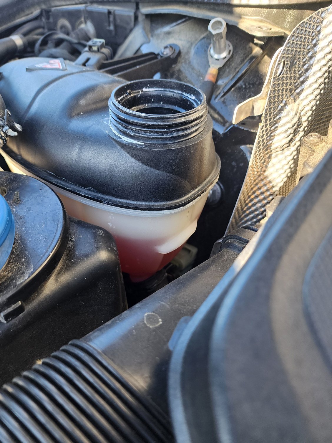

Is this what the appropriate coolant level should be in the reservoir? I intermittently get an alert to check coolant level, have changed the reservoir but issue still persists.

false positive
To save your time, use a scanner to read your chassis faults. You'll see what module is calling what faults...
Coolant level does NOT look low!
Having a new tank already perhaps the sensor itself failed and soaked the connector.

Looks like you have some white crusty stuff on the threads for the cap ... that's an indication of coolant leaking.
I had this on my car and just got an $8 replacement cap on Amazon. Haven't seen any more messages or had to add any coolant since

thanks for the clarification - can I top it off with distilled or de-ionized water until the new cap comes in?

Yes a top off with water will be fine.

That bootle is low, full is at the level that the white part ends. Also it's normal for level to variate a bit from cold to hot as coolant expands (hence the name expansion tank) but if you notice you are loosing coolant that cap does look like it needs replacement.
On the oil control solenoid, that's a whole debate but you'd blow the engine before you evaporate coolant so no need to worry about that being related to this.

thank you all for your input, changed the reservoir cap and have not had any issues since
