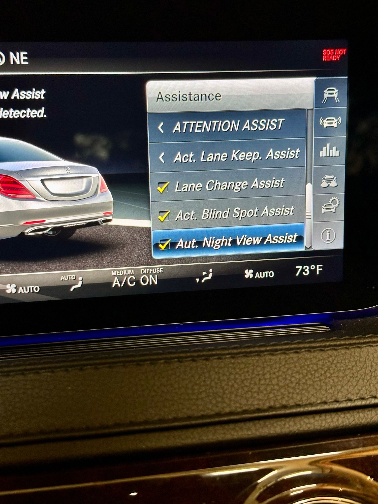

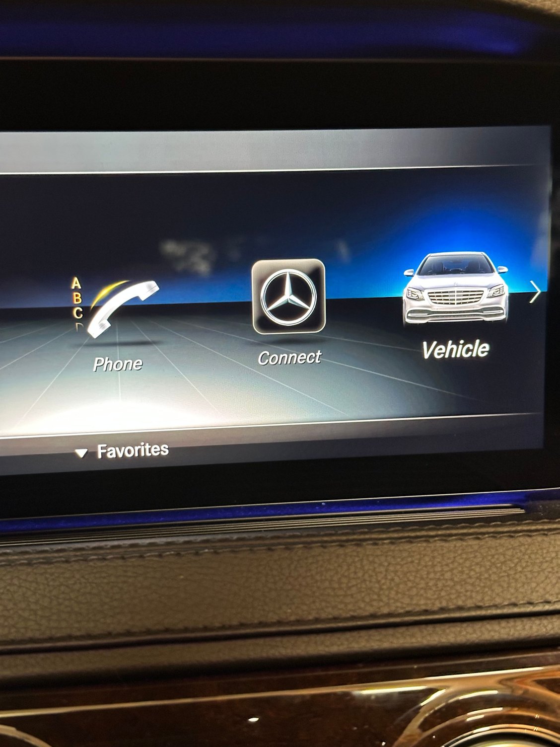

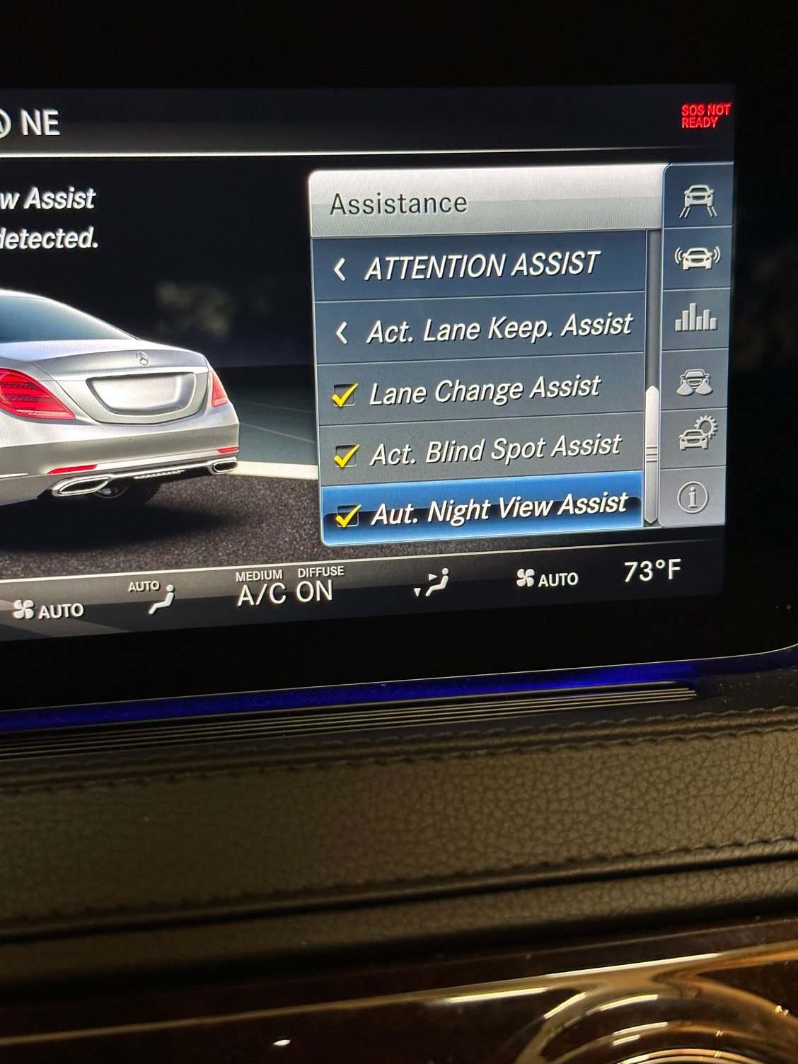

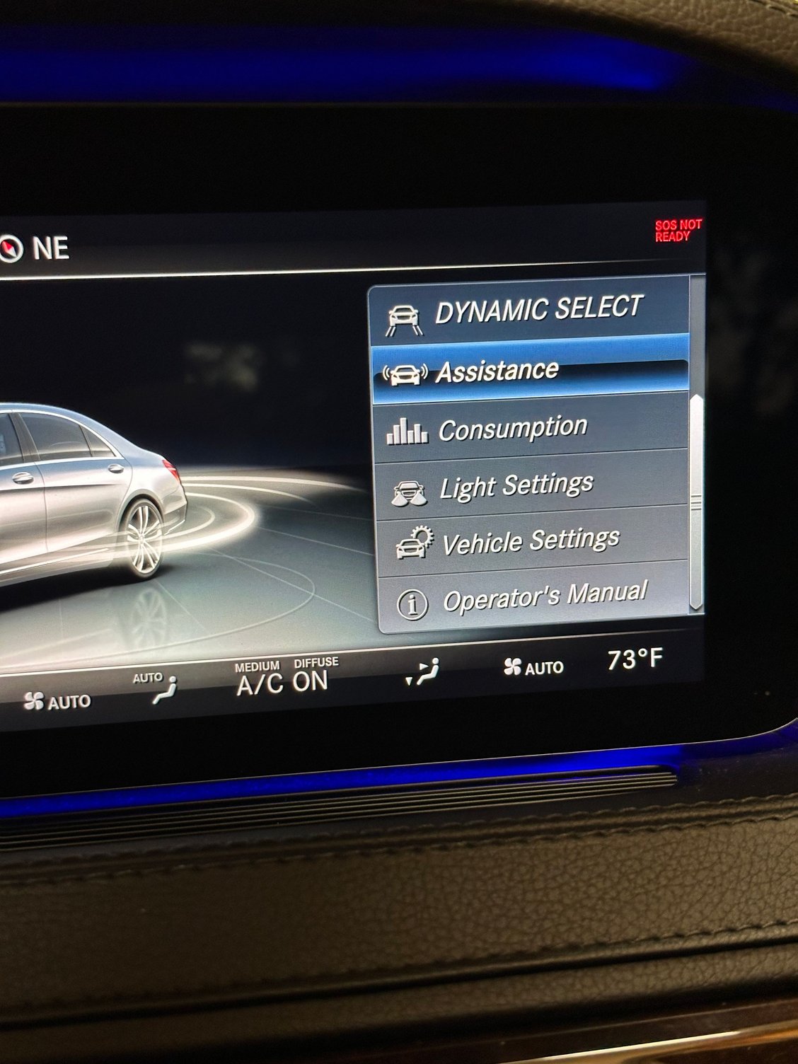

I don’t think I have that screen. This is what I have… when I go to home I don’t see SETTINGS at all. I see Nav Radio Media Etc. I find the rest under VEHICLE…
VEHICLE
ASSISTANCE
AUTO NIGHT VIEW ASSIST
Am I doing something wrong? Looking in the wrong place?
Thanks!

Quote: I don’t think I have that screen.
Am I doing something wrong? Looking in the wrong place? Thanks!
No, my mistake. Sorry.
I gave you instructions for the pre-facelift version (2014-2017 models).
Your settings look good.
Reply 1

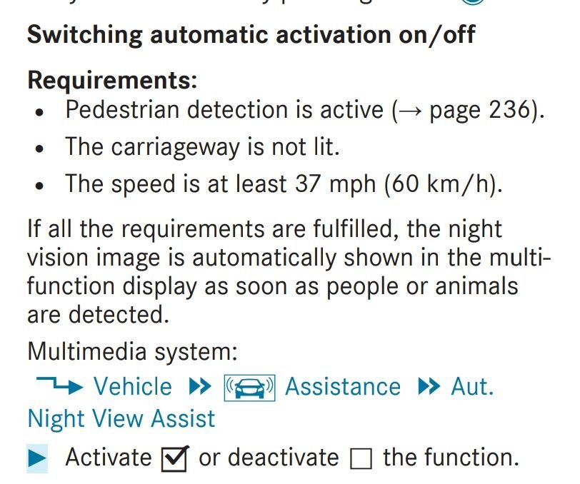

AGAIN:
Why do I have to be the one to go look at the manual...
Reply 3
Jan 7, 2025 | 07:30 PM
Quote: AGAIN: Why do I have to be the one to go look at the manual...
To drive your point home? Sorry, I should have clarified my response...
VII you are not incorrect. You are correct regarding that for "automatic activation" of NightView, in the vanila settings that are standard in our North American vehicles, one must be in a rural or unlit environment for it to engage. However...
When Peter (a.k.a. BenzNinja) coded ILS+ on my car two years ago he also "upgraded" my NightView settings (for free) as well. He activated Animal Detection, augmented the Spotlight function, and enabled Rural plus City functionality for automatic activation. I work in a city of 100,000 and the automatic activation screen functions at night in town as well as the trip back home to the foothills. This is why I suggested to Billy to have BenzNinja look at it.
Reply 2
