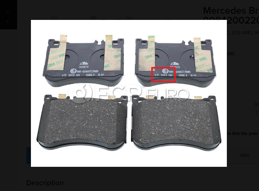

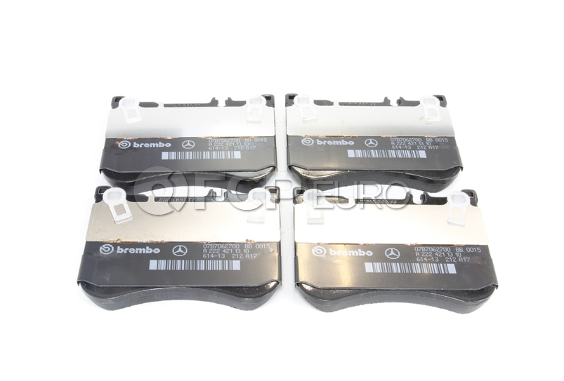

I was looking up the 0084200220 brake pads and to me it appears the Genuine Mercedes pads are made by Jurid. I noticed the Jurid name looking at the Mercedes pads but had to search around for a better photo to read exactly what it says. Then I looked at the Jurid pads on FCP and they are under OEM. I dont think FCP is very accurate so take that for what you will.
Also does anyone look at the friction code on the pads? For my W204 the genuine Mercedes were FF for the front pads, and the Ferodo pads I ended up buying were FG, which on paper is supposed to be better stopping at higher temps. Then the rear the Mercedes pads said FF and the ATE pads I bought were GF I believe, so better stopping at lower temps. I think the Quietcast were even higher at GG.
I noticed the W222 Genuine Mercedes show FF. Looking at the ATE pads im seeing HH. I do not know that much about brake pads though from my understanding an HH rating is very aggressive and works better in higher temps, like racing?
Heres the FCP photo of the Genuine Mercedes Pads, showing the Brembo name.
Close-up photo I found on eBay: Stamped Jurid with friction code FF:
