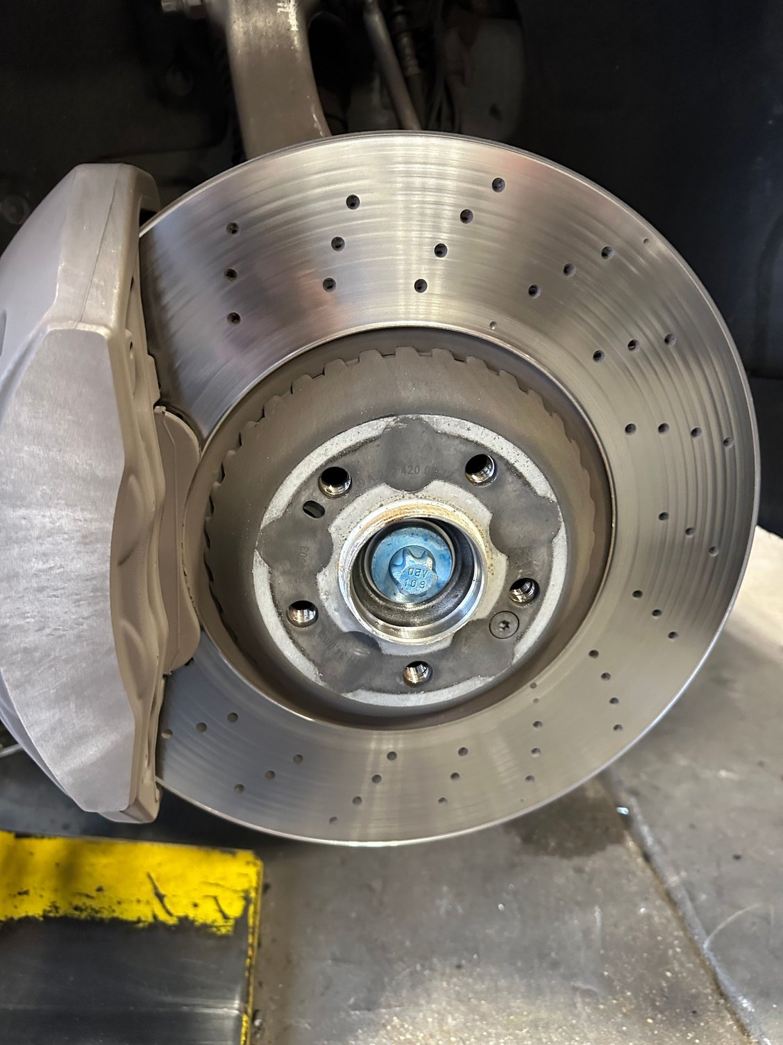

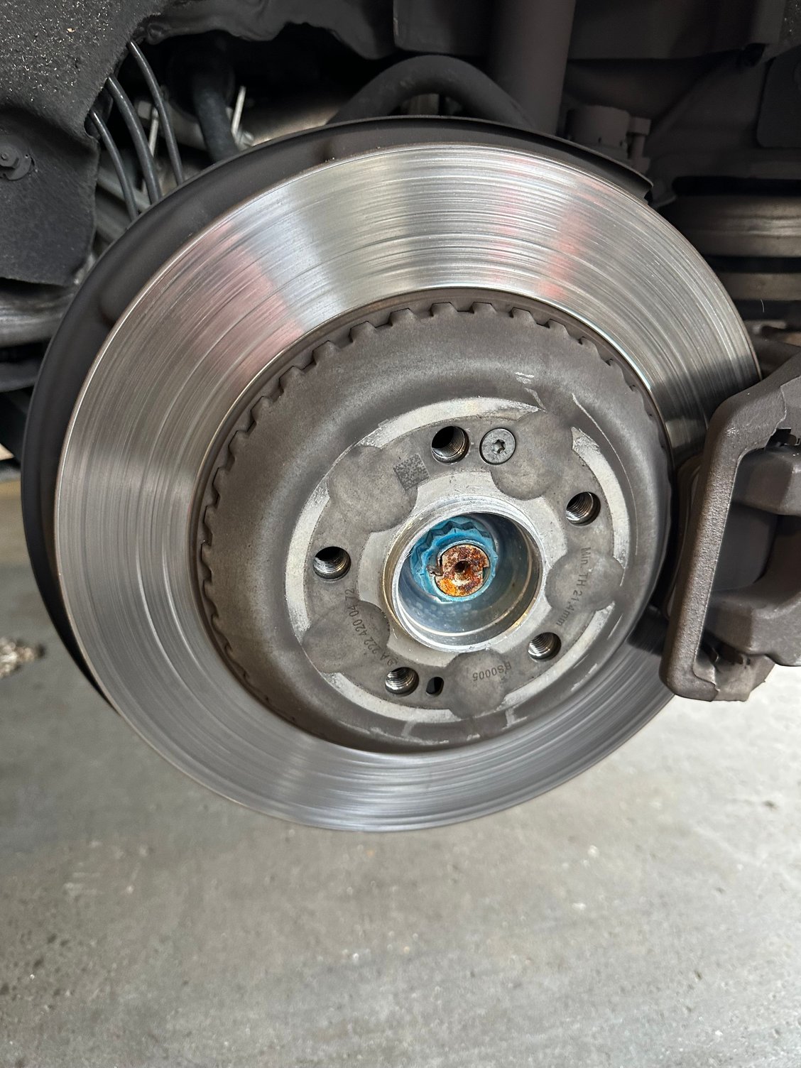

Rotors
I think when I replace my brake pads I’m going to replace my rotors too. Probably go with Bosch OEM and this will be mostly highway miles. Put on new tires today and took some photos rotors while the wheels were off and I’m interested in any opinions. Trying to learn from those that have more experience.

Those Rotors look done. I would swap with the Powerstop kit from Rock Auto. Should be able to do all 4 corners for around 600.00 with fluid. Includes new Rotors and Ceramic Pads that will eliminate the brake dust you are probably seeing now with no degradation in performance.

Look for a lip on the outer edge, if it's 1 mm - or approaching that - then I'd replace them.
You could take a precise thickness measurement with calipers in several places (usually 2 mm below original thickness is the minimum), but the size of the lip is a fairly reliable indication.

When the scoring is so severe it shows in photos, they're toast. These rotors and pads were OE?
I’m not sure but my guess is that these are original. This car has 32k miles on it and it’s been well taken care of in every respect I can determine. The people who have looked it over have said it’s near perfect save for the brakes and tires. Tires are done so I just have this left. I’m going to do fluids as well just so I know what’s in it and when it was put in.
I showed these to BenzNinja and he said to replace them as well. Now I’m back to figuring out what to go with for pads and rotors. I’m leaning towards Bosch as I’ve heard mixed reviews on the PowerStop. This will be driven by my wife who drives like an old lady (when she doesn’t take my truck) and by me on longer drives to Houston which is five hours of highway. Otherwise it will be going to church a couple of times a week. Yeah - we are kinda boring I guess. 😂
Looking at FCPEuro I see kits for the front but not for the back. I don’t think I even see rotors for the back for my car - 2018 S450 4Matic.

As with pretty much all German cars, pad swaps are never recommended. If your car is due for new pads, then it's also due for new rotors. For my last brake change, I purchased OEM equipment online at a heavy discount and had paid an indy shop to do the labor. Saved me around $300 per axle.

Don't waste money, measure your discs. The wear holes are still visible on the fronts so those are likely ok.
Also note the OEM discs are two part, you would increase unsprung weight with a single piece aftermarket.
Just FYI the OEM rotor, at least on the non AMG car, is a one piece rotor.

No, the ones pictured here with the 'gear' looking interface between disc and hat is a two piece rotor.
I had the same rotors on my S560 and I replaced them, they are a one piece rotor
