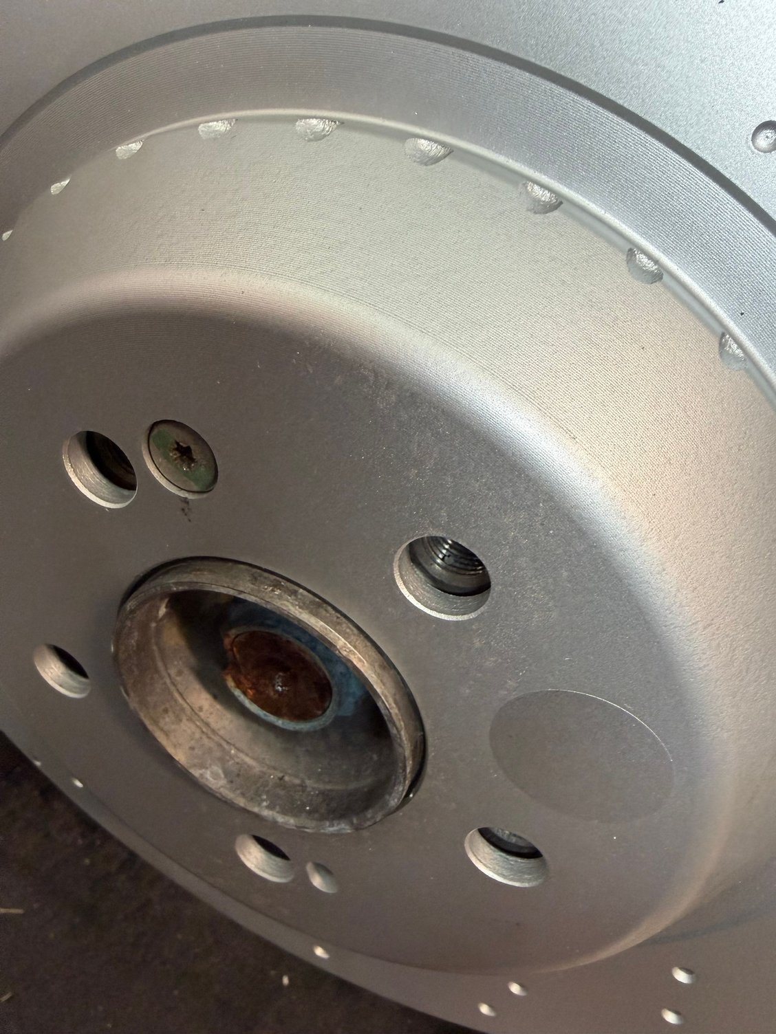

Hi all- curious if anyone has had a fitment issue with their REAR Powerstop rotors. I went to install, and the hub bore of the rotor will not clear (diameter of the bore is too small) the hub on the car, causing the rotor to not sit flush against the hub. Powerstop is looking into it for me. I had no issues installing their front setup. I have sports package, drilled rotors. PN: PST EBR1602EVC. 2015 S550.
you can see the 1/8 gap in the lug hole.

Old May 29, 2026 | 06:54 PM
  #94
Jay04SL's Avatar
Joined: Mar 2012
Posts: 120
Likes: 16
2004 SL500 // 2015 S550
Tried another set of powerstops and the amount of wheel mounting hub is unacceptable to me. About half the hub mounting surface of OEM. The rotor is much thicker probably bc it's a one-piece.
Any thoughts?
OEM Rotor
OEM Rotor
Powerstop Rotor
Powerstop Rotor
Old May 29, 2026 | 06:59 PM
  #95
VII's Avatar
VII
Joined: May 2011
Posts: 978
Likes: 274
From: Fort Worth TX
2020 S560, 2014 SLK55 (Prev. 2016 S65, 2013 SLK350, 2008 CLS63, 2006 E350, 2006 CLS500, 2005 C230K)
Yes you can't install that, surface must mate flush.
Surprised they've made such a simple mistake.
