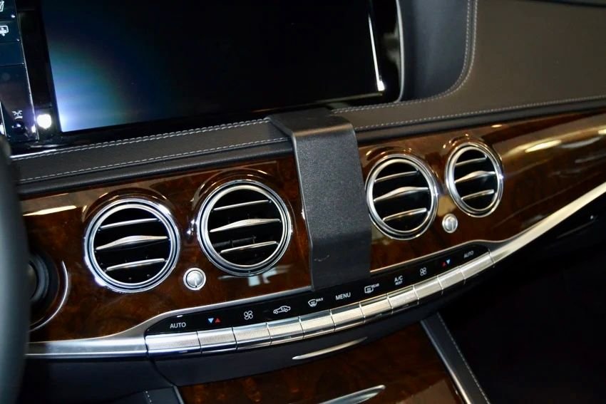

This is a stock photo, but this is where our phone in mounted on:

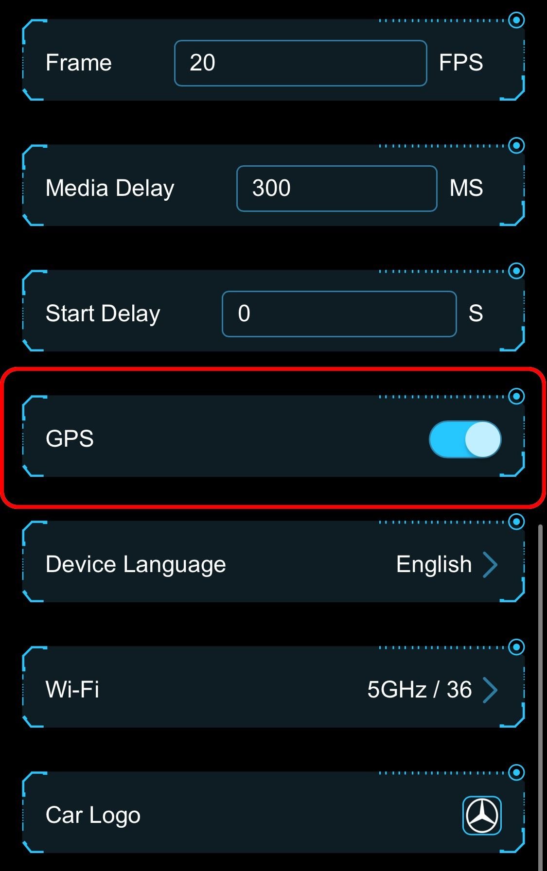

Guys.,. I have told you before and now I will confirm it… I am a moron.
So I go into my wireless CarPlay unit and see something that MIGHT have something to with my problem here. Just maaaaybe….
CONFIRMED MORON!
I won’t mention how many hours I spent on this. A LOT! Was about to bring @BenzNinja into this too. Haha.
