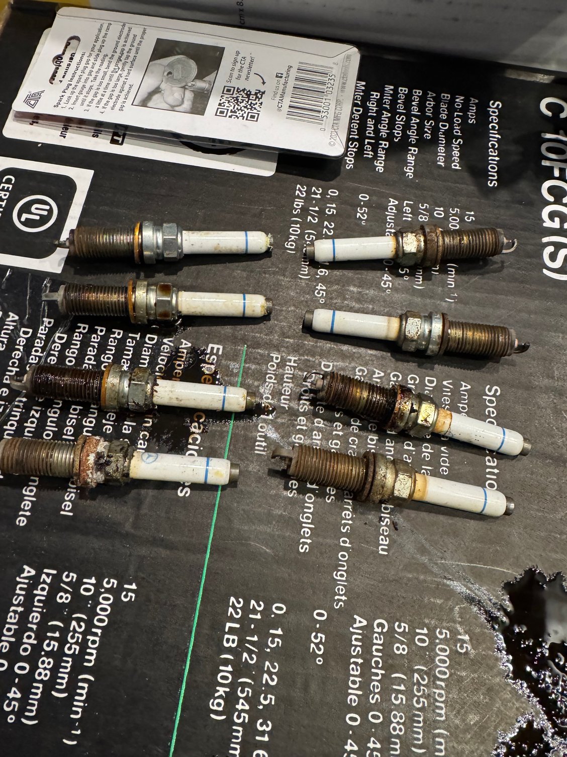

all done.
4 new coil packs, 8 plugs….
car runs perfect now.
check out the plugs.
42k miles on these.
photo taken as if from front of the car.
look at the 2 plugs with oil on threads….
no leaks visible.

I'm going to do mine next week, hope there's no oil on any of them! BTW, did you have to disconnect and take out a high pressure fuel line on the left side? That's mentioned in a video I watched on doing plugs on the 4.0 liter engine ...
im at 91k, gaskets are due soon but Im surprised at the oil on the threads.
You have to disconnect the battery so the fuel pump is not running, and then disconnect the fuel line on the left.
You cant get the coil out with the fuel line in place.
also on right side, in the back there is another t25 that you have to take off to remove some silver tube to get at that coil.
i had 2 stuck boots….one of them took almost an hour of pulling on to get it out.
all other bolts are 10 and t30.
torque plugs to 23nm.
