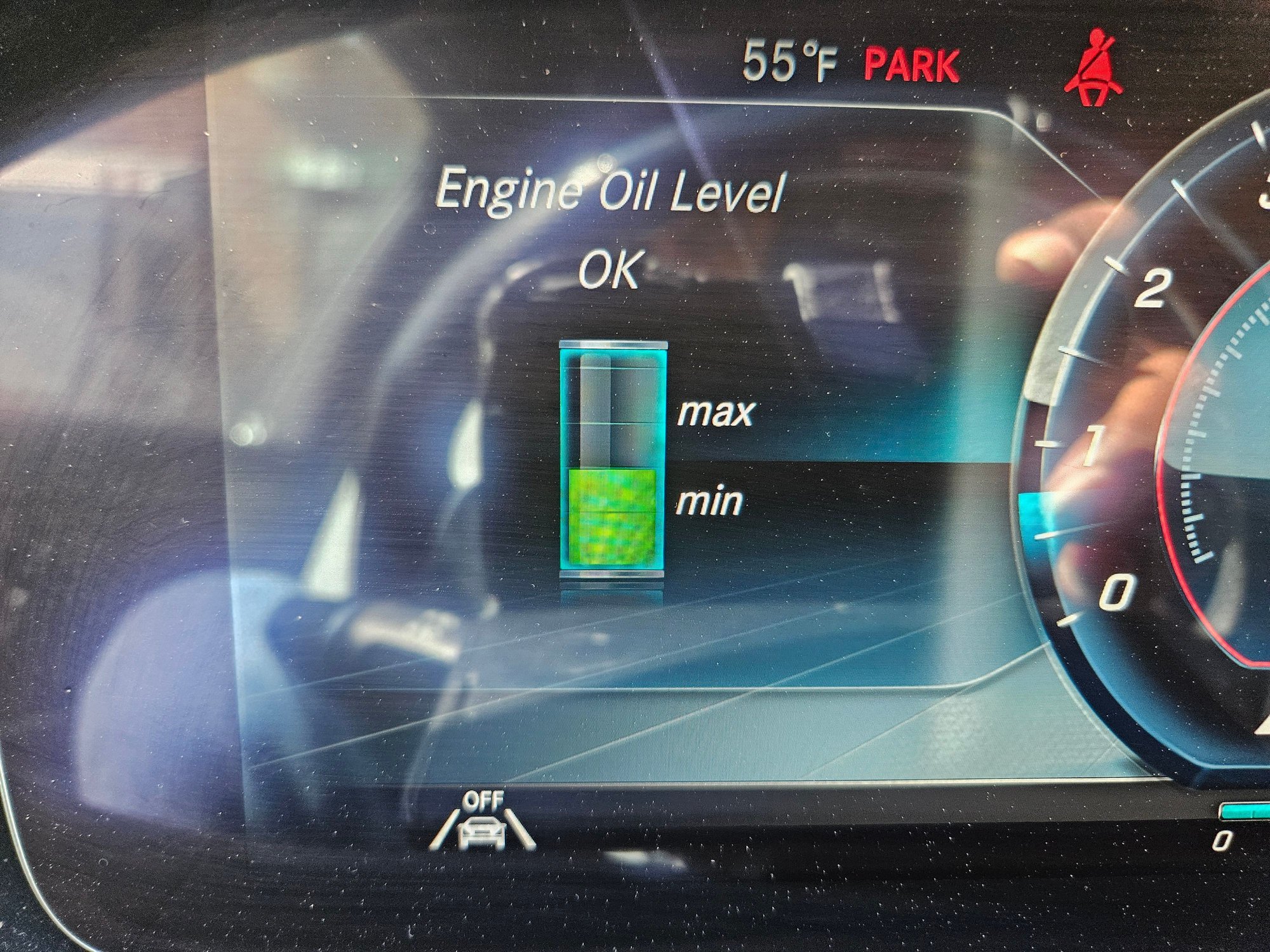

The oil gauge shows that the oil level is at 2 bars and that oil level is"OK." Should I top off or wait for the "Add Oil" notification?

Make sure to measure at a leveled surface, it is ideal if the oil level is closer to max but not above it. The operator's manual does say recommended level is between min and max.

Thats perfect. If you add to much it will complain. On my wife's car if I get the oil level almost at max and she drives over rougher streets it will alert her that the oil level is too high.

I agree, right in between give or take is the sweet spot. I had it filled to the max line at one change, whenever it was going up hill, bumped around, or at higher altitude the pain in the *** warning would pop up. I didn't think altitude affected oil volume but I suppose the air in the closed system did something.
