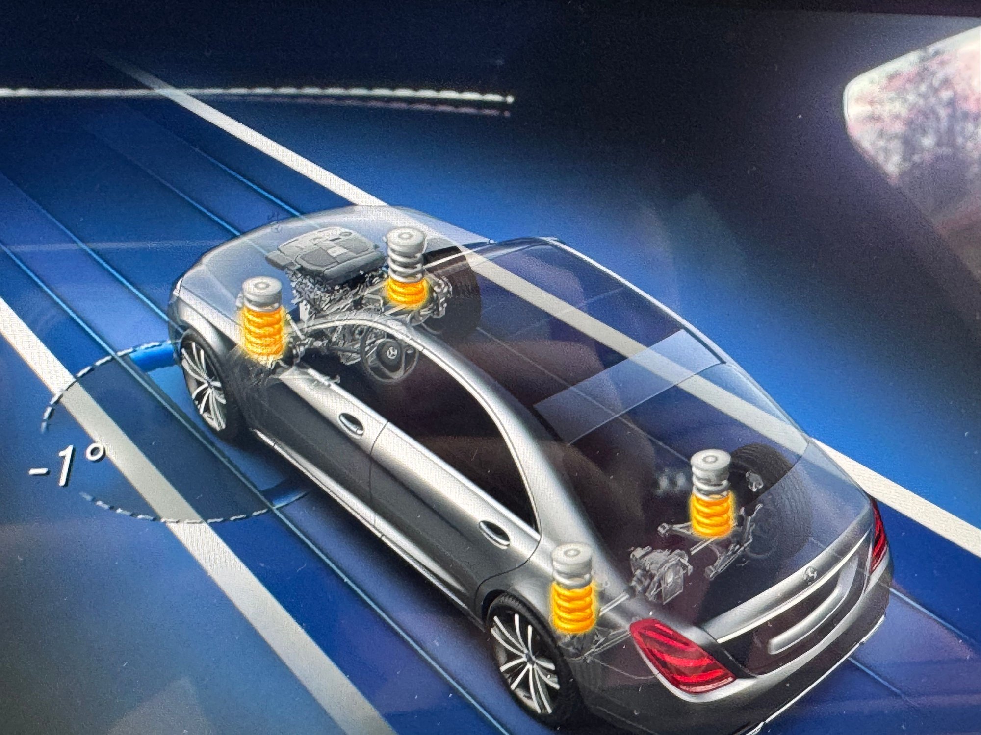

When i drive the right side of the car is always lower than the left. Anyone who has experienced the same thing?

That is not lower, that is force intervention. But yes that is not normal unless you are of a very heavy construction.

Do you see the same as I have posted in the picture if you find that menu in the car? You can see in the photo that the right side of the car has more load

No, sorry., not familiar with that screen

You go to «car» and then «cardata»😊

This is the normal state with one person in driver seat.

Mine is the same as yours when I'm standing still, as soon as I start driving it's like I posted in the picture

That is the same state you should see driving straight in level ground while coasting.
You might have an accelometer issue, best bet to get diagnostics to look at actual values of inputs.

Does the level change when driving? On mine, I occasionally see the yellow drop a... coil? line?... or two, for less than a second at various corners. Usually happens after a bump or road imperfection.

Mine is like in the picture as soon as i start driving. Allmost full yellow at the left front and barely nothning on the right. In corners and bumps it drops as normal

The workshop has now changed the level sensor on the left front. I can still see that the load changes in the dynamic select menu as soon as I start driving. It looks normal until the car starts rolling. Then it jumps down a few levels in the dynamic select menu.

Here I first stand still, then I start driving and then the level immediately drops. This is on a completely flat concrete surface.

Again that is NOT lower.
That is higher force intervention attempting to raise that corner.
Actual values need to be reviewed on why the system sees the need to push to raise that corner.

I know its not lower. But you can see in the video the force intervention drops on the right side as soon as the car starts rolling. How is yours when you start driving? Does it change as mine does?

No, it will stay the same while driven on flat, even pavement.
Something is off with your system, the force intervention is too high on all corners as well as the discrepancy side to side.
