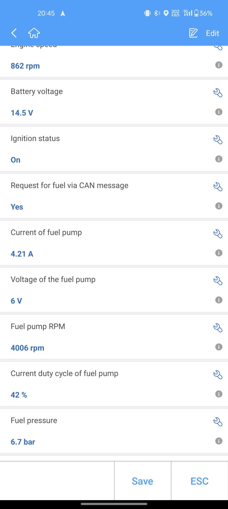

Just bringing this back after a while, Still having the issue even after replacing my fuel pump
When the engine is running, I'm at 6.7 bars of fuel pressure. When it's off for 20 seconds, it drops to 4 bar, and 20 seconds later, its' below 2 bar.

I agree that I am starting to suspect the injectors, however once fuel pressure reaches 6.7 bar, the engine runs completely normally. I never have a misfire, plenty of power, etc. No engine codes at all.
Possibly I have a leaking injector, but how to tell which one? I'd prefer not to pull/replace all 12 of them because it's probably just one failing, if it is leaking
