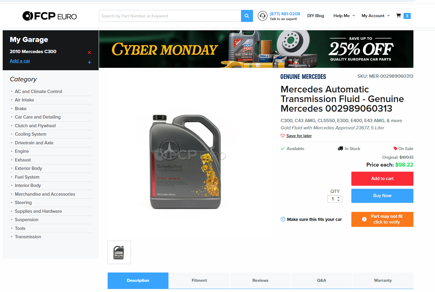

I looked and the 9-speed uses the 236.17 atf fluid. A 5l jug of it is $105.82 from checking online at my local MB parts dept and FCP has it for around the same price. Figure 10l for a fluid change thats $200 just for fluid. Then FCP sells the entire kit for for $388 on sale.
So I would question the $400 job, what is exactly included? The $1,800 at the MB dealer sounds about right or even cheap, my local MB dealer is a rip off and shady. They recommended all types of work, one thing was $300 to replace the air filters and I kid you not I had just replaced them not even a month prior. Another thing was $2,000 for a rear brake line which I replaced myself for $100 in parts and a flaring tool.

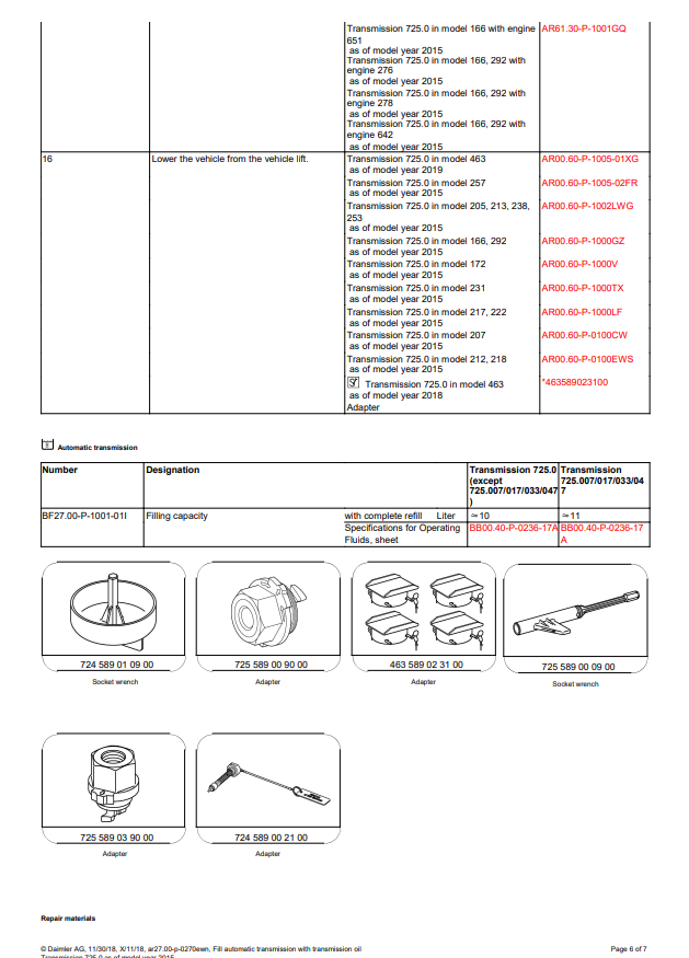

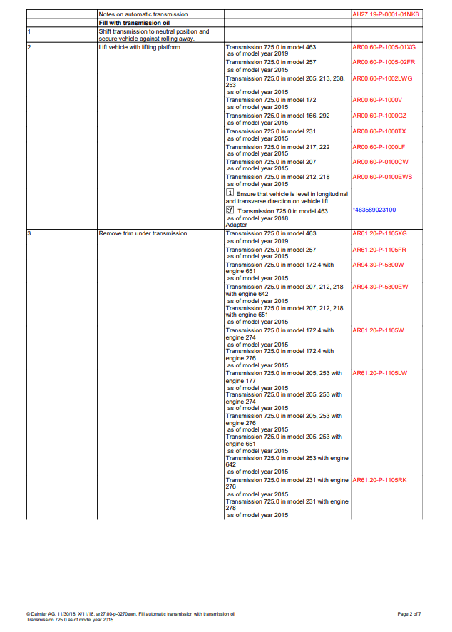

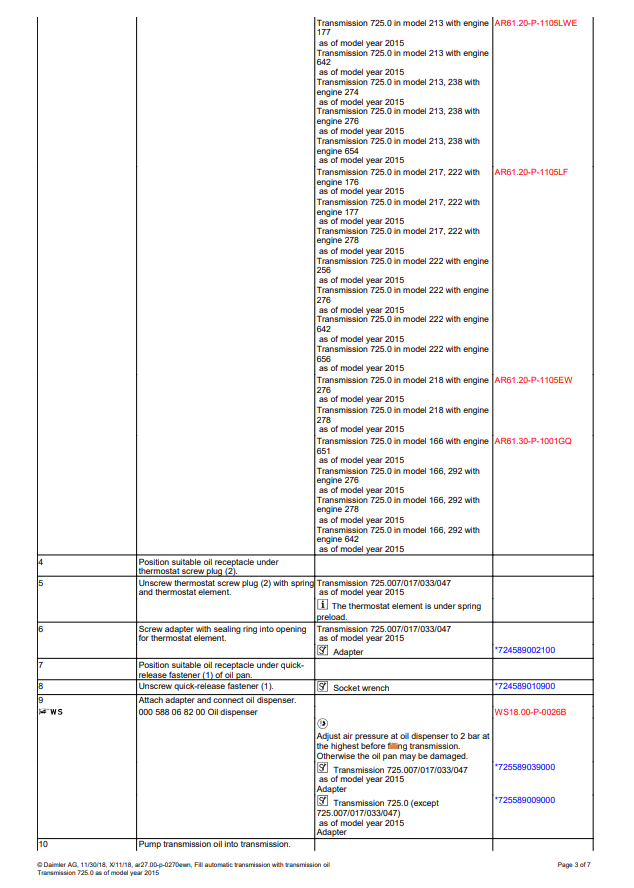

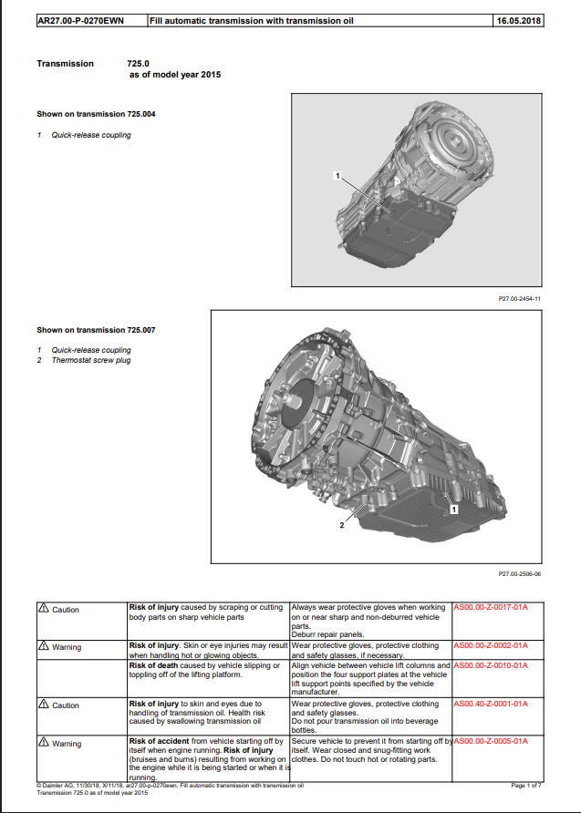

From reading thru the instructions the 9G seems a bit more involved than the 7-speeds. Different adapter and two options for setting the level.
And if its the 725.017 it looks like fill capacity is 11 Liters.

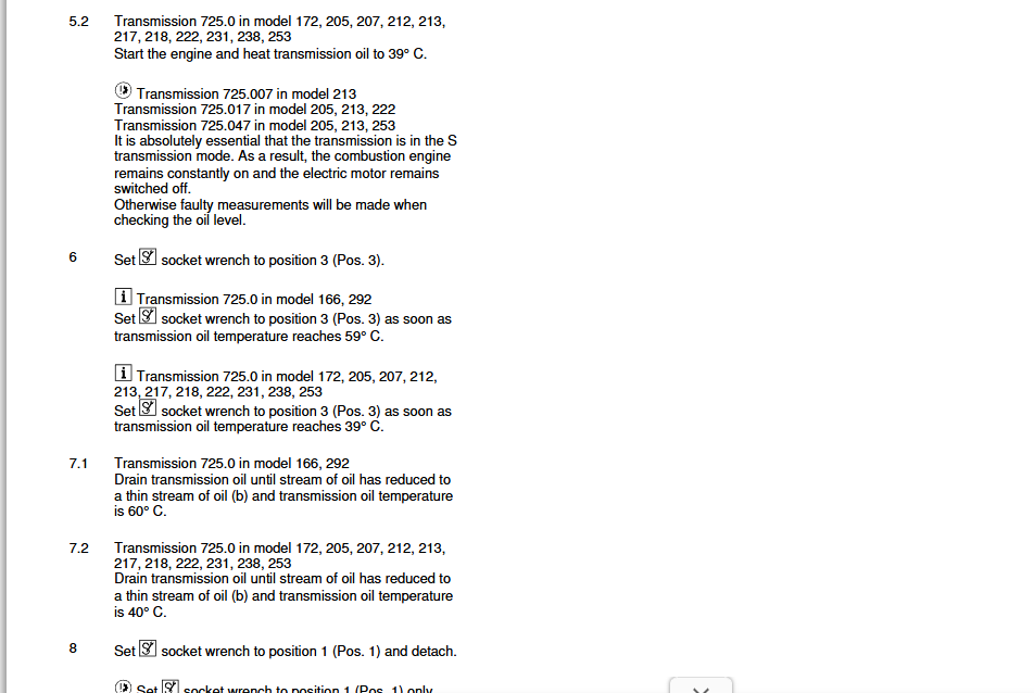

yes its listed in the other procedures.
Heres just a snippet of setting the level using fluid temp:

Thanks for posting this!! I assume you ave access to WIS. Great resource!
