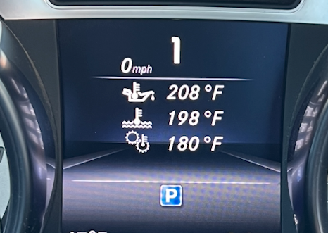

Maybe the flashing brake lights during sudden stops? I understand that it is only during emergency or sudden braking and not all the time. I think you have to be going faster than 35mph/60km/h and stop quickly. There are YouTube videos that show what it does.
The AMG menu provides lots of good information and well worth it. It shows oil and coolant temperature (an maybe transmission temperature on certain models) with the speed and gear selection, a lap timer, and the status of the transmission selection and suspension selection.

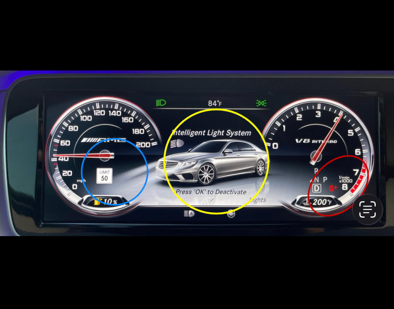

I found a picture of the AMG menu.

Anyone know how the full AMG conversion differs from the AMG additional menus only?

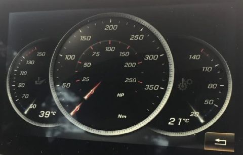

BenzNinja also offers "DIGITAL GAUGES" which display engine data on the center screen of your S550. I've got it on mine.

If Peter can give your dash the AMG cluster for pre-facelift cars it is worth doing. I enjoy seeing the engine oil and transmission temperature.

Still on the fence about the AMG cluster. Seems there are a few options: 1) Head Unit AMG Design 2) Head Unit AMG Digital Gauges 3) Add Full AMG conversion
