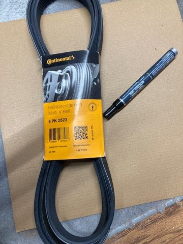

If anyone else is looking for a belt, here's a nice new Continental I bought for my S550 (2016, RWD, M78) and did not use. Love to find a home for it, give a PM if interested ...
