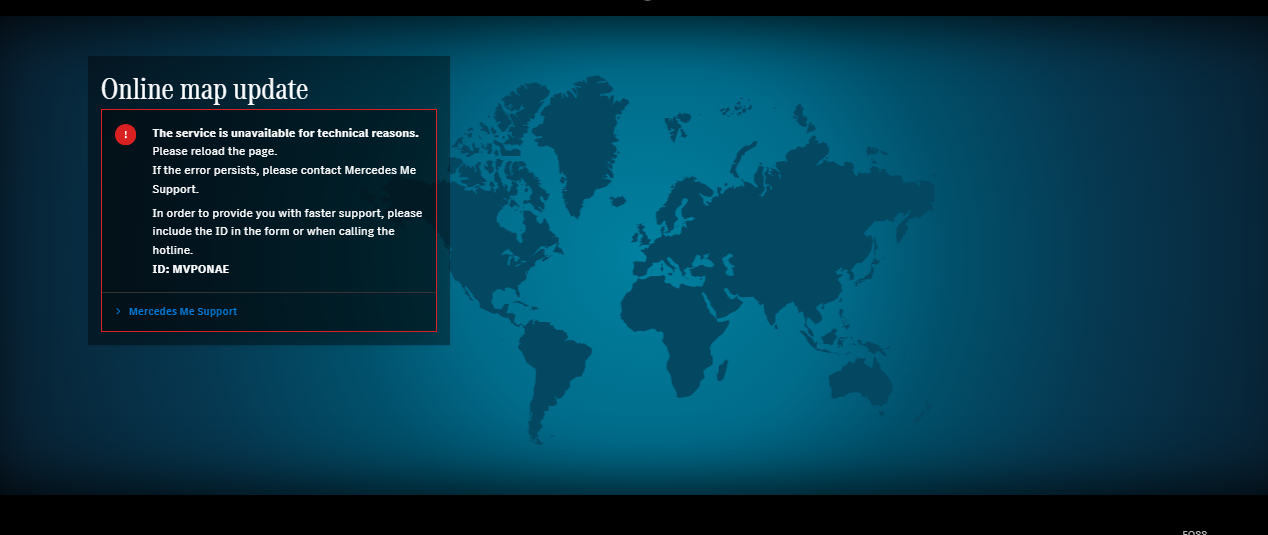

Unfortunately, I am still receiving this screen after logging in and clicking on "Update Map"....CAN ANYONE HELP ME ADVANCE PAST THIS SCREEN?
