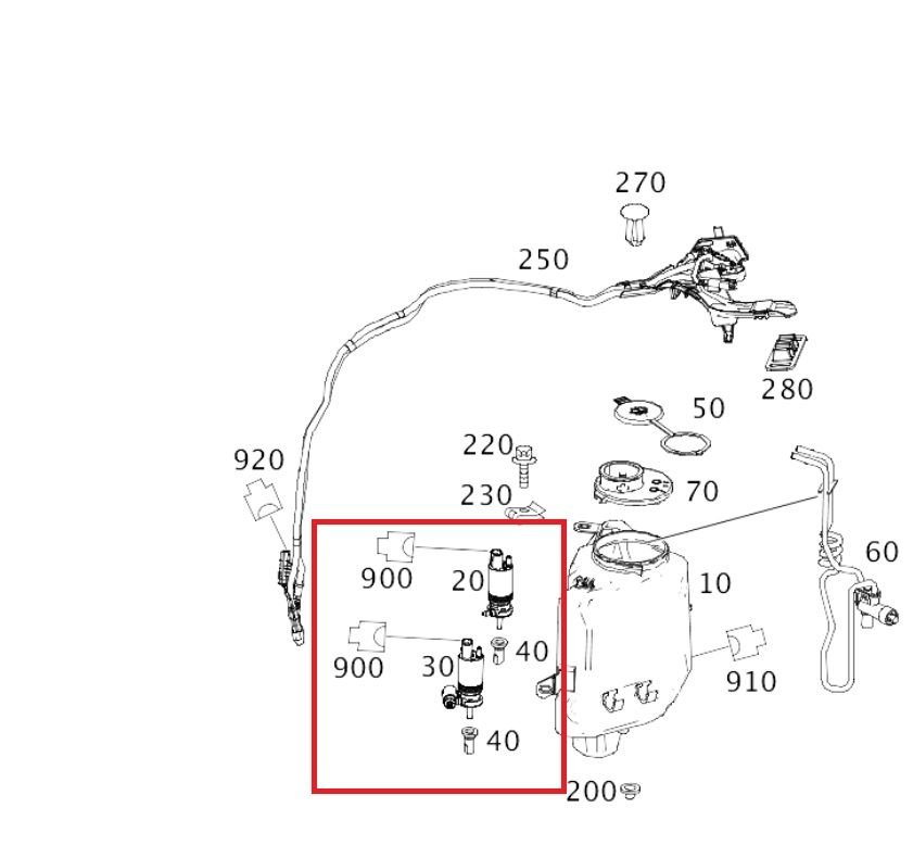

I don't see check valves either for the magic wiper version as I have on my car. What I do see is two pumps. In the past I would assume that the 2nd pump would be for the headlight washer system, but I have no such thing on my car. If you're curious it's option code 600.
Here's the Xentry Parts diagram showing the two pumps, #20 is the Centrifugal Pump at Liquid Tank (A2318660121), #30 is Centrifugal Pump at Winshield Washer (A2318660021). Both use the #40 Formed Grommet with the screen in it (A0019987301).
If you look for a photo of part #250 Hose Line to Reservior (A2228607300) you'll see it has two lines that go to the washer fluid tank, one for each pump.

I believe you are reading the diagram wrong.
I think there are two different (alternative) pumps.
One with a single outlet, and one with two outlets.
My cart as the single outlet, but FCPEuro sent me the wrong one.
I wonder if the check valves are non replicable due to the electrical (heaters) in the lines?

I see that double outlet pump now, the Xentry Parts does show both as applicable to my car, but I have no 600 pkg ot night vision installed. I'll be updating the hoses.pumps, etc. soon so I'll let you know what I find out.

You are correct in that there are two different pumps.
The pump with the dual outlets is for the Magic Vision windshield system.
The pump with the single outlet is for the Night Vision camera lens.
So if your car has Magic Vision and Night Vision, you will have BOTH of the pumps installed at the bottom of the heated washer fluid reservoir.

That's strange due to the Magic Vision requires two fluid circuits to operate as designed. Each wiper has dual hoses to spray only in the direction of travel.
Look close at the diagram above and you can see there are two hoses bound together (part #250) running up from the pump to the valve assembly.
Here is a partial page from WIS that shows the two separate fluid lines coming from the washer pump. I added the blue/red dashed lines to show the two circuits.

No need to wait for disassembly, just look at the hose(s) coming up from the pump next to the fender.
If you have Magic Vision, then there will be two hoses. If you have two hoses, you have a single pump with two outlet ports to connect the hoses.
Can't have two hoses with a single outlet pump. Let us know what you find out.

Well I feel like an idiot.
I just looked looked part number for the pump FCPEuro sent me (and I returned).
the pictures from several sites show a single output.
So that means my pump has two.
