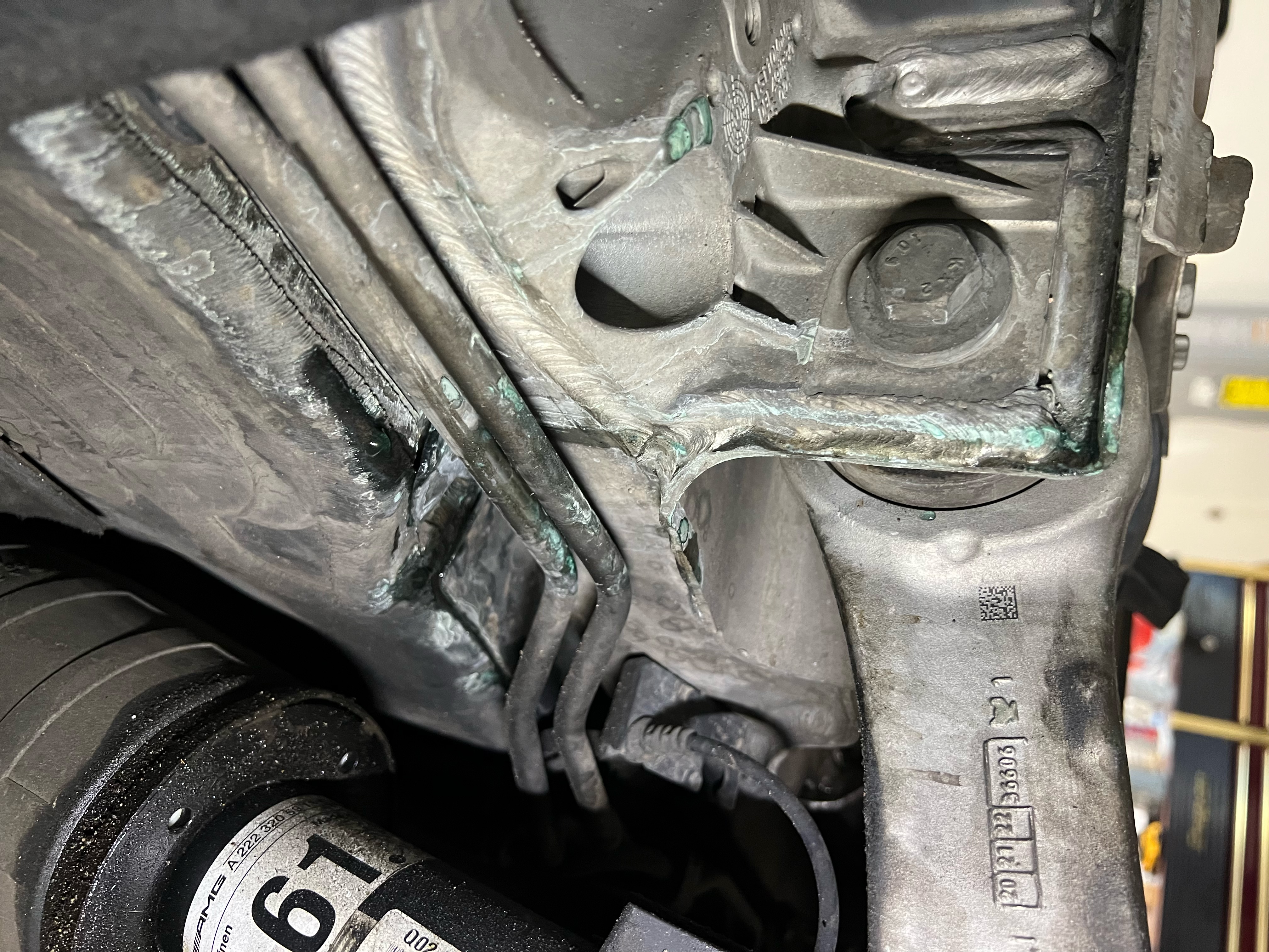

Guys... My 2015 S-65 is dripping blue coolant from the driver’s side frame rail while running.
No coolant leaks under hood.
No coolant hoses I can see on driver’s side.
Charge coolant is pink so not that.
Thoughts?
Attached Thumbnails Mystery coolant leak.-9a40e50f-4dda-4284-9ea6-5a5b3084a5f1.jpeg

Engine rear to firewall - there are hoses....they break (mine did). Not sure about your engine specifically but my coolant temp sensor was back there as well...and leaking.

Coolant is a darker color than washer fluid and it tastes sweet. I compared on paper towels.
Trans oil is blue but doesn’t feel like this on fingers.
Also.... drips when running.
No coolant lines on driver’s side. Zero signs of a leak at the engine. No scent of coolant under the hood. I can smell hot coolant every time under the hood.

Went to some effort at exposing things. All plastic off top and bottom. See nothing at base of windshield or moving down driver’s side.
I have it on the hoist and am clearly missing something.

Looks like the shock absorber is damp so maybe oil from ABC suspension?

motor mounts?they drip blue when they go...

ABC/MBC oil is amber in color. Yes; I get to wipe the left front strut with a paper towel when I have it on the hoist.
It is leaking from the chassis right next to the strut.

Zero leaks on engine. The Goo that comes out of engine mounts is a very different color and not coming from mounts that I could clearly see with the car on the hoist and all plastic removed.
This one is quite the head scratcher.

If it were me I would clean the area as well as poccible, even if only from the top. Then drive for a short time, slowly so that things don't spread out as far, then come back and get it back up on the lift to see how things look.

Did that last night Carlos. Fresh drop hanging from same spot tonight after commuting to and fro.

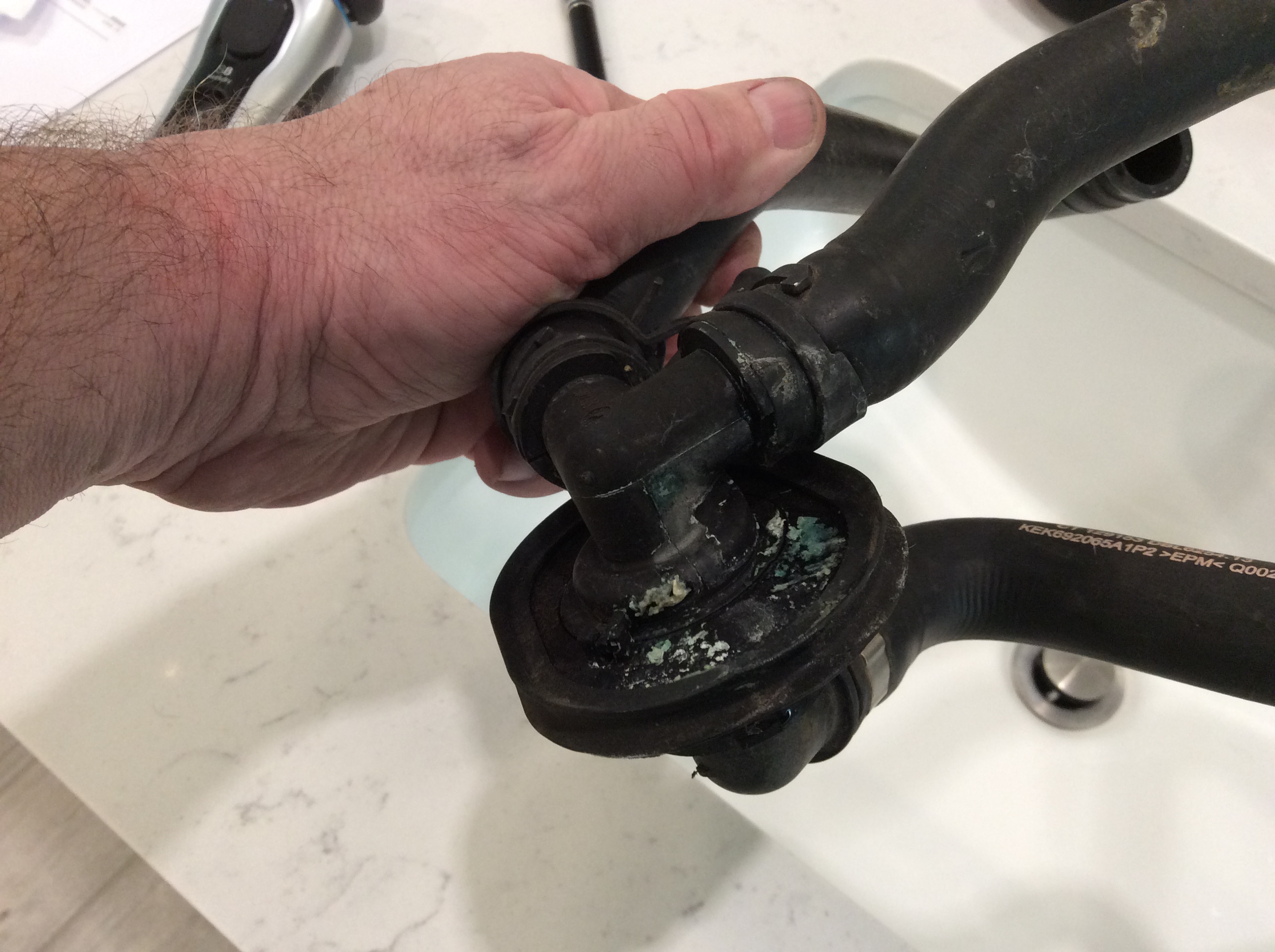

Mystery solved. Pull all plastic at cowl. Crane neck whilst shining flashlight and hold mirror..... The plastic guy that goes through the firewall and feeds heater has a hose on it that is leaking. It runs down to the driver's side and ends up pooling in side the chassis at L/F next to the strut. Not an expensive thing but sure looks like a treat to replace. I have a Saturday project. Woo-Hoo!
I have felt your pain - LOL -
Keep your soldering iron handy to melt out the broken bits of coolant pipe in the engine...in the tightest, hardest to get to place ;-)

Replaced hoses and plastic bits. The guy that snaps into the firewall had developed a hairline crack on the cowl side of it. That assembly arrives with two hoses. Also replaced hose that clips into the plastic guy and goes to the pax side head. Pretty tight on the back of the engine and in the cowl. Cut my big meat hooks up pretty good. Three hours of effort start to finish. Zero drama. Nothing broke. Things are tight in there so getting to clamps was a treat. Worst was the hose on the head. I’d have the guys at the dealership do it, but not for the nine hours of labor they quoted.
