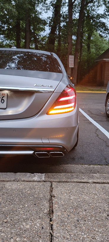

This isn't accurate. Plenty of US cars have amber rear turn signals including MBs, my S580 has red LEDs that turn amber when they flash:Originally Posted by carlosinseattle
But the reason we don't have the amber is because of some US regulation. Same bulbs just different coding.
Not sure why MB chose to have amber turn signals on the US W222s but US regulation isn't why
