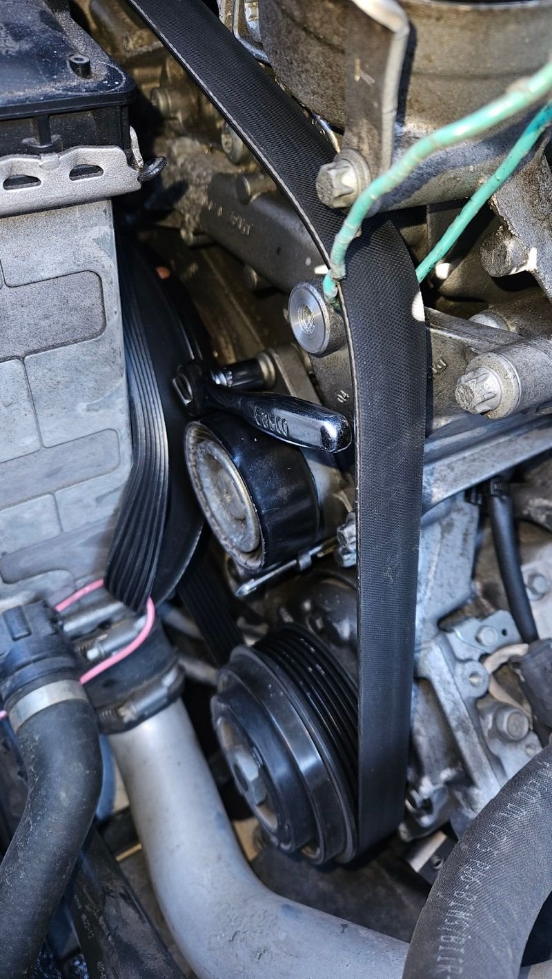

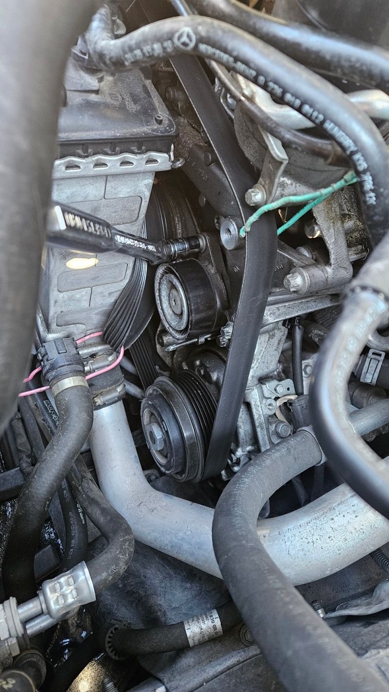

The Mercedes M276 engine in our 2019 S450 twin turbo V-6 with 54K miles was making quite a racket after it warmed up at idle. Rev the engine just above idle & the rattle sound went away. Traced the noise to the Idler pulley assembly on the front of the engine with a stethoscope. Seems the Gates OEM brand internal spring rotary guide bushing wore out? The pulley bearing appeared good still. Good news is that I replaced the belt tensioner without having to remove or loosen the water cooled turbo inter-cooler.

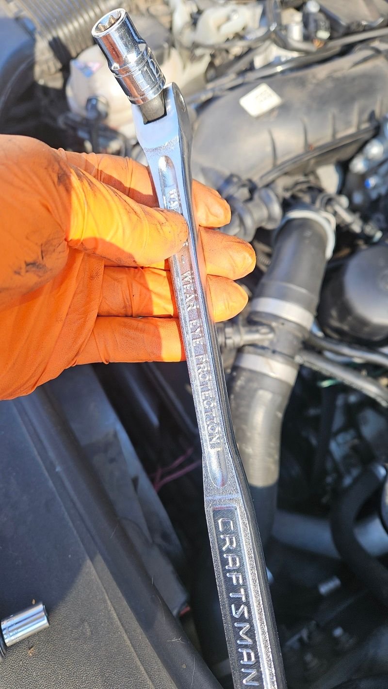

Started by relieving tension on belt tensioner and stuck an 1/8" drill bit in the "holding hole." I tied back the rubber belt in two places with solid wire in such a way as to keep the belt out of the way yet still with some tension so it stays on the other accessory pulleys on the engine. Then removed the belt Idler pulley directly above the belt tensioner pulley to give even more room to wrench. Having many wrench & socket options on hand is key to fit into the tight area behind the inter-cooler.
AutoZone had the belt tensioner and idler pulleys in stock at my local store.
Duralast #305723 $44 USD "Automatic Belt Tensioner."
Duralast #231015 "Idler Pulley" $33 USD (both idlers on the engine are the same part; the one above the tensioner & the one behind the turbo cooler tank) I'll attempt to replace the latter next
Just wanted to let you know that this Belt Tensioner replacement procedure can be done without touching the inter-cooler that at first glance, looks formidable.

Thanks for the tips. Our W222 factory belt tensioner (Gates brand) started to fail at 54,000 miles or 86904km. I did re-use the factory #1 idler pulley centering spacer ring. So far so good, but I agree, the plastic centering piece was a bit of an un-welcome find.
Both our USA spec '18 E400 Cabriolet & '19 S450 idlers vibrate normally as they do their job. Seems to be a high internal wear item always adjusting belt tension as it does. I could see that the old tensioner's two part aluminum castings were slightly off-center with each other while the new one's were centered.
