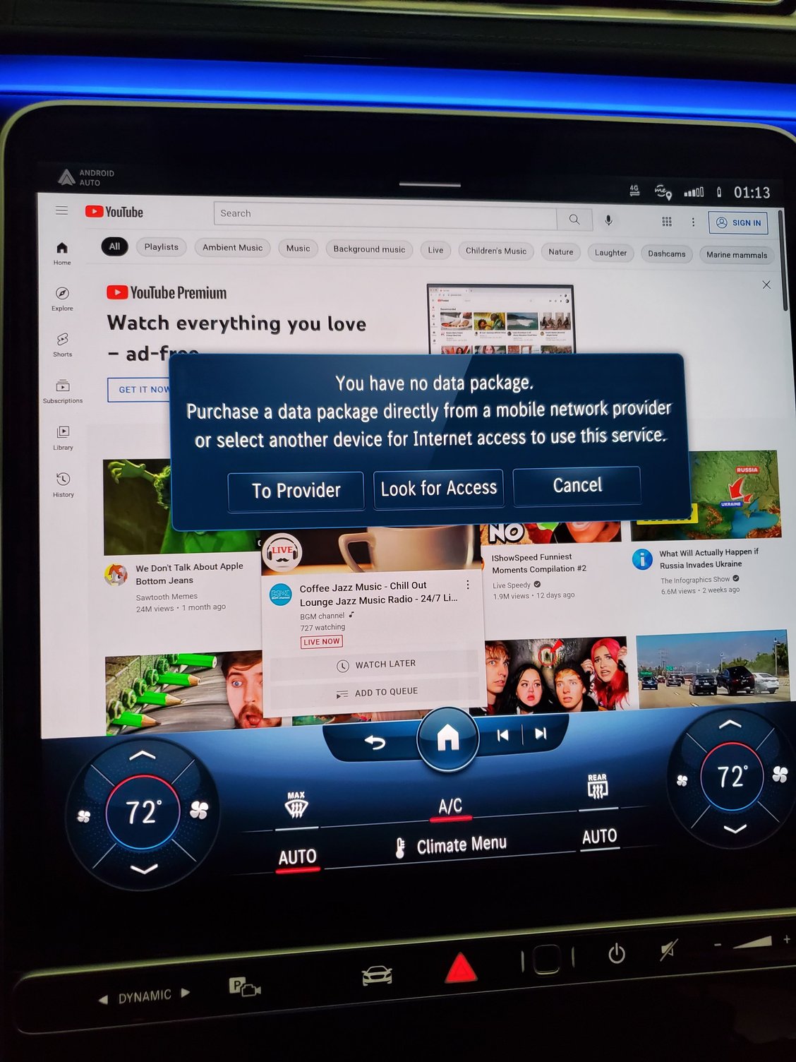

Same here, got some decent experience with networks. MBUX somehow doesn't route wifi traffic to the internet. I need to go in the car with my laptop and see if I can dig up more things. I just thought someone knew of a setting somewhere in MBUX that I may have glossed over.

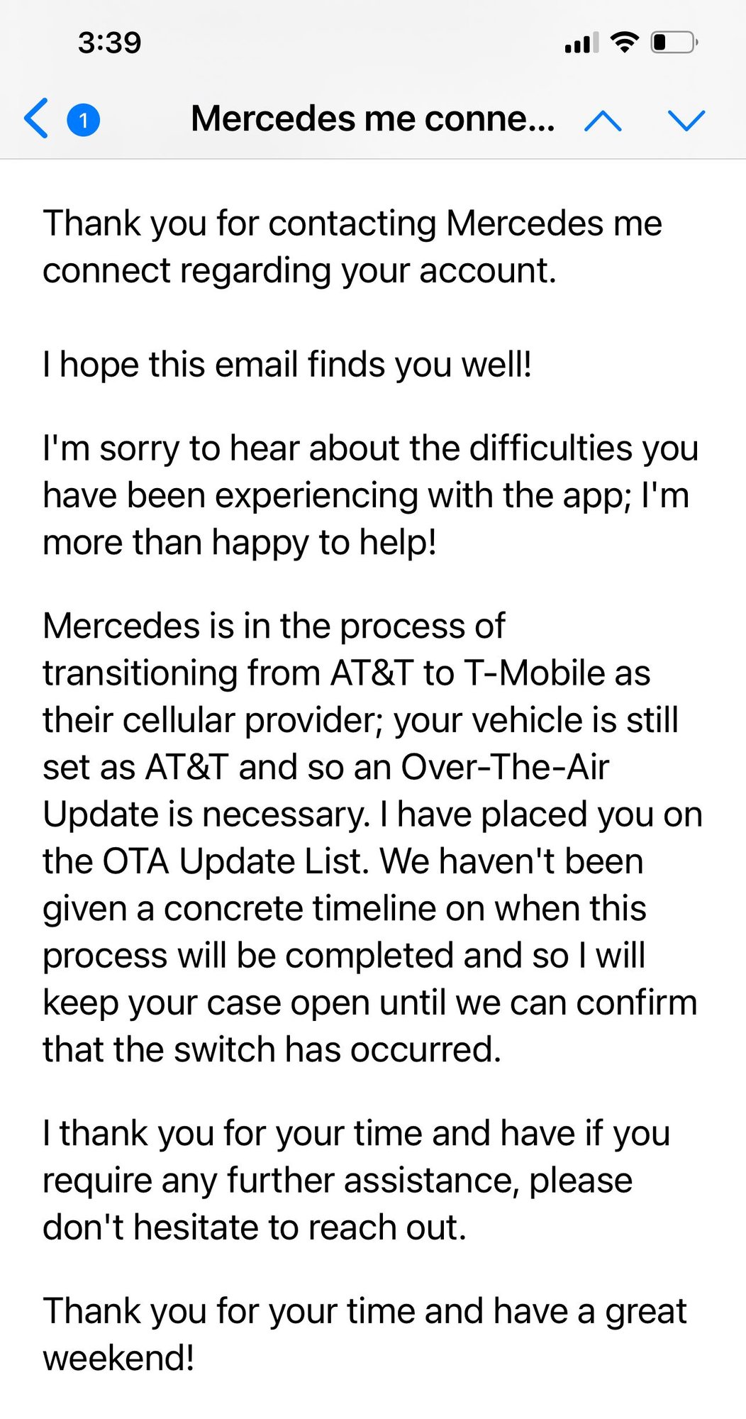

Just got the S580 back from Mercedes service (Wi-Fi & cluster display). Apparently most cars are being migrated to TMobile but some will stay with AT&T. Mine should kick on in a few days and be available for direct purchase in late March. I’ve attached the printout. They finally created a PTSS ticket which is an engineering ticket/case. Seems to be the only way to get real traction….this is such a clumsy interaction.

Adding on to the thread. As a dealership employee. I have had numerous clients reach out to me about the Wi-Fi services. And us as the dealership have no source of acquiring the information to assist. It is truly unbelievable that we are unable to receive an answer on why this is happening. Especially with the S class/Maybach's where this feature is extremely utilized. I have 5 clients I am working with currently.
I am in contact with the Mercedes-Me Operations team, and with the T-mobile providers themselves. They only answer I have received has been there may be a missing module on certain models. But no specific information on what may be missing.

I spoke with Mercedes Me Connect in an attempt to obtain a data plan. I was told the ATT walled garden needed to be removed via an OTA update and given a case number. That's all they could do for me. Basically "shut up and go away". Very disappointing and surprised they haven't figured this out.
