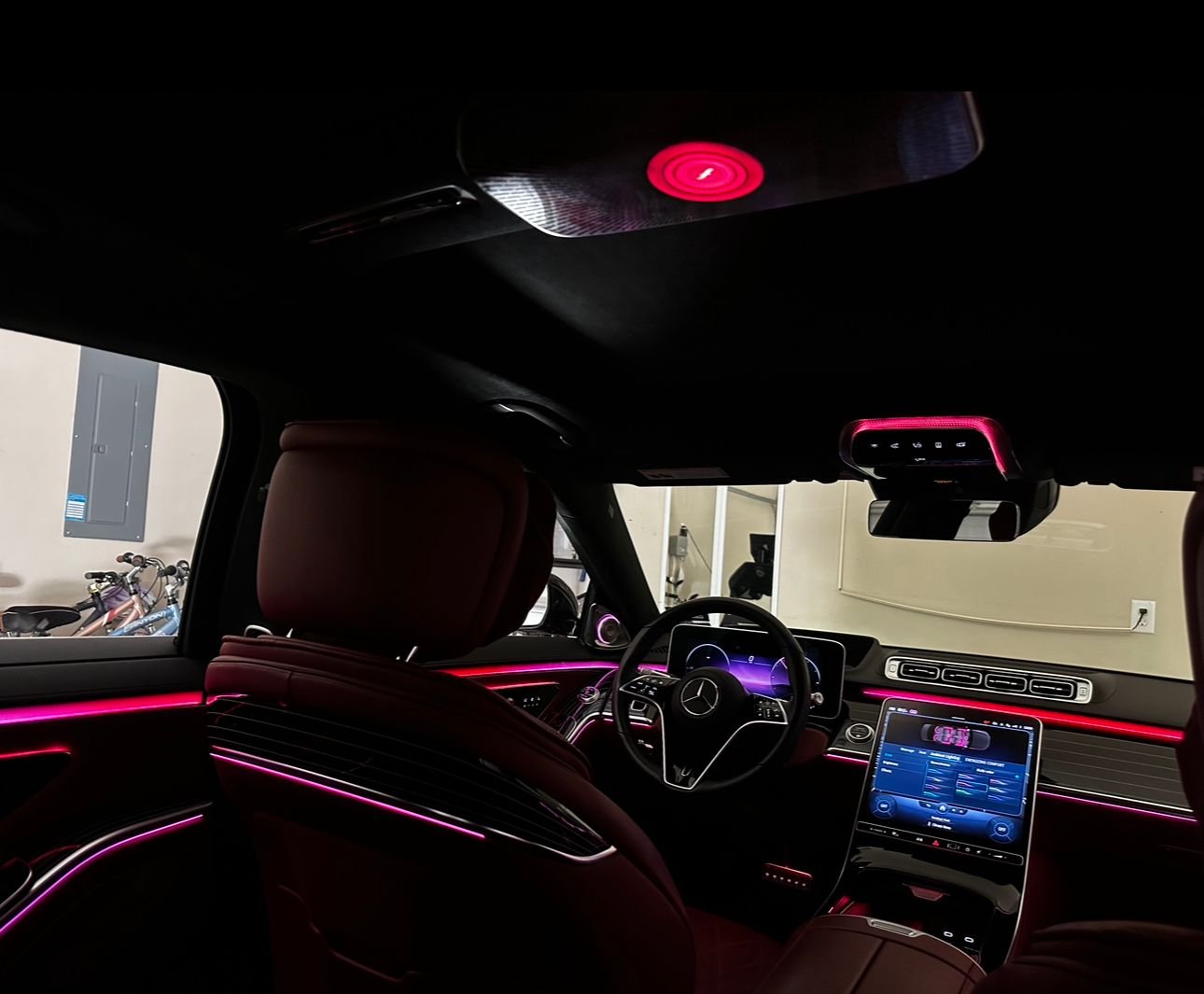

No.. I’m guessing the 2021 ones just don’t light up. However I ordered one with ambient light from a Chinese company and installed it myself. Now I have one that lights up. I posted pics on this forum a few weeks ago.

I have the active ambient light and it works just fine. I don’t think it has anything to do with that. I’m thinking they just didn’t have that option for most 2021 models maybe had something to do with chip shortage?

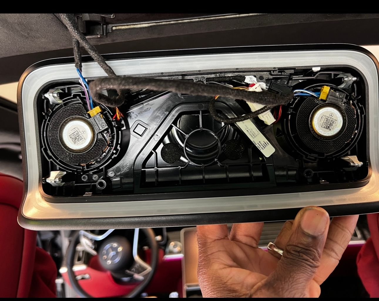

I replaced mine with one I ordered online that has the ambient light. When I removed the original one, it looked like it has the lights in it and was wired to light up. No idea why it never did. Anyways, I like the one I replaced it with. It was tough to install, running the wires all the way to the passenger side front footwell light. But it was worth it in my opinion.

Nov 15, 2022 | 10:54 PM
[QUOTE=Oriolnyc;8669611]Can you share with us the exact item that you purchased and what is needed for oem operations.
Here are pics from mine.
Reply 2

Interesting. In terms of lighting alone, I think you actually got an 'upgrade' here over the OEM burmester 4D - the OEM ceiling speaker most certainly does not have the illuminated central circle

Regarding towards the ceiling speaker, the outer edge is supposed to illuminate and unfortunately it isn't. On the 2022 they have it to were it have a circle center to light up. Now for the table I have the entertainment pkg, so the table and the screen are in tandem with one another. I'm quite surprised that you do not have the monitors. And yes the tablet can change certain things throughout the vehicle, both front and rear. Hope that helps

Yes and No.. it’s prewired for the speaker but the wire for the ambient light is not compatible with the speaker ordered even though there’s another wire that seems like it should be for the light. You will have to use the wires supplied in the kit and run it through the side door panel to the front passenger side footwell to connect with the footwell ambient light wire.
it’s a little complicated but if you ever get it I’ll be more than happy to walk you through the process.

S580 W223 Ambient Roof Speaker!!!! Finally resolved.
Heyyyyy friends, finally after 2 years of stressing over on finding out what to do to have what initially was supposed to be offered from the launch of the S Class. Today it's installed and working as it should.
If you're interested in doing this, just Google the Ambient Roof Speaker for the S580. You'll see quite a few ones available ( more than likely from the same distributor). It'll take a few weeks to arrive, but once you have it, the install isn't really too difficult for a decent audio installer to complete the work. They range from $350 - under $600. FYI I took the liberty to record the entire instalation on YouTube. It will be under the same tag ( 2021 Mercedes Benz S580 4MATIC Executive Line Pkg/ Ambient Roof Speaker instalation. If there are any questions please feel free to ask. I'm so happy.
