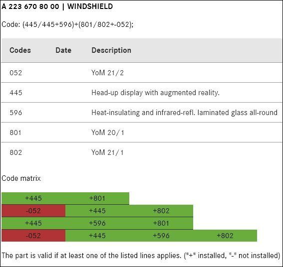

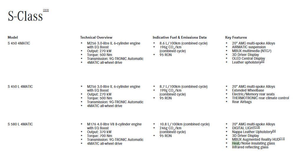

I did find a specs page but there the ''heat and noise-insulating acoustic glass for front side windows'' was only for the S580. This is how it has traditionally been, standard from 500 onwards. Usually an option for models "less than 500" though.
Can you help me with the Australian MB site. I cannot find any proper price list (including accurate option codes). The configurator does not seem to cover heat and noise insulating windows, not as an option, neither listing it standard.
https://www.mercedes-benz.com.au/pas...ions-10-21.pdf

Here is the download link for the brochure pdf for MY 2022 S-Class. Pages 3 and 4 list 'Standard Features' for the S450/S450L/S580L (All 4Matic).
@MBOZ84 should ask the dealer, would be interesting to see their response.
Interesting. Actually the page I referred lists "key features" which means that this page is not in conflict with the later, more detailed page. In my country and in Germany 596 is standard only from S500 upwards but for Australia it could well be standard for all models (considering the very hot areas of the country).

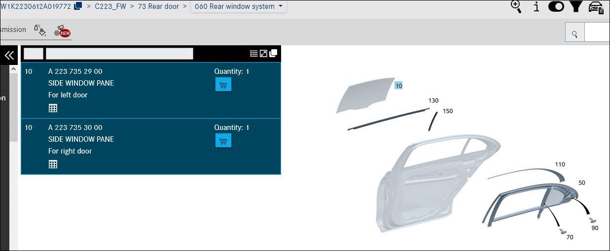

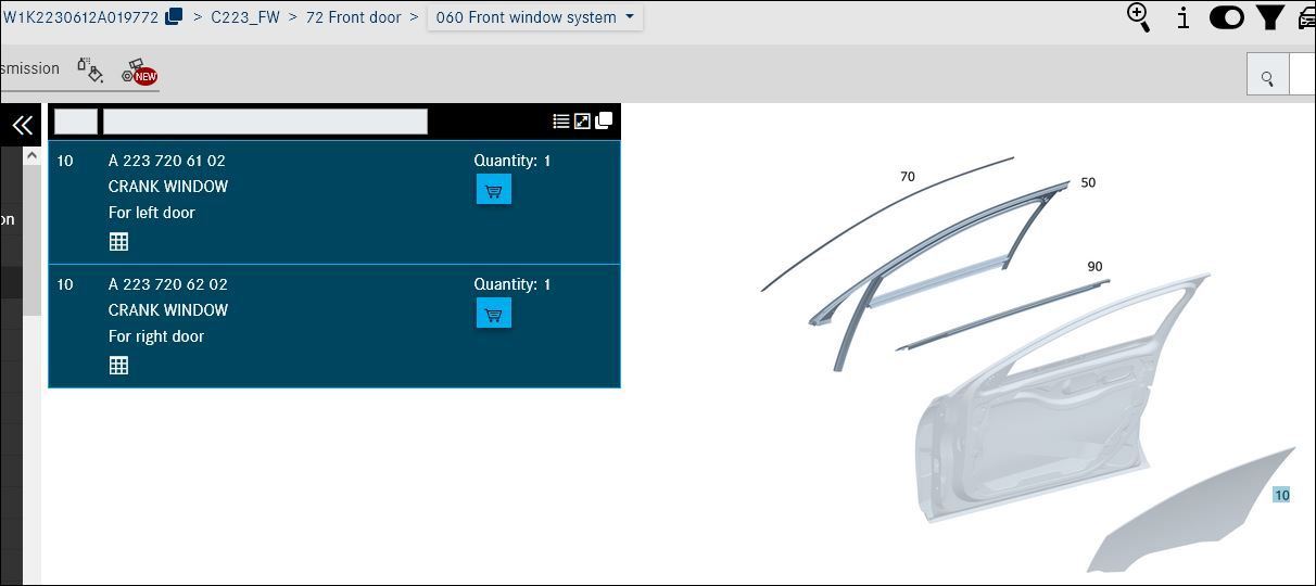

If it were just a mistake in the specs sheet, they should have had the heat and noise-insulating acoustic glass for front side windows an option at least.
It's listed as standard fitment and if it weren't you would reasonably expect there to be an option to fit it. That said MB Australia is EXTREMELY poor in what they allow us to option and how we can customise our vehicles, so it doesn't surprise me it's not a standalone option on the spec guide.
It's a very interesting situation. Could there be a batch of Australian W223's built without the acoustic glass they are supposed to have?
