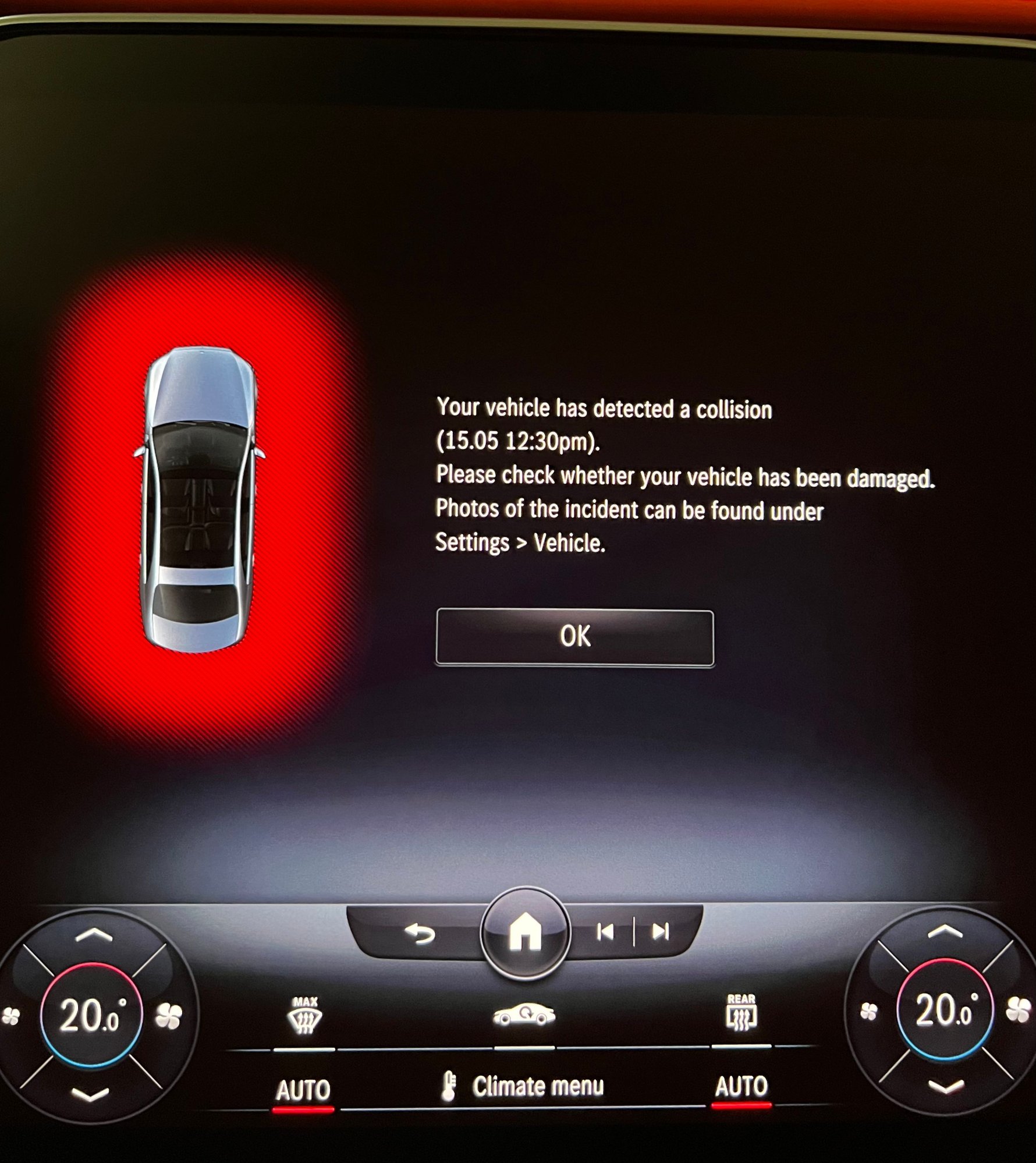

What an interesting coincidence for this post today. Just this afternoon I entered my car after parking in a public parking lot and got the attached message. First time it has popped up. I immediately got out to check car and thank God it was a false alarm. Also, no photo was (auto) taken. Maybe someone just bumped it with their body? Parking spot was a bit tight

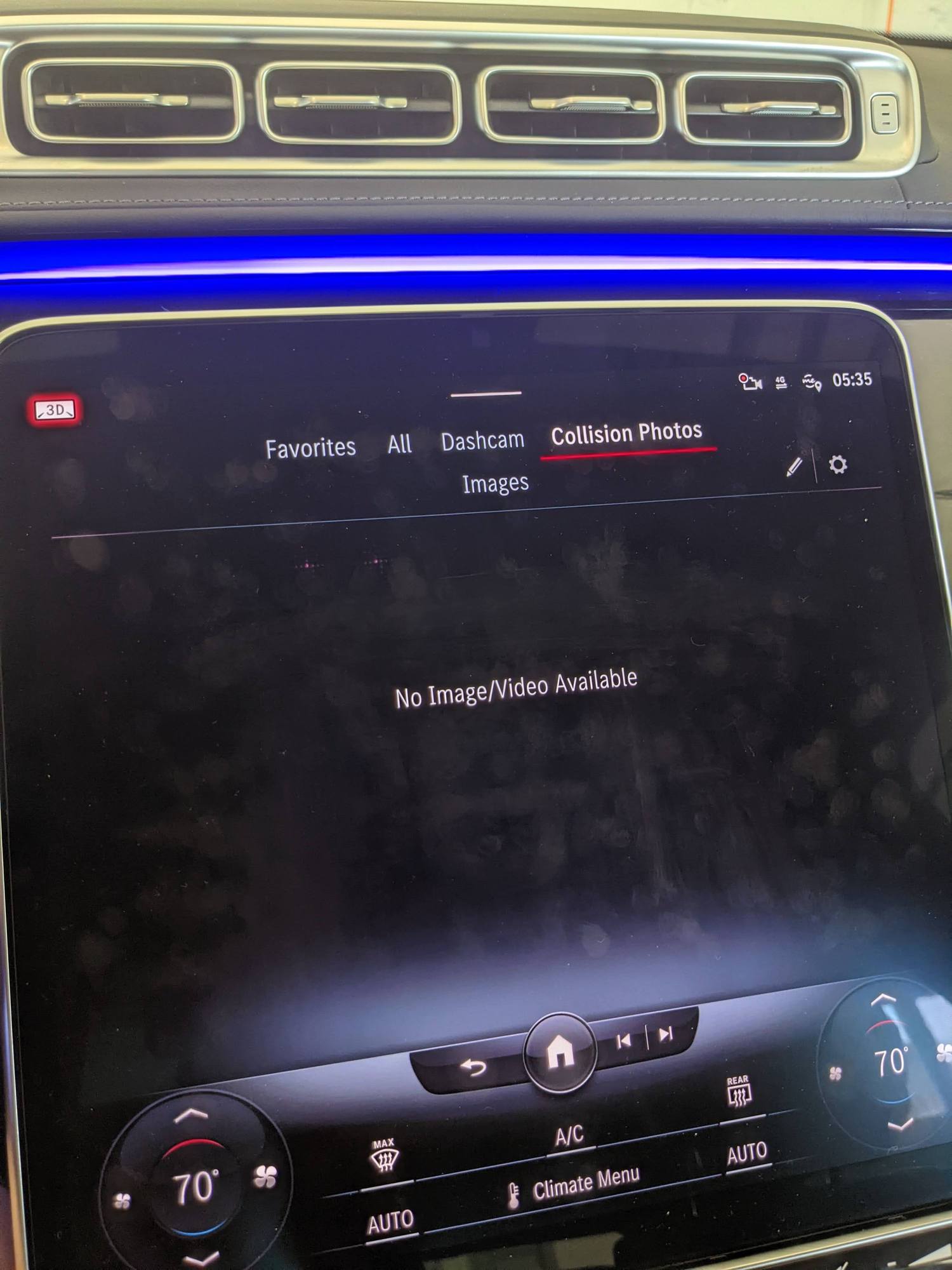

aah, i think the software on my mbux is updated from the one shown in the demuro review (first photo in this thread).
cuz i found the collision notification controls under a different section of the menu...
Vehicle > Open/Close > Vehicle Protection > Collision Notification
if any others also need help finding their way thru the labyrinth, as the user manual is detailing the prior OS.
