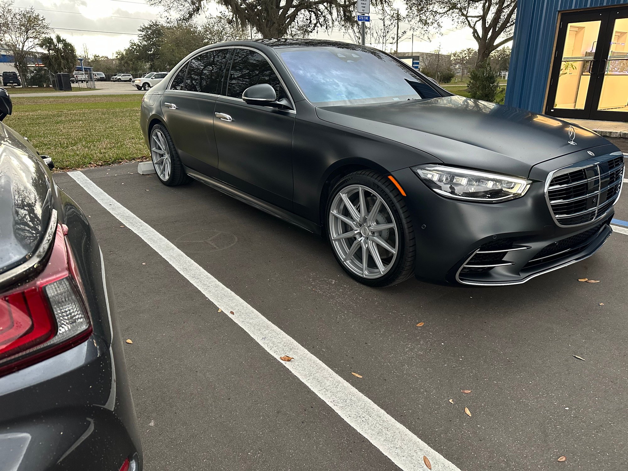

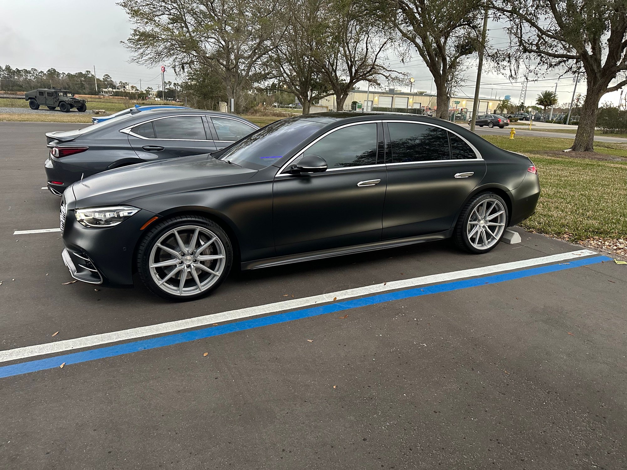

Old Feb 12, 2023 | 08:58 AM
Agelai's Avatar
Joined: Dec 2022
Posts: 34
Likes: 16
From: Florida
2022 S580
Old Feb 12, 2023 | 10:29 AM
hyperion667's Avatar
Posts: 31,273
Likes: 3,916
From: on my way
2012 CLS63
Damn looks great, a little high sure, but that matte color and wheels look fawking great
