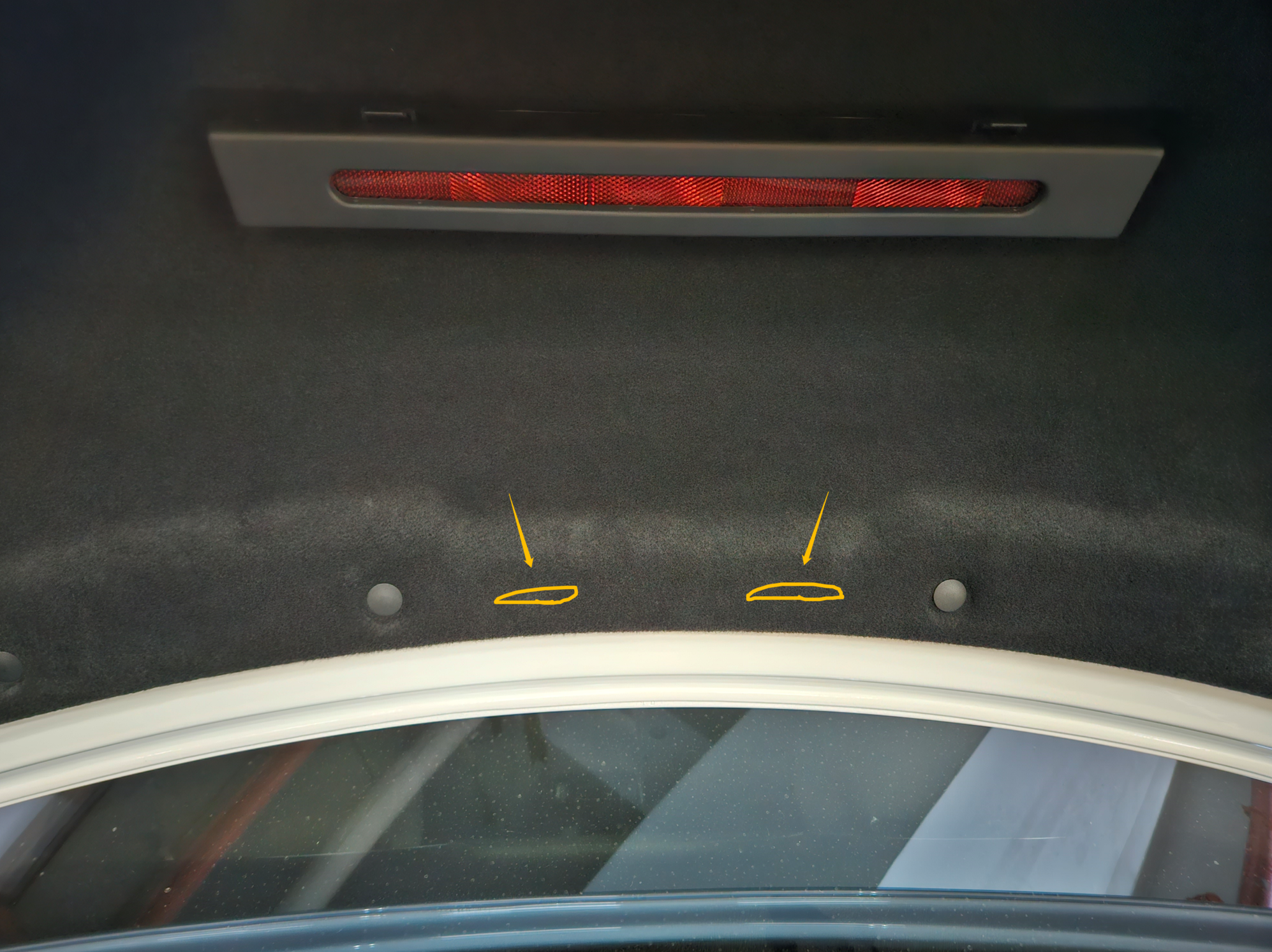

Just lifted the lining in my trunk to check. Yep, mounting holes for the umbrella holder still there, as was the case in W221 and W222. Definitely looks like the same mechanism.
I'm gonna order the same set used by those W222 owners, and attemp a DIY instllation myself
And while I was at it, I also discovered, for the first time, that my car trunk had a built-in traffic triangle... Well, good to know.

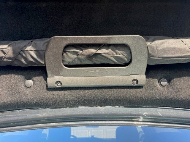

Job done. Bought the components from my dealer and had them do the install.
That is one freaking solid umbrella holder I mean, just listen to that thud...The first time I heard it, I was like 'Whooooa!'
I am not used to seeing such outstanding build quality in my s class. Thought it was gonna be just as flimsy as all the other plastics in the interior.
Anyways, part numbers I gave my dealer:
Umbrella Clip # 2218101214
Treenail (x2)# 6399980185
4.2x25 Screws (x2)# 000000000525
All five components added up to less than USD 50.

I have a 2020 S560 and purchased all the parts mentioned. When I look at the umbrella holder, on the back side it has 4 feet/legs that look like they need to slide into "slits" in the trunk lid. Are the slits prepunched in the trunk lid, in addition to the holes for the plastic captive nuts? I have attached photos of both sides of the holder.
trunk side
visible side when mounted
