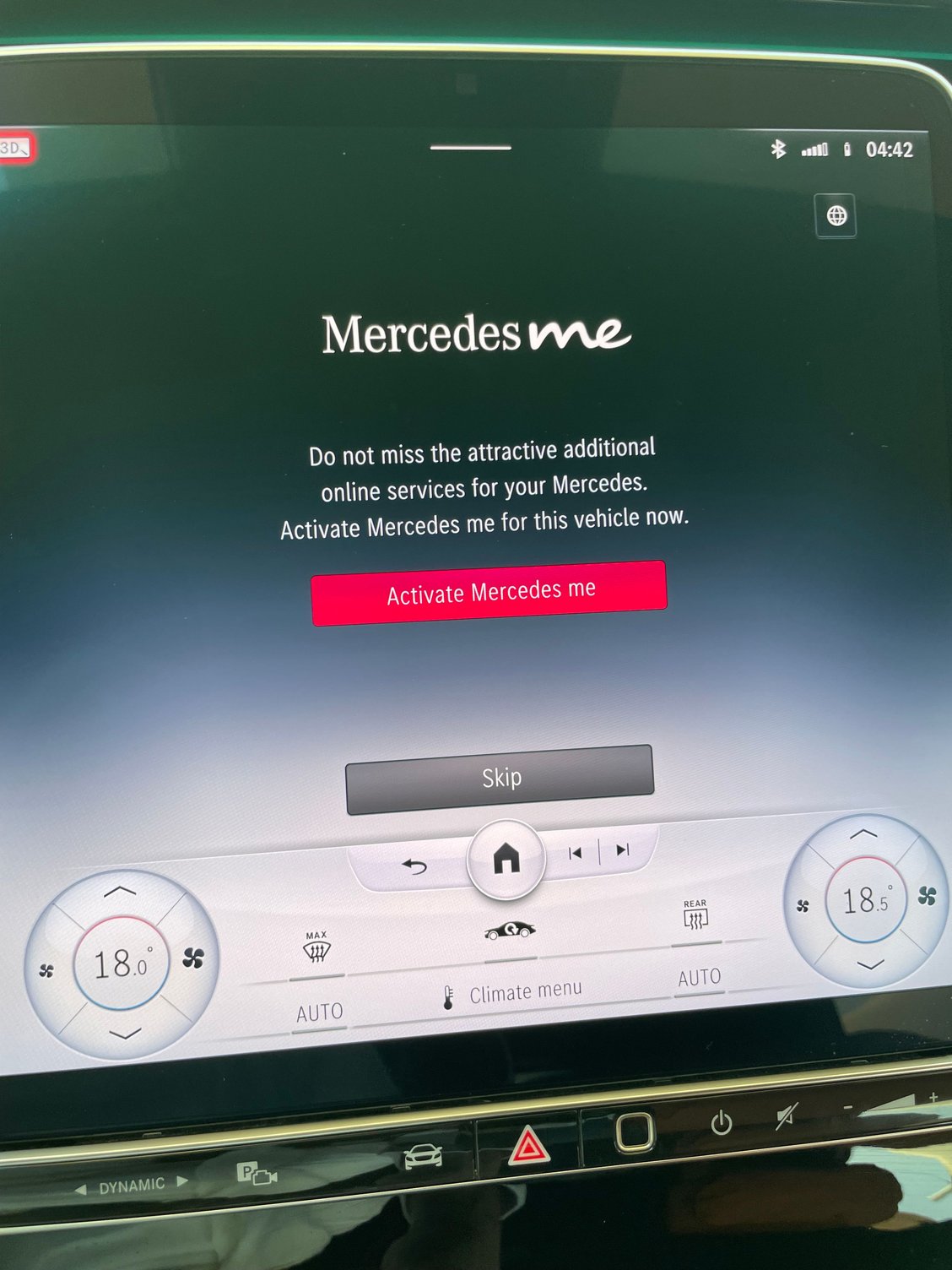

Hi, as some of you might know I have a W223 MY21 (December 2020 production). It's loaded with every option available at time of production except the rear cooling box (fridge?).
My issue is with Mercedes Me. When I start the car the Mercedes Me "splash screen" shows up. In my region (ME) it was not activated. Since I received my car in May 2021 I have been complaining to dealer and have received various excuses which keep changing with time (wild excuses which would make your head spin). The last excuse back in mid-2023 was region would be active in early 2024. I called dealer last week and latest excuse is my car is not doable and would have to buy/exchange for the new 2025 S class (facelift?) available later this year!!! Dealer says my car doesn't have the Mercedes Me HARDWARE.
I find this incredibly hard to believe. I'm almost positive my car has the hardware and probably just needs a software update and of course activation when available. I just need the proof to show him (other than the start up splash screen). Going through the options codes there isn't one specifically for Mercedes Me but I'm assuming because it comes standard.
Any thoughts/assistance would truly be appreciated.

As I previously mentioned, Mercedes Me will be offered in Saudi Arabia from MY2025.
Having said that, my issue is with my MY2021. As mentioned, I’ve had numerous discussions/arguments with local (sole!!) dealer. Bottom line is, dealer states when it is offered/activated in MY2025, they will activate it in my car IF the hardware is pre-installed. He doesn’t seem to be aware if or if not it is actually installed.
When I start my car I get the Mercedes Me splash screen asking me to “Activate Mercedes me.” See attached pic.
Isn’t that a tell-tale sign that it’s installed (but not active)?
For arguments sake, let’s assume the proper hardware isn’t currently installed in my car, its not retrofittable??

Thanks @superswiss for your valuable insight. I just reviewed my specs and noticed:
I previously assumed this just meant no telephone!!
So million dollar question is can it be retrofitted?

Ah, yours is a pandemic car. There was a shortage of the communication modules during the pandemic chip shortage, so many cars were built without it. Your car may be missing other modules as well. The chip shortages affected a bunch of features. Looks like your car was supposed to have it. Mercedes offered a retrofit for affected vehicles once the supply was available again and I know here in the USA affected owners were contacted and got the module installed. In your case since the module is currently effectively non-functional, MB isn't gonna spend the money to retrofit it. You might be able to get them to install it once Mercedes me is officially available in Saudi Arabia.

Yes, the SAK code. The module is technically retrofittable given that MB themselves retrofitted them on affected vehicles. You could contact some of the remote coders such as RJ Automotive to see if they offer it as a retrofit.

RJ Automotive ships worldwide and the coding is done remotely. They'll send you an adapter to connect to the OBD port of the car and your laptop and then they do the required coding from their end. You will have to install the hardware yourself, though, or find somebody who can install it for you.
MB isn't obligated to anything unless it's a safety related issue that resulted in a recall. This is all voluntary on their part.

OK, I was wrong again. The car does not have the communications module. The option code SAK is for this, never seen that code before.
PS. I cannot see why the module could not be retrofitted equally to many workshops now upgrade an existing 3G communications module to a 4G one. The activation of the module and the service is the issue.

Activation/service I’ll deal with later since dealer “promised” would do when available in country.
Now I just need all the part numbers/nomenclature required.
Thanks in advance!

Originally Posted by Sonic Boom
Does anyone know what SAK stands for? Might help me with dealer. I’m wishfully hoping it means was not installed due to shortage :-)
Thanks in advance!
I wonder if you ask the MY2021 GLC thread if their build sheets said SAK and if they received the Hermes module a year later when they came back in stock. I recall a decent amount of GLC owners not receiving Hermes, receiving a $300 credit because of the missing part, and then recieved a letter about a year later about Hermes availability and installation. Other alternatives to RJ Automotive for coding are @EleBest (Singapore) and BenzNinja.
Thanks in advance!
SAK is just an internal factory code denoting the deletion of the communication module. It doesn't have a particular meaning. It's just an option code. As said above, the deletion of these standard options during the pandemic due to parts shortages came accompanied by a credit against the MSRP of the car. Then later the affected owners were contacted that they can bring their car in to retrofit the module. However, the communication module deletion was the only deletion that had a later retrofit option. All other deletions that happened during the pandemic were permanent deletions.
