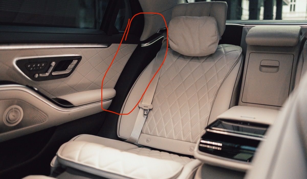

I purchased a new 2024 S500L a few weeks ago and it hasn’t been a good experience so far. From the moment I collected it, the car creaks and rattles over any sudden bump or pothole in the road.
The noises are coming from the rear of the car, and seem to be concentrated around the rear seats / doors. It’s hard to tell if it’s related to the door seals, the door latches, or door/seat trim. I should note that the sounds emanate from both sides of the car, in this same location. I’ve attached a photo showing where it sounds like the noises are coming from.
The fact that the sounds are the same on both sides of the car is particularly strange.
The car has the rear executive package so it has the rear bench seat but with individually adjustable left and right seats.
The dealer has so far tried a couple of very tame fixes, including padding out the trim on the rear parcel shelf, removing the headrests to rule them out as a cause, and greasing the rear suspension components.
These haven’t helped at all and the dealer is not keen on just guesswork and taking the interior apart (probably as if they break anything, Mercedes won’t pay for the repair/replacement of any damaged trim parts).
I have also tried thoroughly cleaning the rear door seals, without success.
Have other owners experienced creaks / rattles in this area and managed to source the cause?
https://cimg2.ibsrv.net/gimg/www.mbw...7461c686d.jpeg

Didn't hear a rattle in the marked spot reported on the W223 forums.

My 2024 does the same thing. It sounds like maybe it’s the seat recline mechanism? Planning on having the dealer look at it. Only happens on particularly sharp bumps.

Yeah it’s certainly coming from that area. Incidentally, I drove the dealer’s 2024 S class demonstrator a few days ago and it does the same thing. It’s definitely not normal, I’ve been in other older W223s and they were silent. Sounds like they’ve had a batch of bad parts.

Yes the sharp bump element is exactly my experience. A sunken drain cover, or a misaligned expansion joint on the road. Those kind of sudden height changes trigger it. Unfortunately my city's roads are covered in these kinds of defects, so the rattles are constant.

One idea I had was the rear power seat mechanisms themselves. Excess play in the motors or linkages. Guess I’ll find out soon.

That is what it sounds like to me, like its in the linkage of the rear seat control mechanisms...
