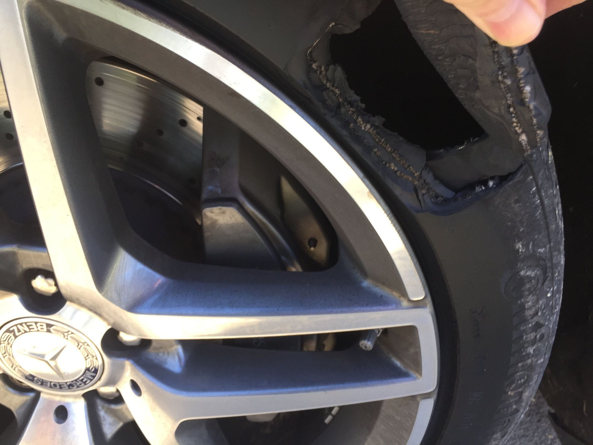

Oh it happens on 19's as well on the horrible roads in PA!
Here is one of many blowouts I have from the PA roads.
W222 19 Inch
W222 19 Inch
Originally Posted by DannyBoy1979
No it is the tires. The issue does not exist with 20 inch or 19 inch tires
