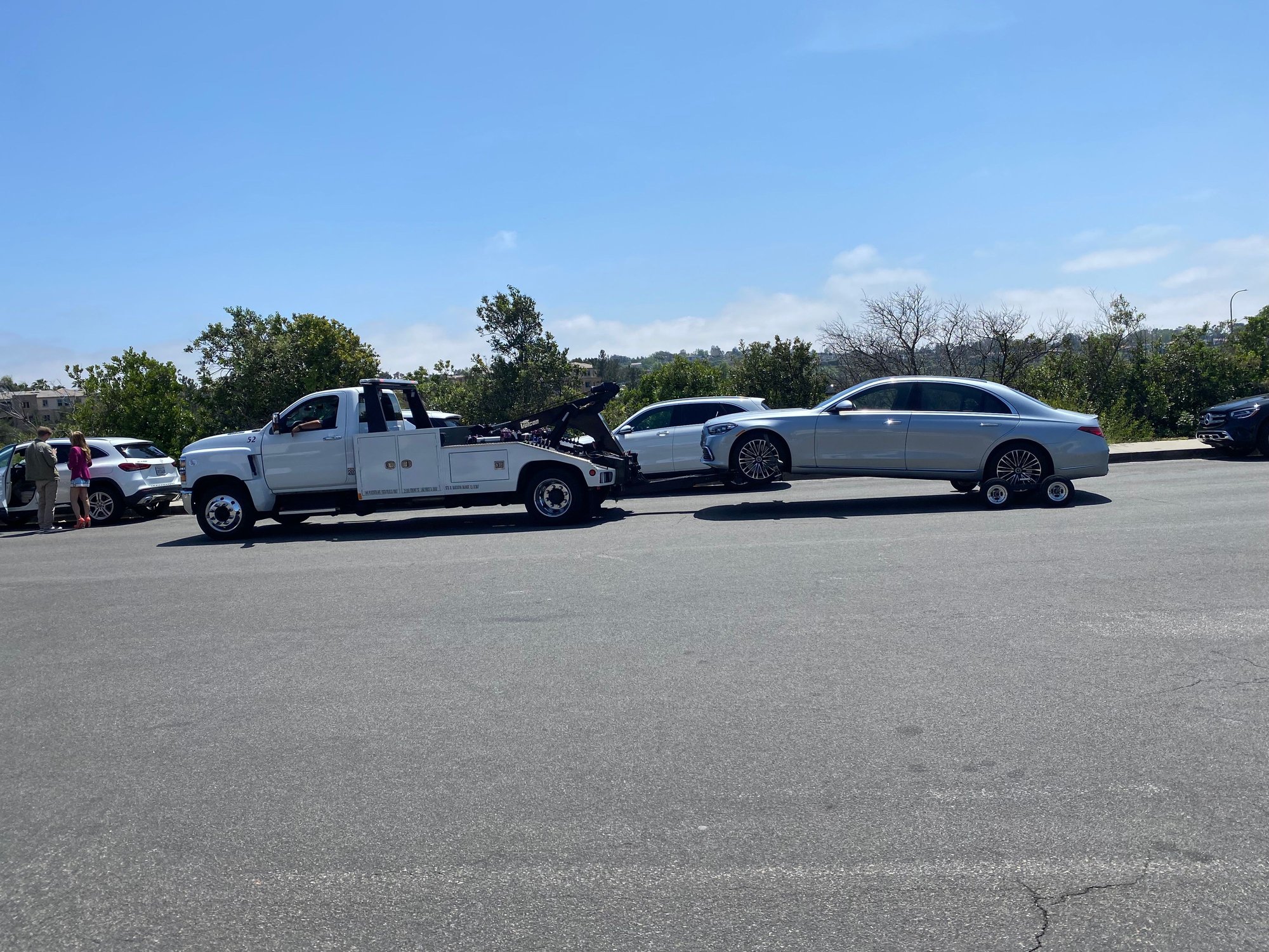

My dearly departed 2022 S580 being towed to the dealer—where it sat for 45 days—after shutting down in the middle of a very busy highway. MBUSA bought it back shortly after it was returned to me—thank goodness. Of the 60 brand new cars I had previously owned, it was “THE” worst one overall.
