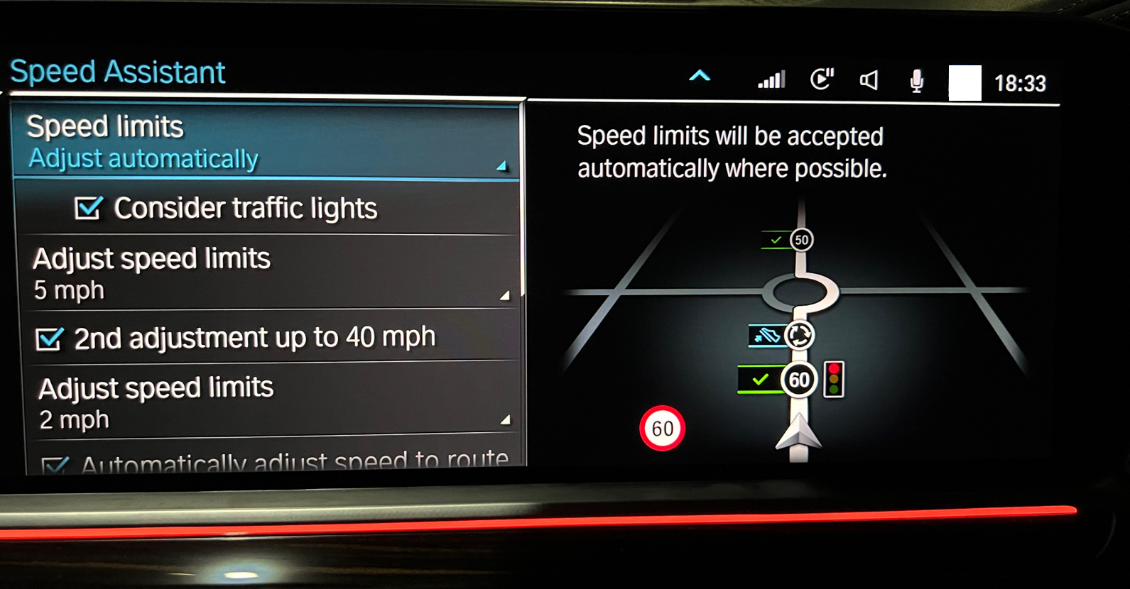

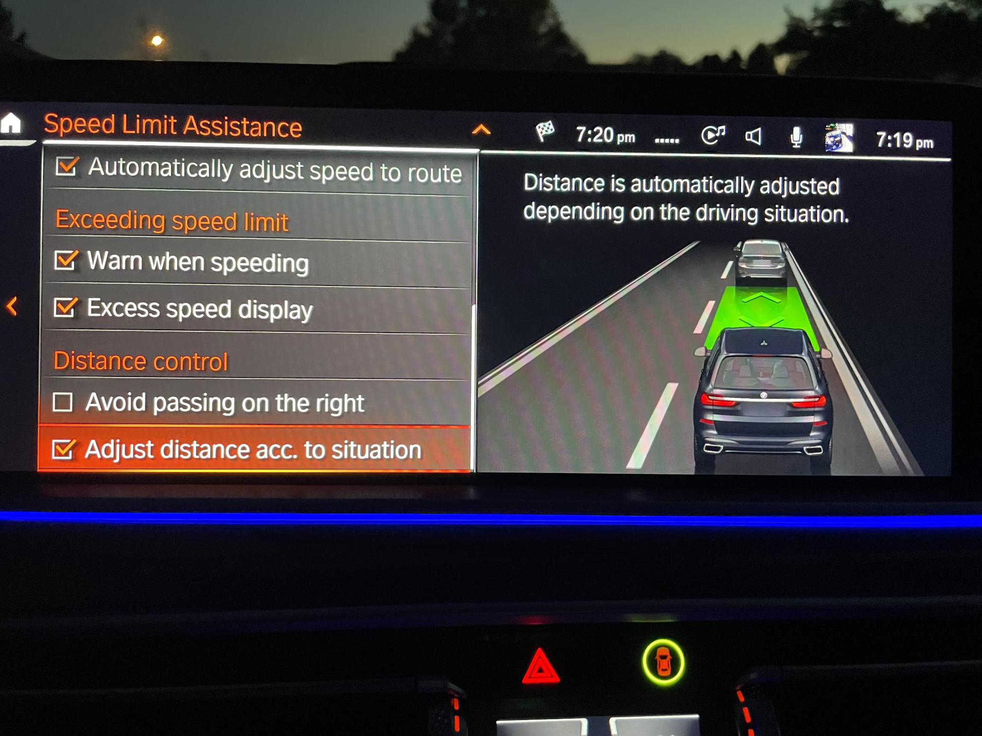

Yeah I am not sure what's going on with the speed buffer/offset. I know Tesla uses that (% buffer or absolute +/- value), but Mbenz never had it, and on the other hand, BMW removed it in recent software updates. They used to have it in all BMWs I had between 2019-2023 (2 speed adjust ranges/offsetts, one for lower and one for higher speeds), then sometime in 2023 all software updates blocked that feature and pushed it to a "hidden" menu here in the US. I had to code my cars to show that menu again in the cluster. I believe the software updates removed that only for US cars, but they were still developing the menu (including Stop sign and Traffic light response in europe which improved really over time since then and I was able to get that as well even on my iDrive-7 cars). I can still code it easily in 2025 and works well, and I set it for 5 MPH offset above 40MPH, and 4 MPH below 40MPH. As far as speed sign recognition, what's different between Mbenz and BMW is that the speed is adjusted in my BMW well below I arrive the speed sign (the car starts to reacts at a reasonable distance before I reach the speed sign which is what most humans do, wherein in my GLS and W222 it would only react by the time I passes right next to that speed sign and I admit it's annoying sometimes as it means I may be driving over-speed for a short distance right after the speed sign, so I wish they'd fix that in future OTAs. That got fixed a few years ago via OTA in BMWs, and when I had a Tesla, they also addressed it last year). I hear that W223 gets more serious upgrades/updates/improvements via OTA than the GLS, so hopefully Mbenz will address that instead of waiting for the facelift or new MBUX hardware release (I bet they're lazy enough to NOT fix it via OTA though).
Back to your point, yes, when I drive the GLS, I do miss that offset feature, but often it's just one additional click to increase the speed limit by another 5MPH. I still like that it sets the speed limit to the closest value (kinda better than having to do it all manually). Sometimes am fine with the exact speed limit at least in town. Also, when on highways, not that if you just poke the accelerator the same seconds it starts to slow down, it will ignore the speed limit change and stay where it is (I learned that recently). Kidna a kip feature until the next speed limit sign/change. It responds well around school signs too in-town. It doesn't work all the time, but it works most of the time, and with the accelerator trick I just mentioned, the skip feature is really convenient and even easier than using the steering button to re-adjust (it will just continue driving at the same previously set speed but the auto-change is still active for the next change). Never noticed that it slams the brakes on highways when the speed drops by 20 MPH. It seems to slow down cautiously but we may have baselines standards or driving/dynamic preferences for reactions on highways.
