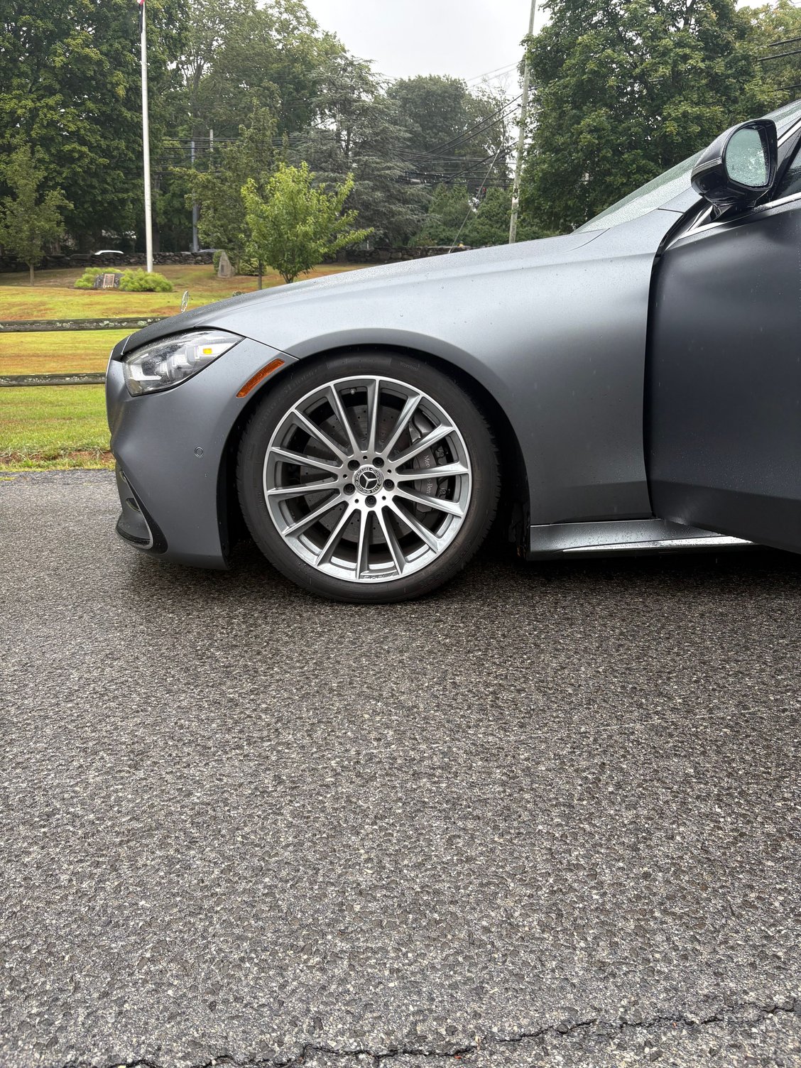

i had multiple instances recently dash messages stating either "suspension too low, stop car" or "suspension malfunction, do not exceed 50 mph".
repeated attempts by dealership didn't solve it. first they thought it was the height sensors near the front wheels - replaced them but didn't solve.
on one occasion thought it was fixed, but car would have the same problem intermittently.
if i tried to raise the suspension it would work... sometimes.
one time it i pulled over and found the front lip almost touching the ground... similar to the OP's comment.
see photo below.
then finally on the prior to last repair attempt i noticed the air lift was quite loud when i tried to lift.... almost a grinding sound. could definitely hear it from the exterior... and also notice from the interior.
sometimes it would make that noise when attempting to raise the suspension... but wouldn't raise at all!
finally they figured out the compressor went bad.
replaced.... no more messages, lifts without noises... so far.
3 attempts by these dealership idiots
see photo below.
It’s ridiculous that they couldn’t find the issue with the compressor after seeing the car in that state.
That’s slammed to the ground.
im glad they FINALLY figured it out.
