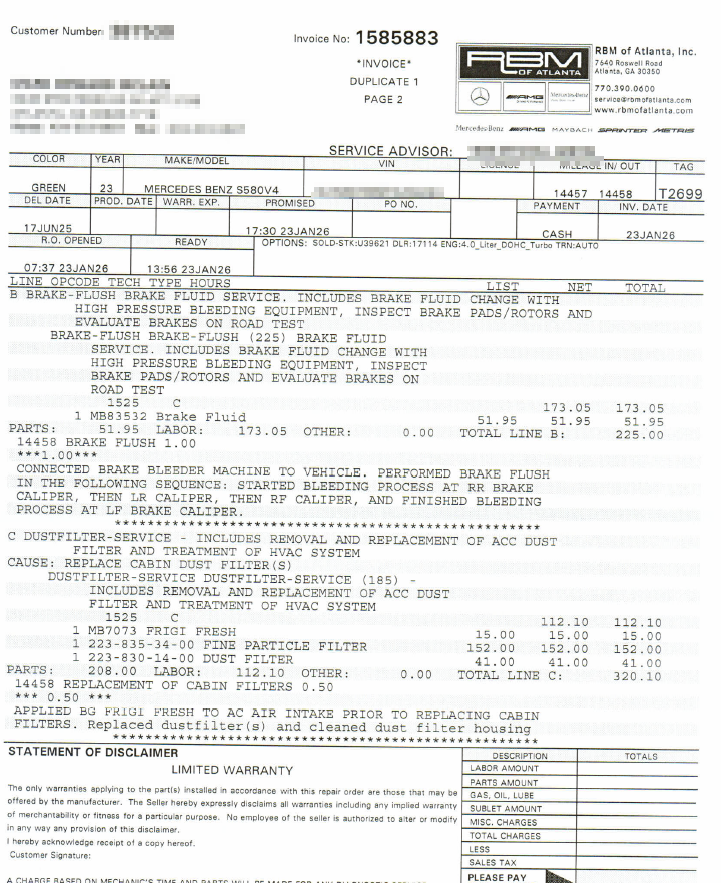

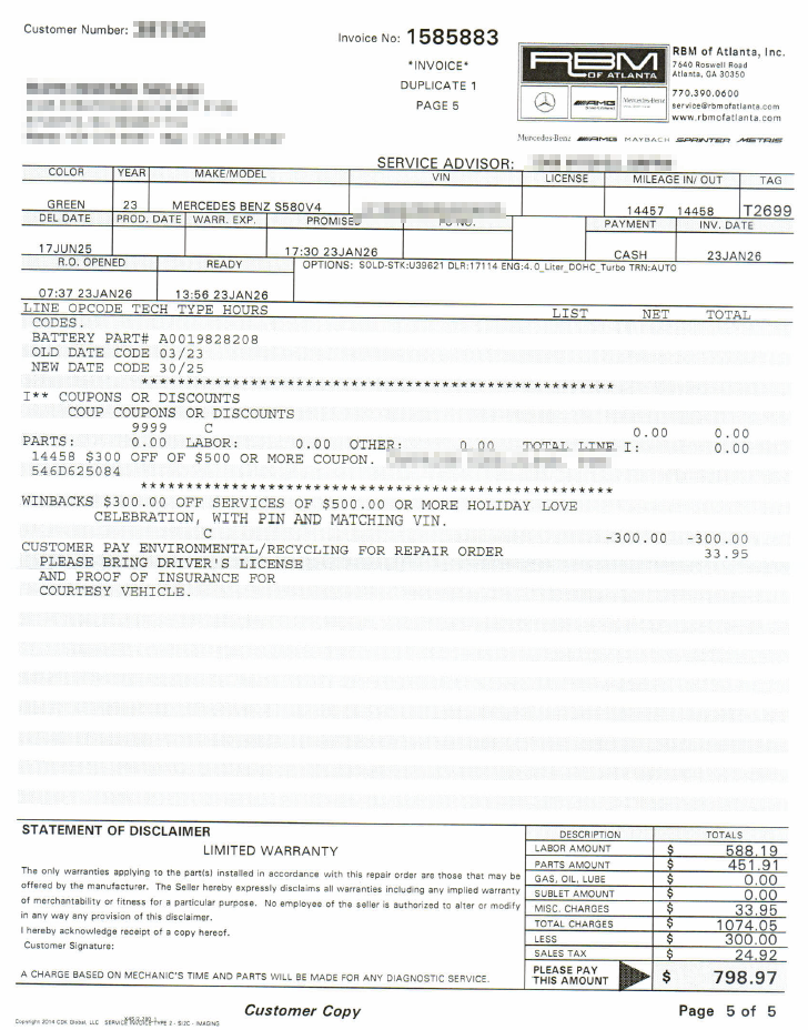

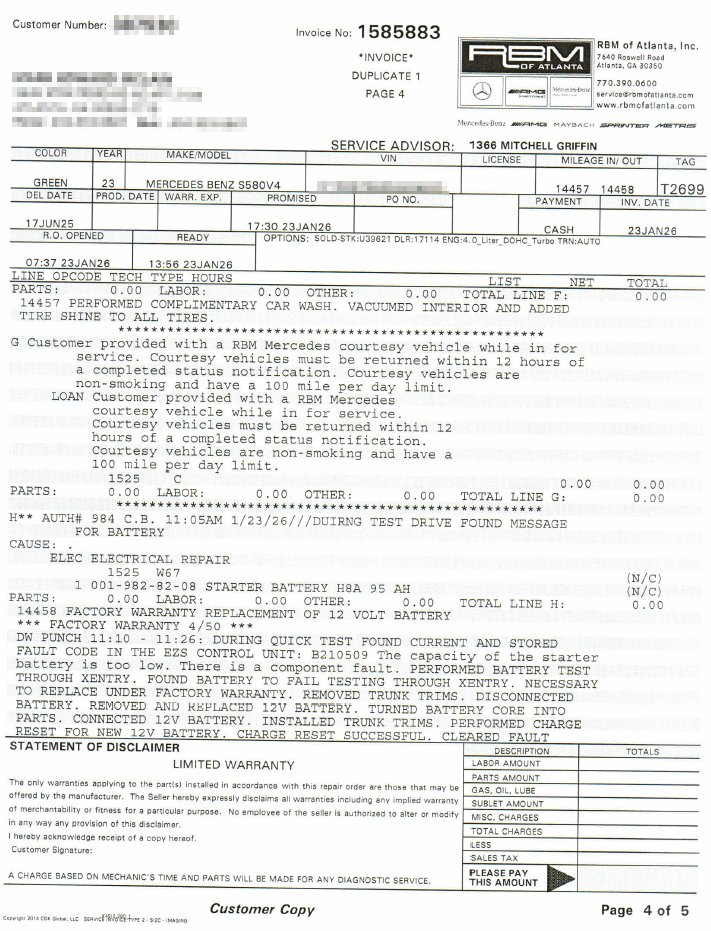

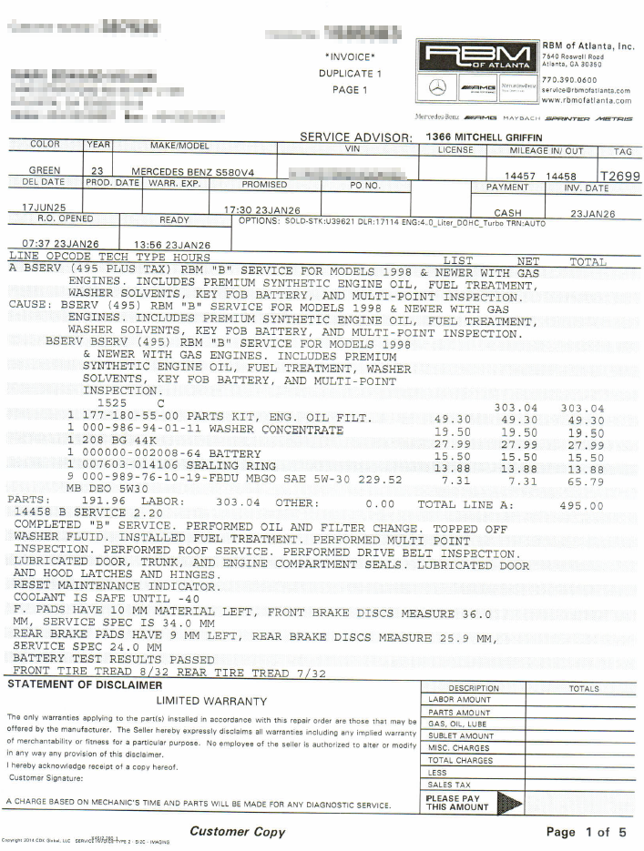

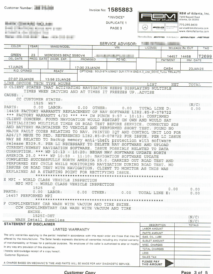

Just picked up my car after B Service with Brake Flush and Cabin Filters replacement. While reading through the final service report, I noticed they replaced the 12V battery under warranty. Total was $1,074.5 before a $300 off coupon I had. So, 798.97 out the door. Also, I had them check for the activating navigation issue I was having. They reinstalled navigation software to fix. Interesting read as to why they thought it went haywire.
Great that they replaced the 12V battery. Common issue on these.

Wanted to close the loop on the issue I had with Activating Navigation.
I thought it had fixed itself earlier last week; it didn't. I had RBM check on it while it was in for its B Service, they thought they had fixed it, but they didn't. To be fair, they did say it was a shot in the dark on the updates they applied. Because I work in IT, I know sometimes a Hard Reset on electronics can sometimes fix all kinds of issues, so that's what I did yesterday. I unpaired/removed the car from the Mercedes app, then did a Hard Reset of MBUX, then repaired my car to the app. Issue hasn't occurred since. Let's hope that fixes it for good.

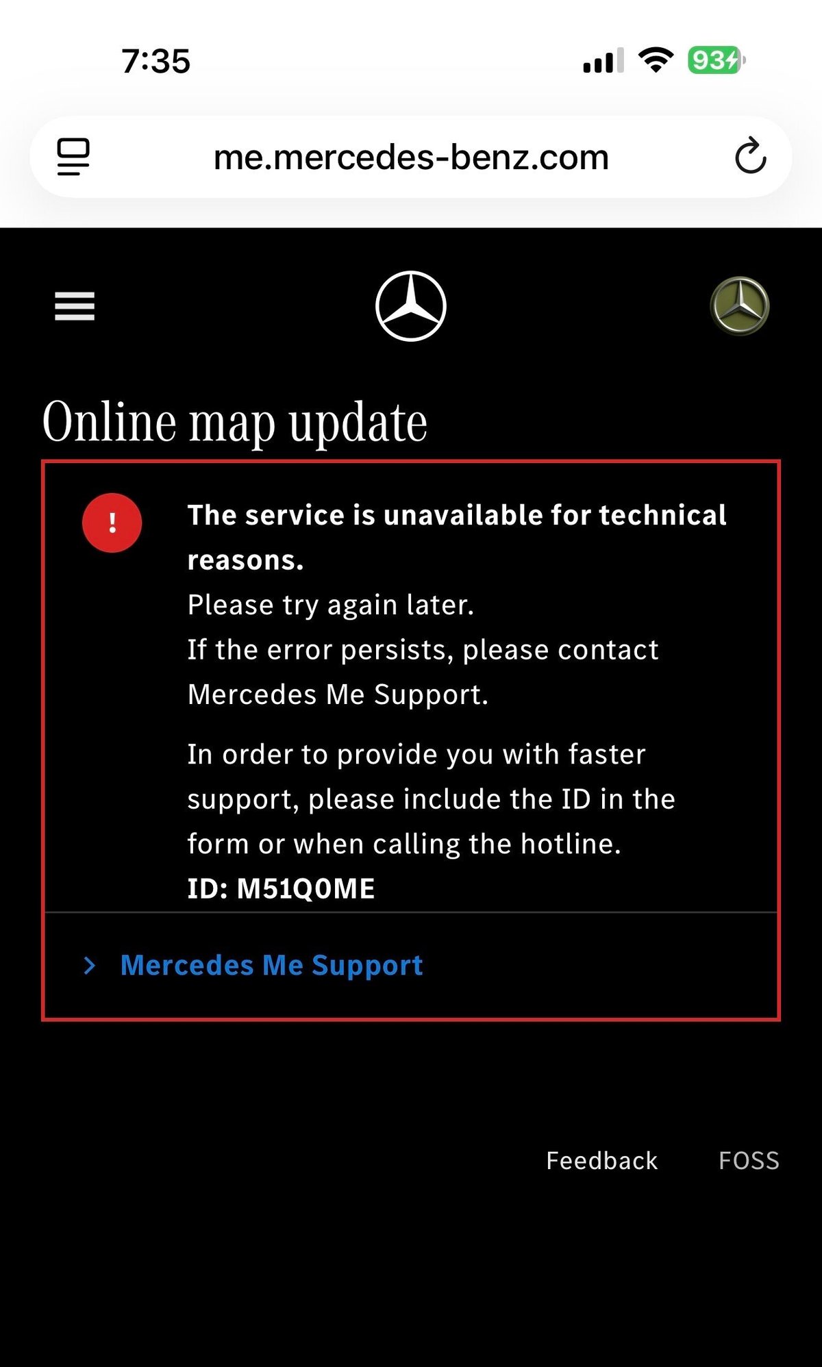

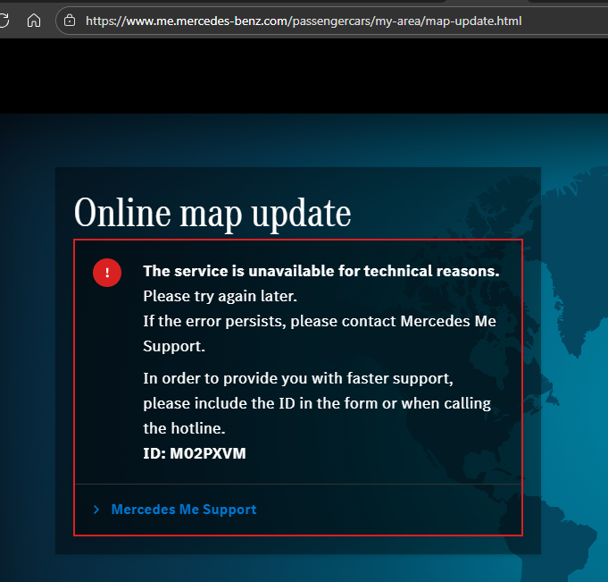

I thought this was a done deal, and all was fixed with my steps above - well, not so fast. While the steps I did above were successful in stopping the repeated Activating Navigation issue, now I have a different one. I'm fairly certain this is a result of the navigation updates my dealer did trying to fix the issue. Now, when trying to update my navigation maps through the Mercedes website, I get the following error. I've opened a case with MBUSA, but hopes are low they will fix.
Have any of you got this error when attempting to update your maps manually?
This is the error code I get when using Edge browser from my PC - M02PXVM
And when attempting from my iPhone using Safari - M51Q0ME
My fear is whatever this error is will prevent future over-the-air updates to my car, let along navigation update.
A quick Google search shows this MBWorld post in another forum - Manual map update - (NO_VIN) error - MBWorld.org Forums

Never seen that!

Closing the loop on this once more.
I contacted my service advisor at RBM and asked them to Reset the timer for the Mercedes-me backend / Digital Extras provisioning module. To cover more bases, I also contacted the Digital Extras department at MBUSA and asked them to find the root cause of the issue mentioned in the error message noted in my previous post. They took my info, but confidence was low they would actually do anything. After consulting with ChatGPT, it suggested I call again and ask that my case be escalated to their Tier 2 team. I did and they escalated. This morning at about 7:30, all seems to be back to normal. What I don't know is if my dealer's efforts, the Digital Extras Team at MBUSA's efforts, or a combination of both fixed it, but it IS fixed.
By the way, I know my dealer updated the entire North American maps, so this is the first time I've seen the entire map for Canada, US, Mexico are "Up to date".
Also, I want to give my fellow Georgian Daniel @nearwater4me a shout out as I had pestered him a couple of times over the past couple of days to try it on his end to ensure it was not a system issue, but something specific to me. So, thank you again Daniel.
